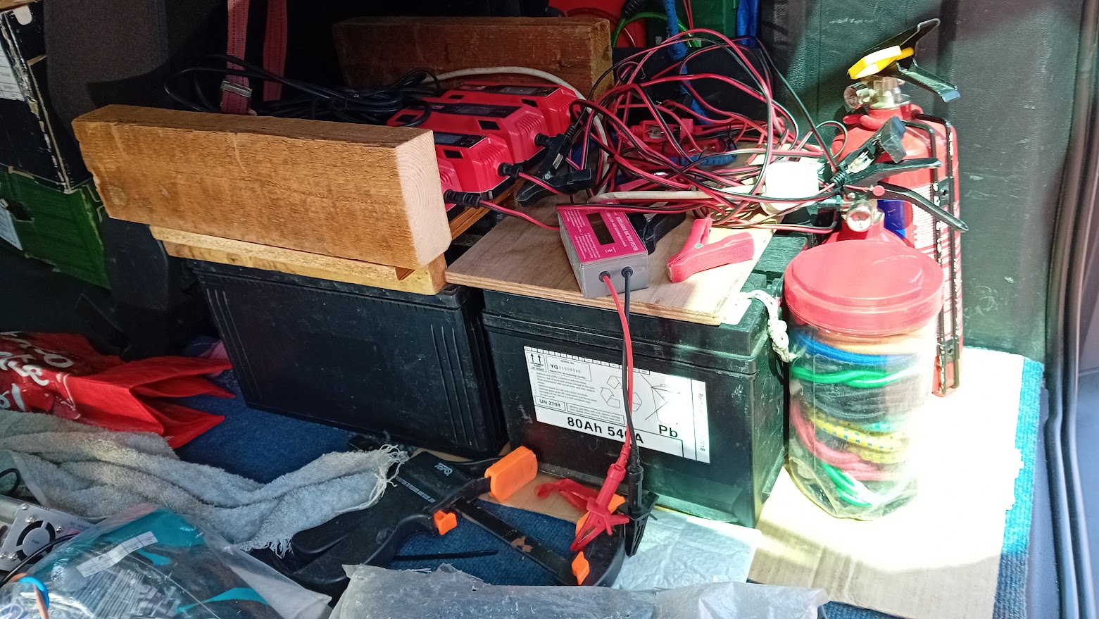

I use LA batteries for portable public address and radios uses. Initially standard car batteries as we had an unused second hand source. (I had 16 95Ah at one time). When that source dried up I started buying leisure batteries 2 80Ah followed by 2 115Ah have kept me going for around a decade. Initially I only used 6 cheap simple chargers (which took a fair amount of planning during the summer months). I have always used an ACT battery tester which indicates the state of charge with an Ah reading... very misleading results but useful as a guide. I currently leave those 4 batteries on permanent charge with LIDL 'smart' chargers but I'm not convinced they keep the batteries in ideal condition. The batteries current ly return condition as 30-40Ah but in reality I occasionally a pair of 10W LED floodlights overnight for camping on a dusk to dawn sensor and a battery will run for a full week. (I guess around7-8 hours per night for 8 nights so around 84Ah but bear in mind the LEDs will happily run at sub 12V levels).
Recently 2 of the batteries have shown as 'volts too low' and appear to be 5 cells using DMM but a quick 1hr charge with a basic charger brings it up enough for the smart charger to take over again.
Historically I used to use 200W of lights (4xMR16 50W) and monitor the voltage every 15 minutes until reaching 12V which was usually around 4-6 hrs (~32-40Ah) but I haven't done that for years... perhaps I should start again?

.... Historically I used to use 200W of lights (4xMR16 50W) and monitor the voltage every 15 minutes until reaching 12V which was usually around 4-6 hrs (~32-40Ah) but I haven't done that for years... perhaps I should start again?
Maybe you should - and it would be far from beyond the wit of man (or you, Sunray or myself) to 'automate' that (precluding need for looking every 15 mins), such that the time taken for the voltage to fall to 12V (or whatever) was recorded.
