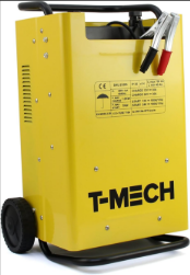

In my case, I am using my charger, as the firms charger is a large unwieldy thing, 1747831774603.png of this design, not the one shown, but taking it up/down steps is not easy. So my little Lidi charger, is far easier to carry, and once set, often a week before I look at it again.

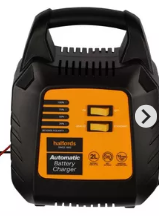

I note
for the same battery charger
one does question if fully automatic why 1747840551769.png and not cheap, at £38 for a 5.6 amp battery charger, which states it has a sealed mode! It seems Halfords don't have a clue about what they are selling. The do this one for £30
so why would anyone buy this 1747841300158.png load of rubbish?
