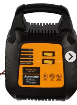

why would anyone buy this View attachment 382134 load of rubbish?
Because that's what they've always bought and they don't trust the new fangled ones? Particularly if they once tried a 'smart' one on a dead or not-alive-enough battery.
