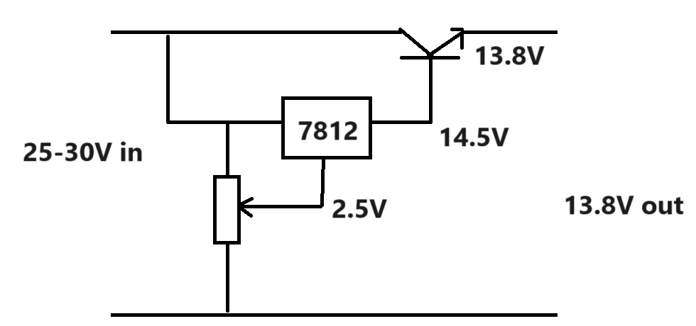

There were 2 amp versions of the 7812, they were the main way that CB power supplies regulated their output, around 1.2 volt across a red LED so put one between the 7812 common and real common, and you got 13.2 volt approx.
But as said it did not work, the extra 0.6 volt drop or so was simply too much.
