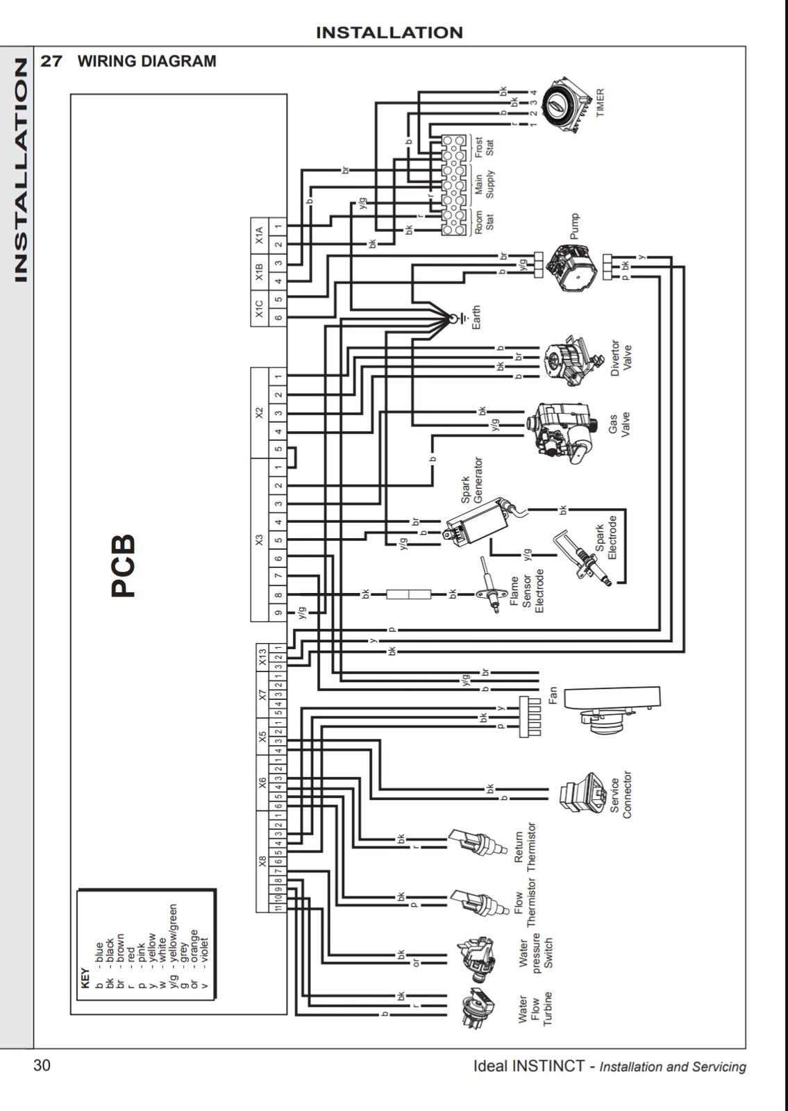

I can update that I picked up a second hand boiler which had a good heat exchanger and my friend has since swapped this over. However I am now looking into opentherm. My boiler is a instinct 24 which has the weather compensation option which can be wired onto the X7 connector on the mainboard but I can't find anything about opentherm. Ideal are not willing to help me as I am not gas safe registered but as I pointed out to them the combustion side of things is totally separate from the electrical side.
Entry level Ideal, based on the Logic+
It is an OT enabled boiler - Get you chap to check the installation manual - all explained in there. Though if it is a normal Ideal Instinct then Weather Comp isn't on X7.
Bet that went down well with them.
Ideal won't have told you anything as they wouldn't sanction anyone that isn't GSR to be in behind the room sealed case without being able to test it afterwards. Obviously that would include any wiring required.
The instinct doesn't say anything about opentherm in the manual, however the instinct 2 does. Looking at them their are almost the same. Ideal have agreed to help me with the part number for the part I need for the loom/weather compensation.
