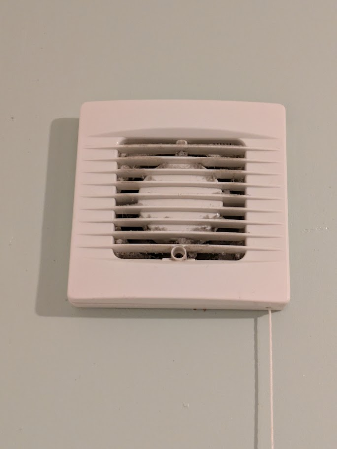

Fan packed up, it's only about 6 years old. Was a pull cord on/off, and often left on for hours at a time.
Looking for maybe pull cord with timer, or humidity (but sure I read here that humidity controlled ones are unreliable?)
whats the make of the fan you have now - maybe a photo of it

I'll have a look when I get home. Could not find any order details in emails, so guessing I just picked it up from a local merchant, B&Q, Wickes, Toolstation etc. It started to get a bit noisy, but then just totally stopped working.

I think its a Monrose based on the photo

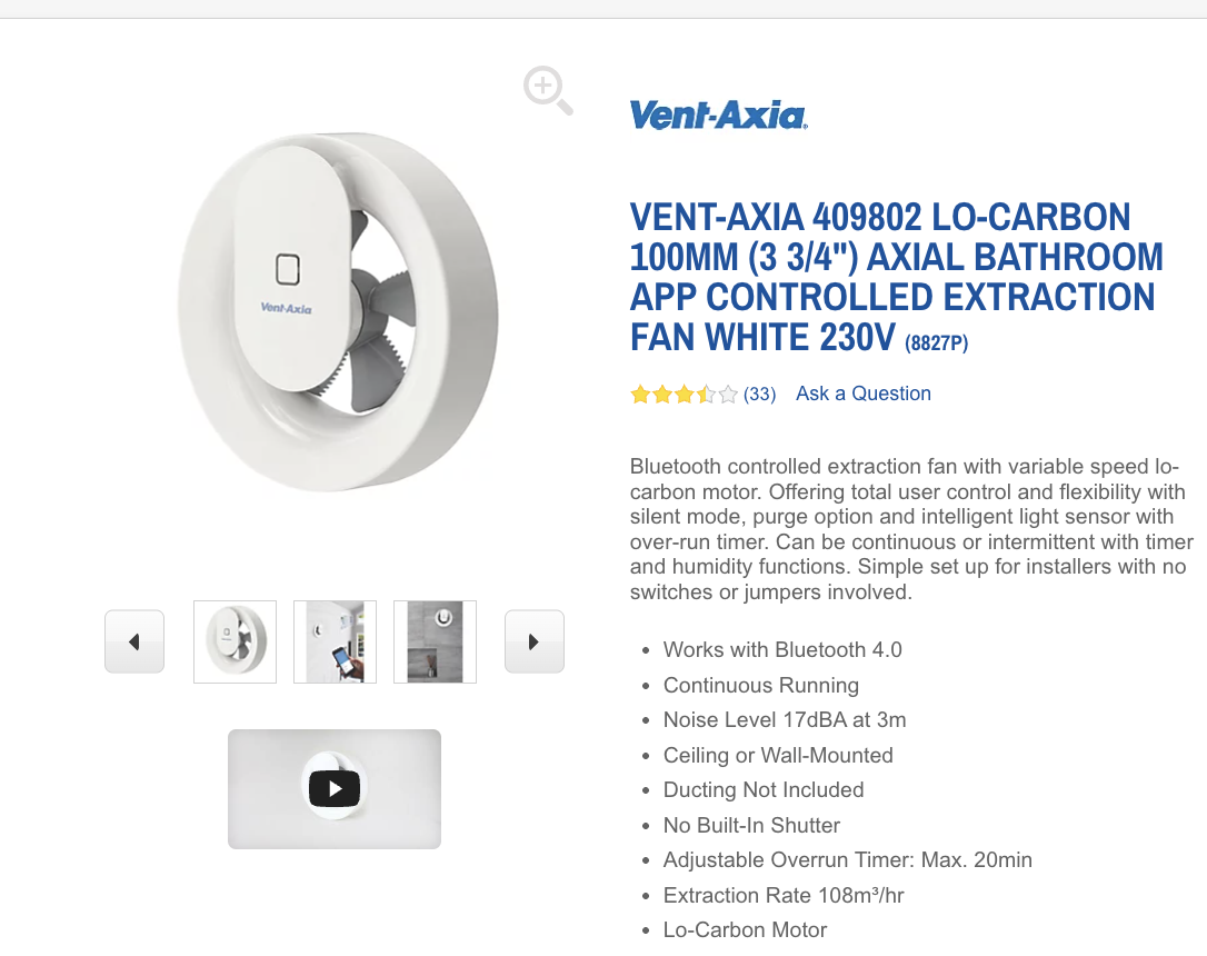

Suggest you get a Vent Axia Svara fan. Just needs power (which you have). It has a motion detector, can be continuous or intermittent with timer and humidity functions. All set up is via bluetooth & smartphone app. They are just brilliant IMO.
Screwfix and others sell them. About £120, but you get what you pay for.
