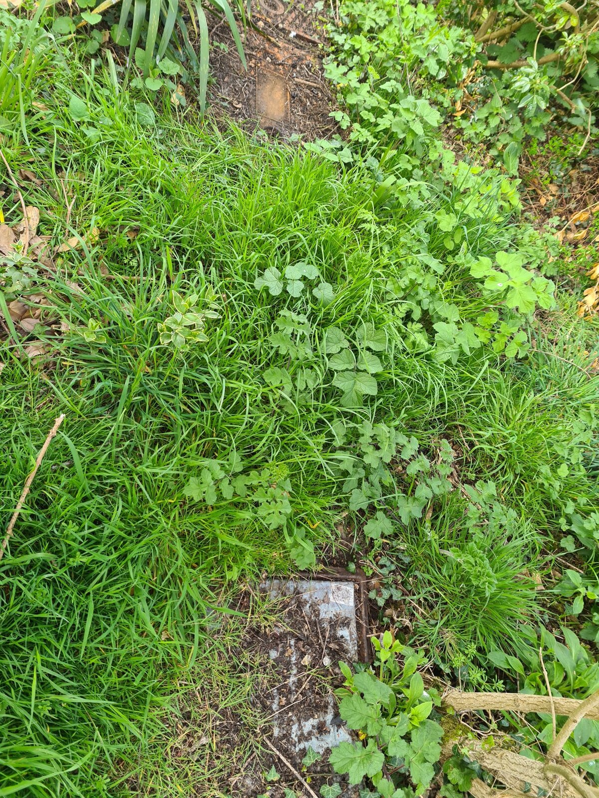

I can see 3 lids, 2 close lids and one 1m before that

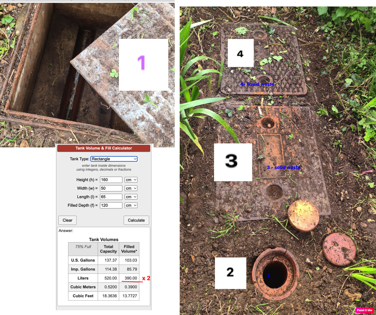

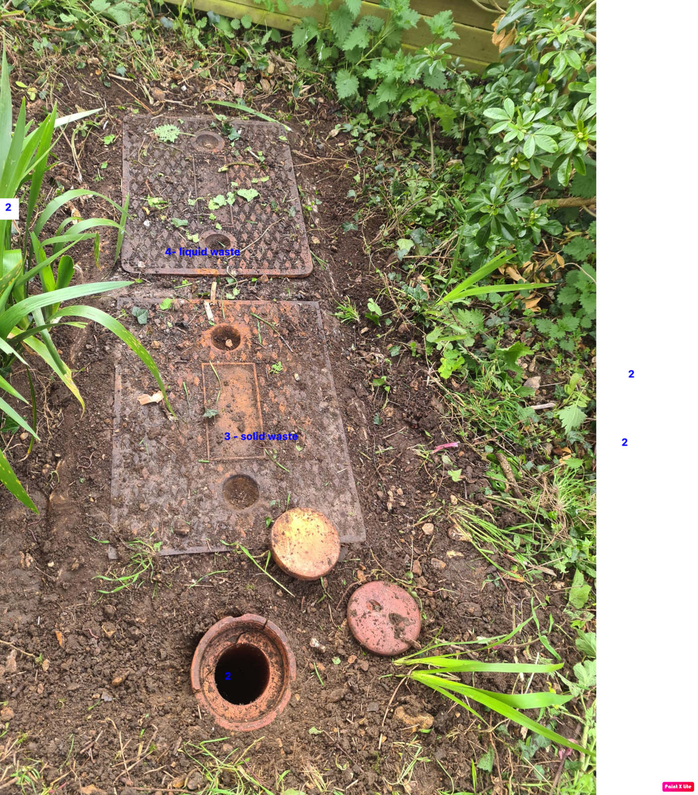

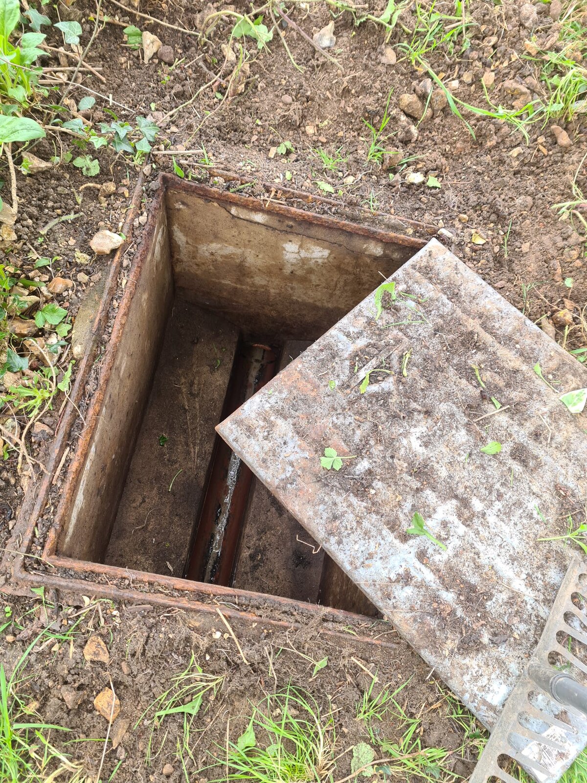

After clearing all the weed around the lids I have following findings..
1. There are 4 lids/chambers for this septic tank system (not 3!)
2. First lid seems to be an inspection chamber sort as shown in first Image below. Water just flows via this.I can't see any difficulty in water flow, I suppose thats a good sign..?
3. Between chamber 2 above and actual septic tank there is small round hole may be 15cm diameter. see 2nd Image below. This is made of red brick (clay) material. I measured depth using stick into this only. I can say no smell I could get when I opened this chamber and can see some water down.

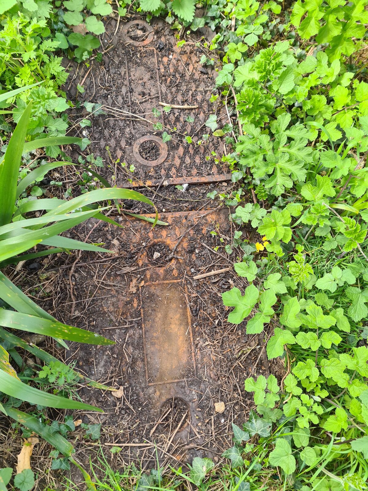

4. 3 & 4 lids covers side by side equal sized chambers paved with bricks. chamber 3 got solid waste and still didn't smell anything!! I didn't had courage to put a stick in this
5. Chamber 4 is same size as 3 but this got cloudy water in it, no solid waste
6. Both above chambers are 60% filled I think
7. when emptying waste is that done on solid chamber waste only..? or liquid chamber as well?

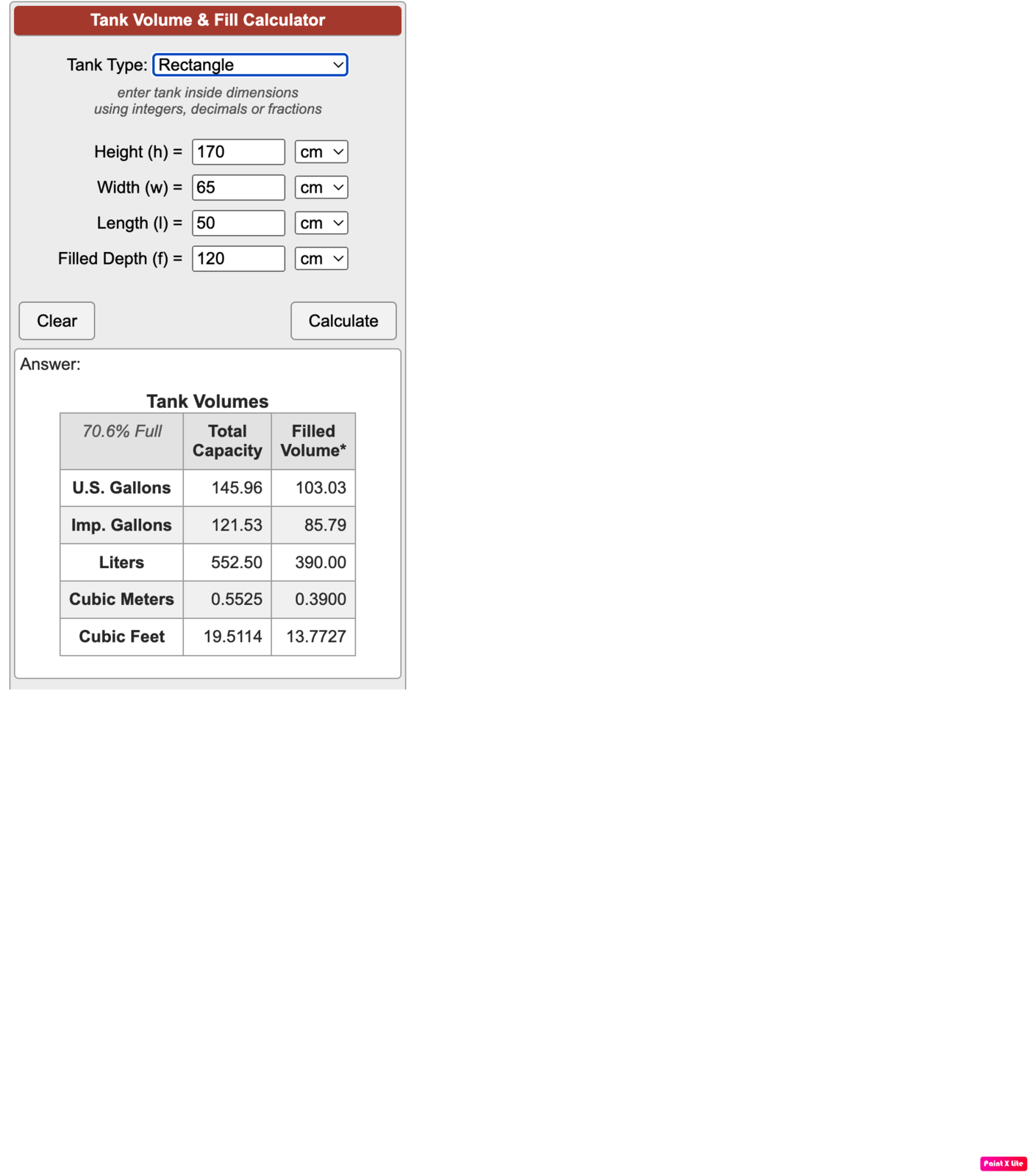

8. Solid chamber volume seems to be as shown in last image, but its not in 1000's of gallon as the companies were asking me..? Is this volume calculation wrong?

Are you just giving the inspection cover size , the actual chambers extend well beyond these
If you get a metal rod, prod it into the ground working out from the covers in all directions you may be able to find the external size when the rod hits softer ground.

Lets determine first if the first pic is the tank inlet...flush the loo, empty a bath or whatever and watch where the flow starts.
The inlet allows soil into the first, solids tank, initially and then this decants into the next one which is liquids - and any other escaping solids. This done, the tank then sends liquid to outfall which is yet another chamber, making 4 in all.
The salt glaze vertical pipe may be a vent, rodding point or the top of a 'dip pipe' that allows waste from one tank into the other.
Can you give us a pic of the 4th chamber please?
I must say, things are looking good here but we'd like to see the outlet as well as the inlet - both should be dry when the tank is resting.
When pumping out, both the chambers are emptied.
Your formula looks about right so long as your measurements are!

After further investigations I can confirm..
1 - is tank inlet and flushed tank and saw water coming out flowing without any blocks, so tank still have capacity.
2 - Still not cleat what is this and use of it, I managed pull out tissue from there and depth wise its same as septic tank but nothing solid in this
3- Solid tank, I managed to put stick there and measure depth more accurately to 120cm filled with 40cm empty
4. Liquid waste same size as (3)
Updated volume calculation looks to be around 800 L (solid + liquid). If completely liquid emptied from tank any issues with soak away?
"The salt glaze vertical pipe may be a vent, rodding point or the top of a 'dip pipe' that allows waste from one tank into the other." -->> assuming this is about (2) as you can see this is not between solid and liquid septic tanks..
Can you give us a pic of the 4th chamber please? -->
>3 & 4 are exactly same size one got solid waste and other liquid waste.
Are you just giving the inspection cover size, the actual chambers extend well beyond these -->> I am not, but tank width and length are nearly same as that of lid
