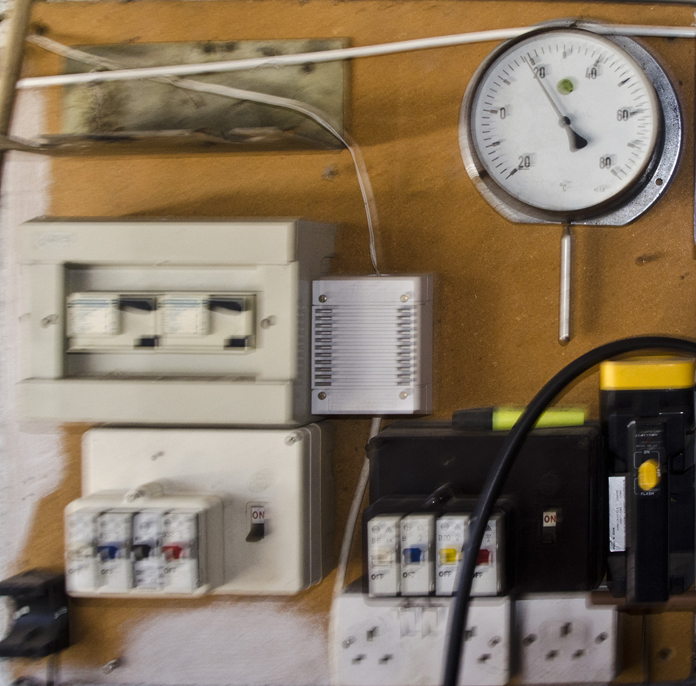

I had in the old house some old fuse boxes, Wilex-board-with-RCD.jpg two RCD's in an adaptable box fed two Wylex fuse boxes where the fuses had been swapped to MCB's, it was fitted early 90's before consumer units came out, and I would every so often get a run of trips, and resetting one RCD could cause other one to trip, and often could not reset without turning off the MCB's.
I tested many times with my insulation tester VC60B.jpgand never did find a fault, it would then after tripping maybe 4 times in two weeks, run for 2 years without tripping. I blamed spikes on the supply, but never did find out what was wrong. The RCD's were likely from late 80's with no electronics, and were 4 module wide.
Today I can test leakage
it shows my whole consumer unit is leaking 8 mA, and this is spread across 14 RCBO's so I have only had a RCBO trip when the roof leaked, which is what it should do. I was happy to spend the extra and have all RCBO's so I did not get a repeat of problems with old house.
But the problems with the old house were due to having done it on the cheap, I should have ripped out the old fuse boxes and fitted a proper consumer unit, and the whole lot was well past its best by date. Had I owned the meter shown Diffrence line neutral 8 Feb 24 reduced.jpg in the old house I may have found the problem, but trial and error is not the way to cure problems.

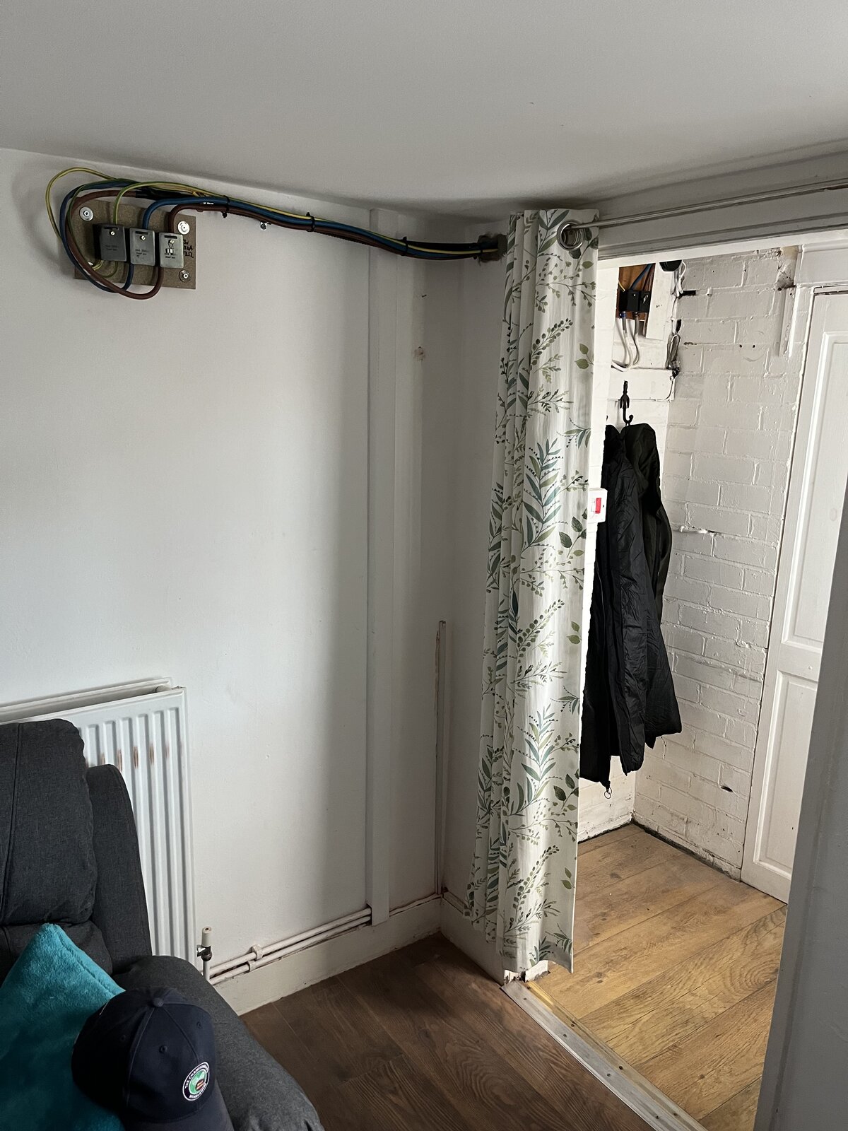

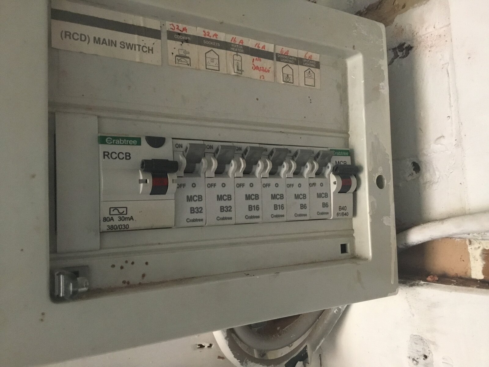

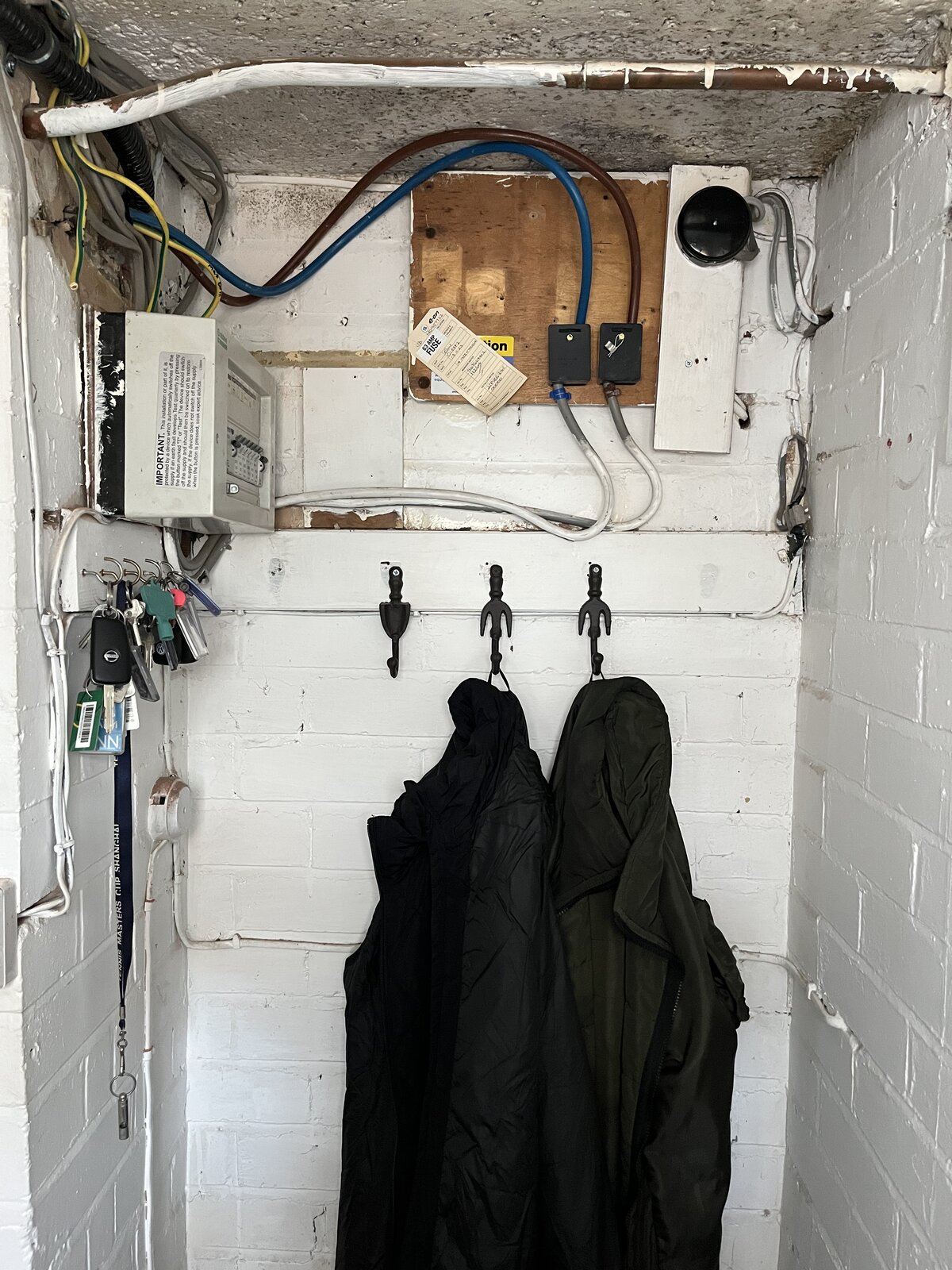

Ok here’s some pics:
consumer unit

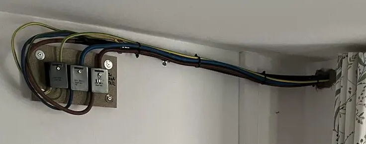

Then this is the wiring alongside:
And then this is what they did when we asked for a “tail” to be left to allow the movement of the consumer unit into the adjoining room..
What does the newer 40A breaker on the right do?
Updating the CU would make some sense, because at the moment if the main switch/rcd trips they lose everything. Modern units with RCBOs means that in the case of most faults only 1 circuit would trip
Not sure why you have this 1708099535979.png but it is likely the length of the neutral tail why this problem has shown its self. Likely there has always been a small problem, but length of cable has made it worse.
But real problem is whole house on one type AC 30 mA RCD. Yes we have caravans and narrow boats on one RCD, but they are smaller than a house, and do have 12 volt lighting. Not got the up to date version of the regulations, but it has said the supply should be divided into circuits to
(iii) take account of danger that may arise from the failure of a single circuit such as a lighting circuit
(iv) reduce the possibility of unwanted tripping of RCDs due to excessive protective conductor currents produced by equipment in normal operation
for years, we may have got away with it when using 100 mA RCD's but with 30 mA it is asking for problems.
I would guess there is a neutral to earth fault, easy for me to find, I have the tools, but for the normal house holder we would tell them to move items around between the two or more RCD's to try to work out what is causing the trip, but with only one RCD that is not possible.
Best answer is a new consumer unit with all RCBO's, but clearly there is a cost, so unless they can afford the change, then need to find the earth leakage, need to find it anyway really, but it will need a tool of some sort to find it. In the mean time, all one can do is unplug anything not in use.
I do not understand why this 1708099535979.png has been done? It just seems some one has too many henley blocks and wanted to use some up. And yet not an isolator in sight.
Wait for more replies, as I would not put up with a job like that.
I would hazard a guess, that it's an accumulation of leakages, tripping the RCD, and that it has always been a problem - except it has gone unnoticed because their has never been a need for the supply to be turned off before. Turning them back on, one at a time, simply works around the tripping issue.
All the OP can do is tollerate the problem, or install a new consumer unit, supporting individual RCBO's for each circuit. None of which is the DNO's problem. I do agree there ought to have been an isolator installed on those tails, but they have been over-generous in running those tails in readiness for a new, repositioned consumer unit.
