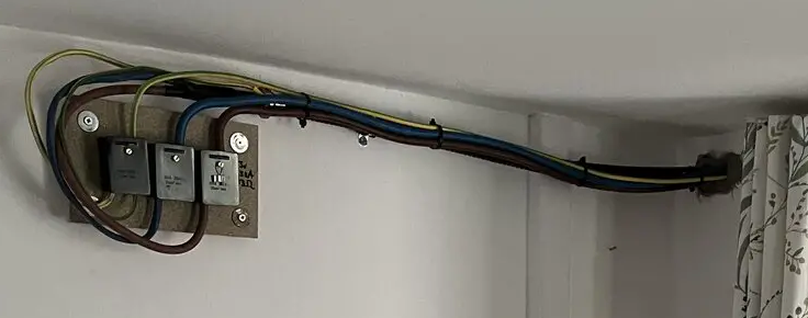

Not sure why you have this View attachment 333212 but it is likely the length of the neutral tail why this problem has shown its self. Likely there has always been a small problem, but length of cable has made it worse.
But real problem is whole house on one type AC 30 mA RCD. Yes we have caravans and narrow boats on one RCD, but they are smaller than a house, and do have 12 volt lighting. Not got the up to date version of the regulations, but it has said the supply should be divided into circuits to for years, we may have got away with it when using 100 mA RCD's but with 30 mA it is asking for problems.
I would guess there is a neutral to earth fault, easy for me to find, I have the tools, but for the normal house holder we would tell them to move items around between the two or more RCD's to try to work out what is causing the trip, but with only one RCD that is not possible.
Best answer is a new consumer unit with all RCBO's, but clearly there is a cost, so unless they can afford the change, then need to find the earth leakage, need to find it anyway really, but it will need a tool of some sort to find it. In the mean time, all one can do is unplug anything not in use.
I do not understand why this View attachment 333212 has been done? It just seems some one has too many henley blocks and wanted to use some up. And yet not an isolator in sight.

There will (almost) certainly be an isolator switch in the external big white box along with the DNO cutout fuse and smart meter. They fit them as a matter of routine nowadays to isolate the supply from meter to Consumer Unit(s) --- i.e. those tails going to the new location and from there to the existing CU, via henley blocks.
Take a pic, if unsure, inside that white meter cabinet for people here to confirm.
