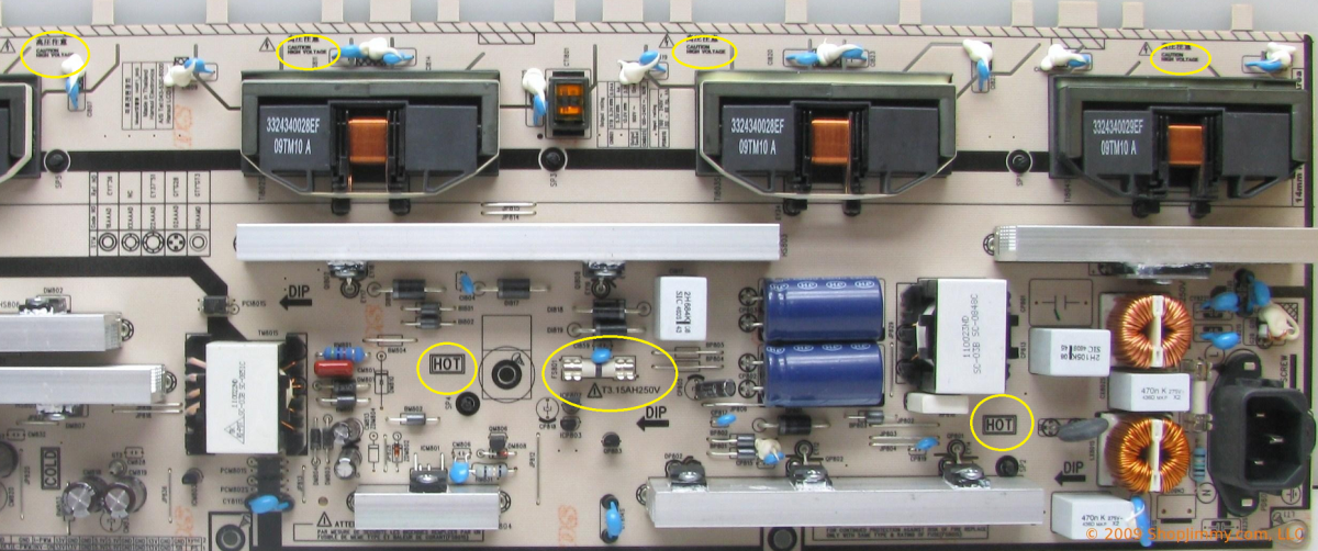

Plasma TVs are packed with dangerous voltages, just recently I threw a Y SUS board across the room when it gave me a belt as I didn't discharge it fully.
The larger TVs have fairly hefty PSUs with often large areas of primary circuitry.
I repaired one the other day which had a non isolated heatsink which is quite unusual now.
