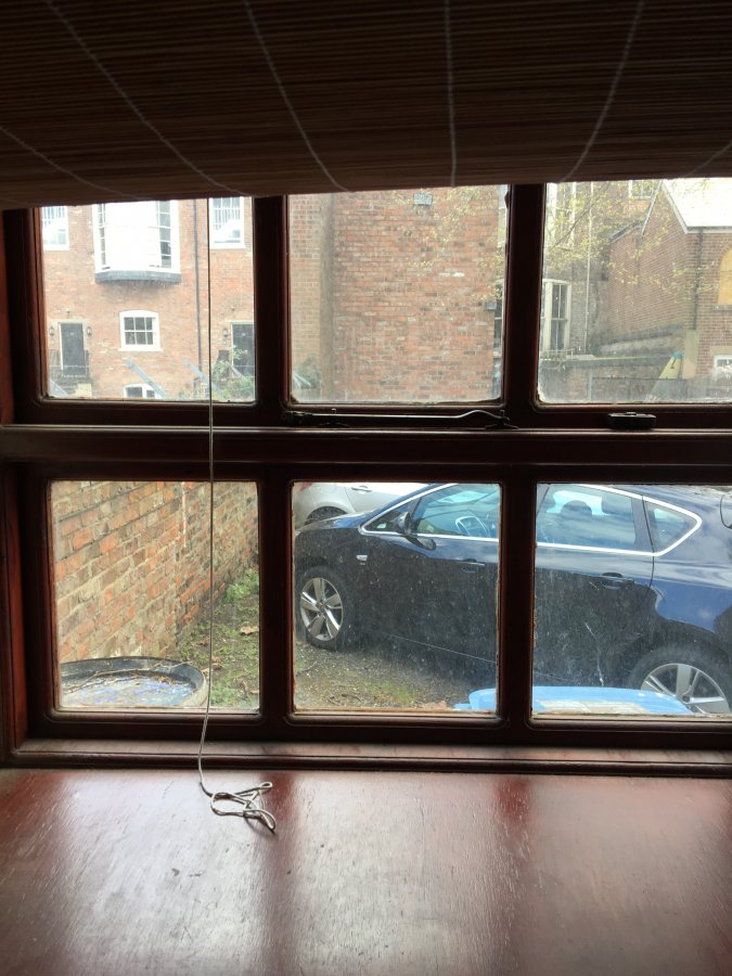

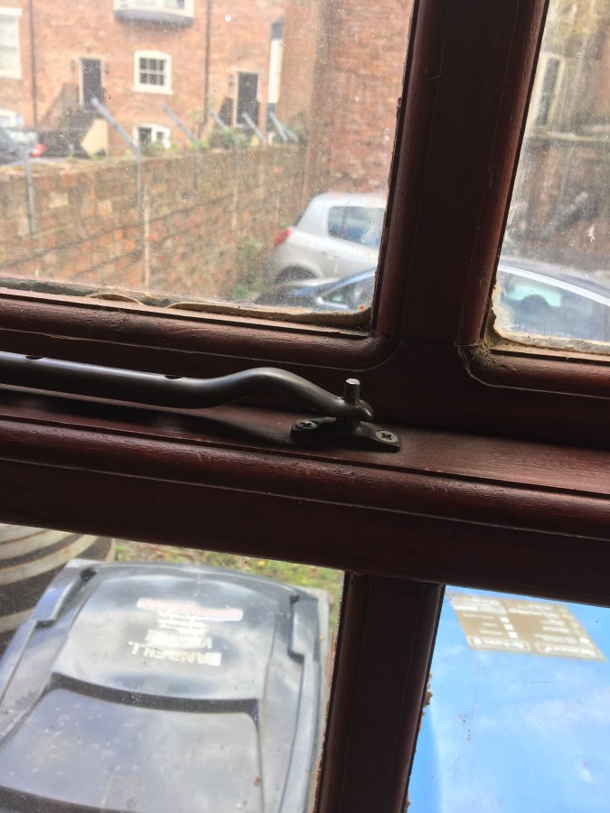

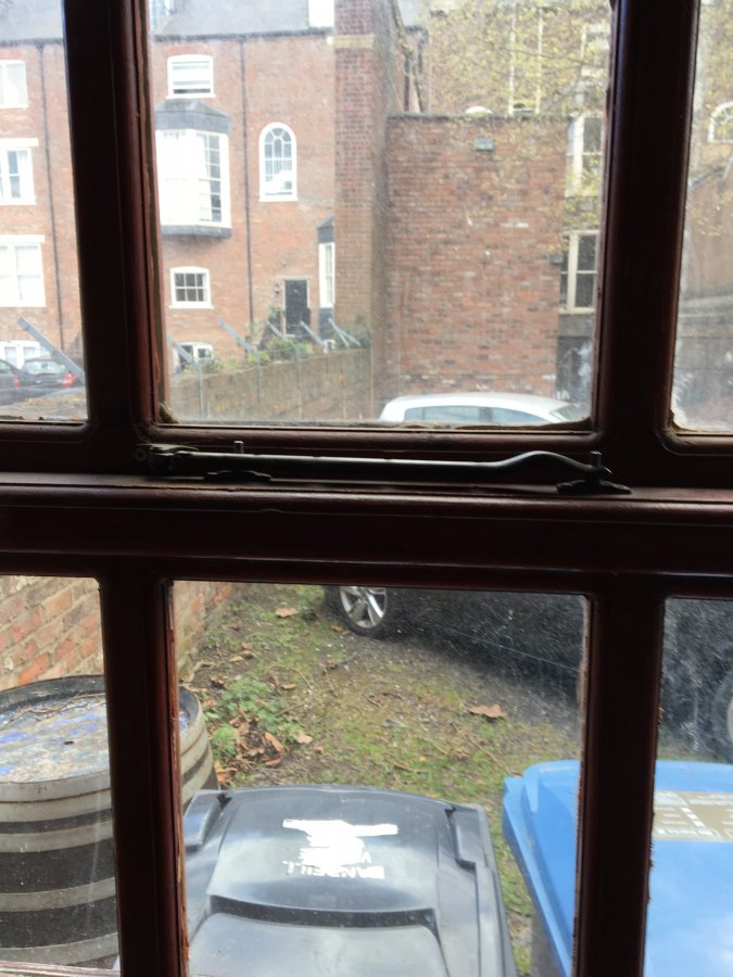

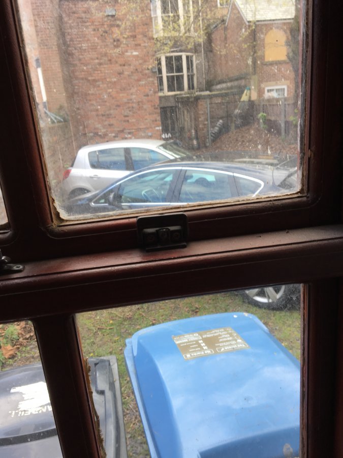

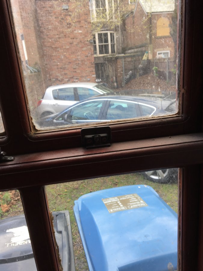

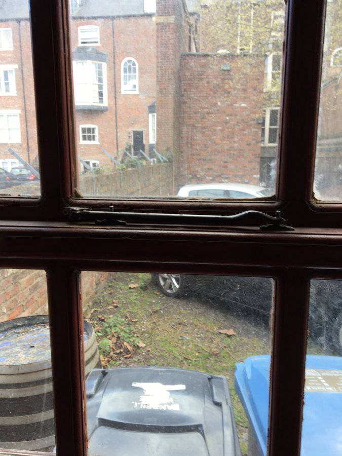

Hi, again,
I have a smaller window in the kitchen. As I am mostly downstairs, it's more important I don't start having any issues like this downstairs, so I wanted to ask if the configuration of the downstairs window is correct, or if that needs an extra catch? Thanks.

WolfOfBakerStreet, good evening, sorry I missed your last posting.
In general terms, any opening window whether it be a hopper [last images] or side hung have conventionally had two points of equidistant anchorage, this because the opening sash tends to twist within the frame, this because of thermal and moisture movements within the timber.
I may be wrong, but your last posted images of the Kitchen window has two fixing points? but not Symmetrical on the sash, the secondary fixing appears to be on the right hand side of the sash, this second fixing point could have been introduced as an intruder deterrent? or simply because this sash historically has also been vibrating because of the single central sash fixing point?? [ then as above the sash twists and vibrates]
Is there a problem with the Kitchen Sash hopper?
Any joy with the upper floor side hung problem??
Ken
Hi, Ken,
I'm not sure what you mean by a ''fixing point''? There is one restrictor, and one catch. The kitchen is fine, but if there is to be a similar problem, I'd rather solve it before it begins.
