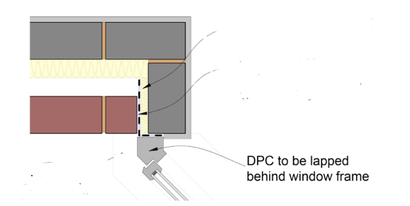

Any DPC protruding from the reveal should be folded and tucked behind the frame, not cut.
When you say "behind the frame, where do you mean? I can't visualise or figure it out, sorry.
Do you think otherwise?
Cheers
This is the principle

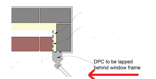

I must be having a bad day! I can't figure out that picture. If I was standing outside looking directly inside through the window, would I be looking in the direction of the red arrow?
Is the window open roughly 45 degrees?
In that diagram, isn’t the red arrow is on the inside?
And the window is angled, like a bay.
It’s not the best of examples, don’t think most of the windows I’ve seen fitted are done that way, even if it is the proper way.
Perhaps @Mr Chibs ... But in all honesty, the longer I look at it the more confused I get!

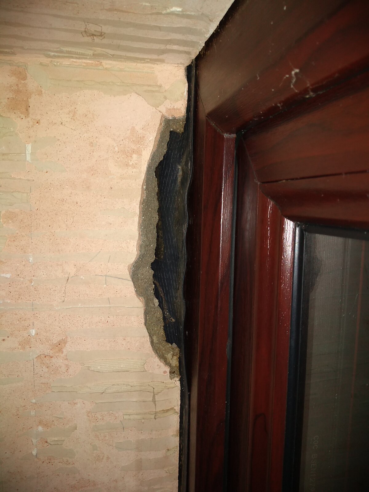

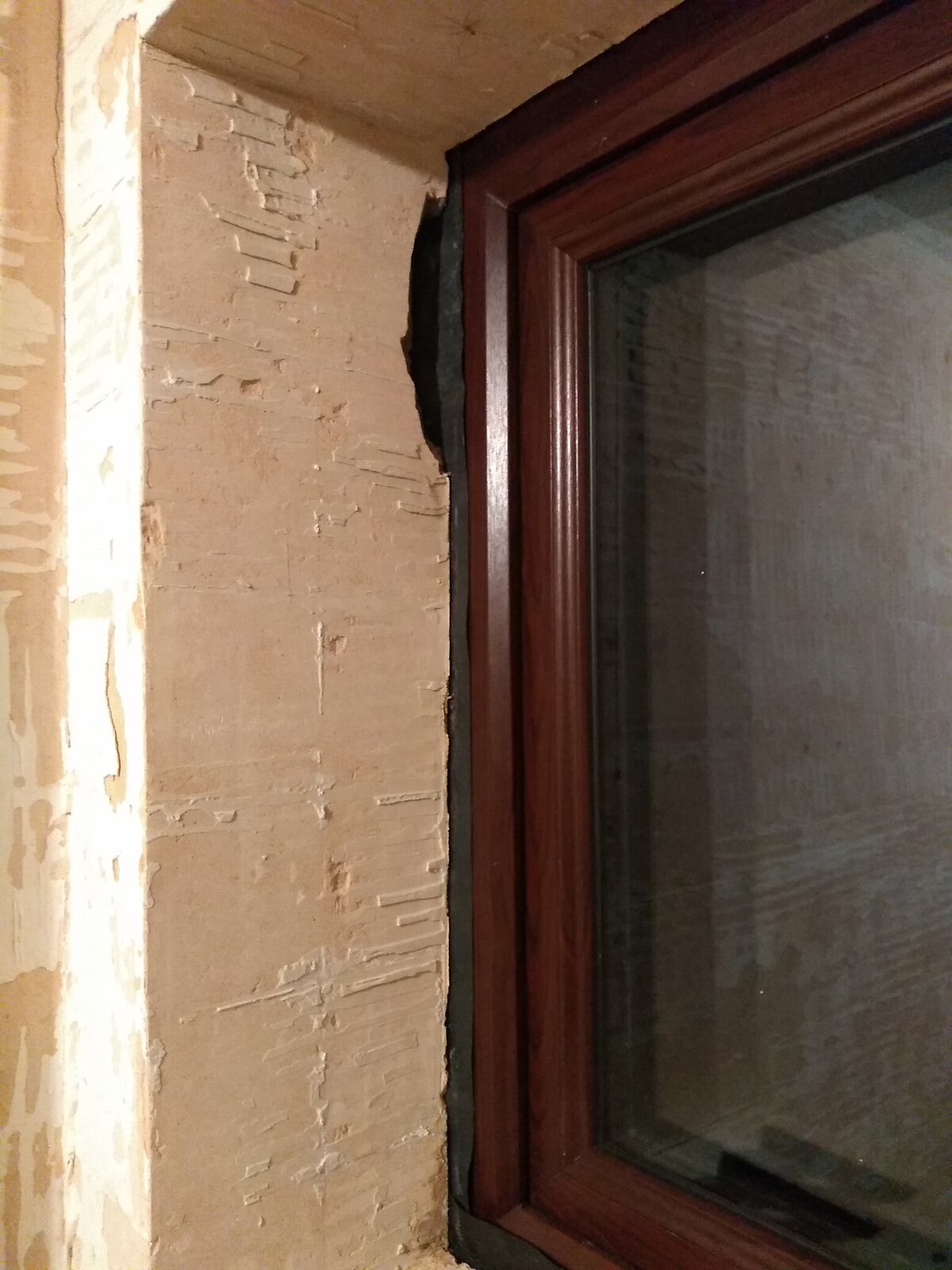

I'm back from work now though, and there was some loose wall in the reveal so I've pulled that out and taken another couple of photos which show the DPC deeper into the wall. I thought using those perhaps we can figure what needs going when the expanding foam comes out....
Cheers
Oops, forgot to add the photos...
