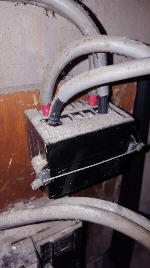

Hi group, a property I rent out has a loose connection on the item in the photo, it appears to be the left one with the black tape on it, it's crackling and the lights are flickering, the unit is sealed, it sits next to the electric meter. Obviously it needs fixed asap, what I'd like to know is, who's responsible for this, is it me or the supplier for the property (British Gas)
Thanks in advance group, Otto in a sunny Cumbria
You should switch off your electric at the fuse boxes/ consumer units, (or the arcing could start a fire). If the connection is between the suppliers cutout (the black thing at the bottom of your photo) and the electric meter it is the suppliers responsibility. If it is after the meter it is your responsibility. The 'black tape' is the inner insulation of the cable (which shouldn't be showing like it is in your photo). If it is your responsibility, I would recommend calling an electrician to correct it, as it will mean exposing permanently live connections, not a DIY job.

Otto: can you see (without touching anything) where those two pairs of cable go? It looks as if the left hand pair (left hand in the Henley block) probably come from the incoming supply below, but where do the other pair (disappearing out of top of photo) appear to go?

Thank you so much for all the advice guys, the pro's came out within the hour, stripped all the wiring out and renewed, job is sorted. Would like to upgrade the consumer unit in the near future as it's quite old.

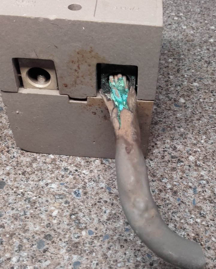

You got it in time which is good, loose connections can easily cause fires, the one below could have if the terminal wasn't mounted in porcelain, a plastic switch certainly wouldn't have survived. This cable is a 35mm².
