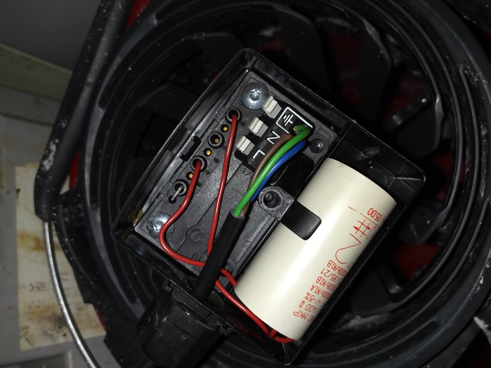

I've taken off the pump and clean it and it appears to be working fine, although old. It's got it's a Grundos UP 15-50 and is meant to have three different speeds. Online it says that you just flick a switch but mine doesn't have a switch just this cryptic arrangement of wires from the capacitor. Do you know how I can change the speed?

you are looking at the wrong end , it is the impellor, the water end you should be looking at
