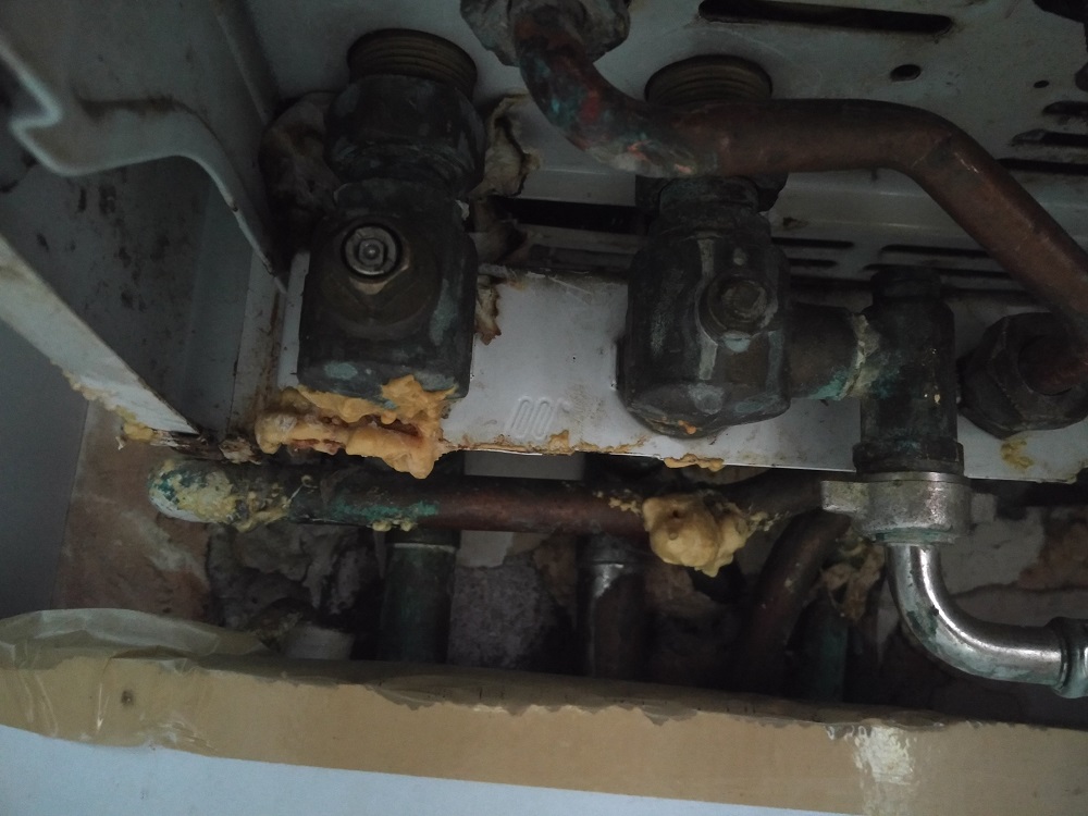

Hi,
I have a vokera linea 24 and it doesn't appear to be pushing the hot water around my radiators. I've just moved into the house and it could be it didn't work before or it could be related to my taking off the radiators in the rooms for redecorating (I've set the pressure).

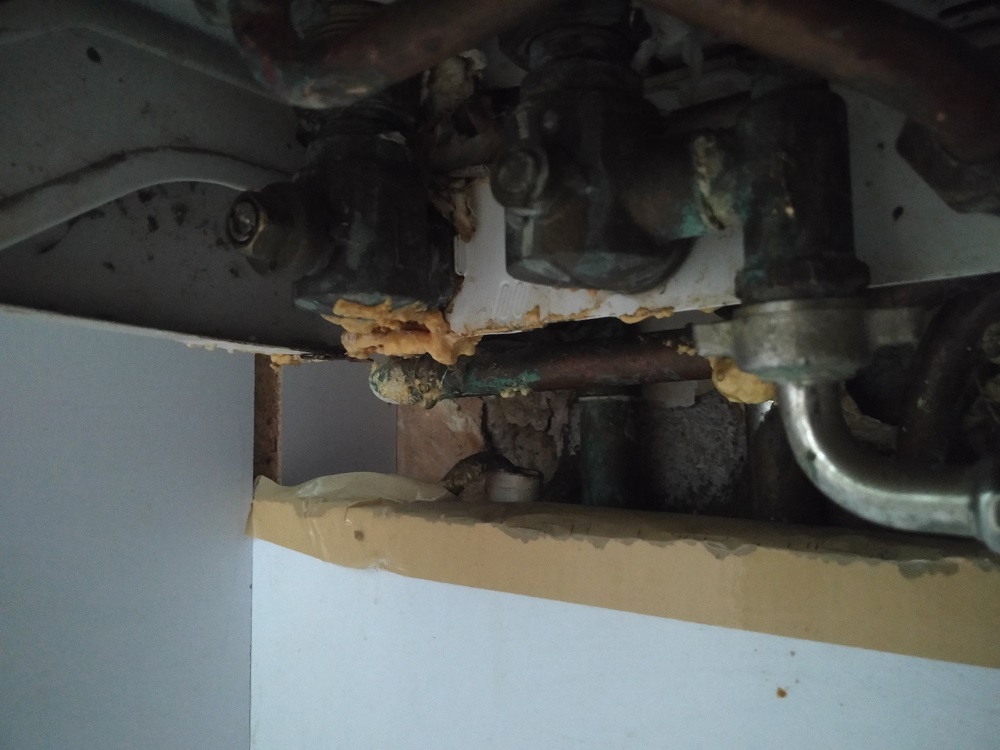

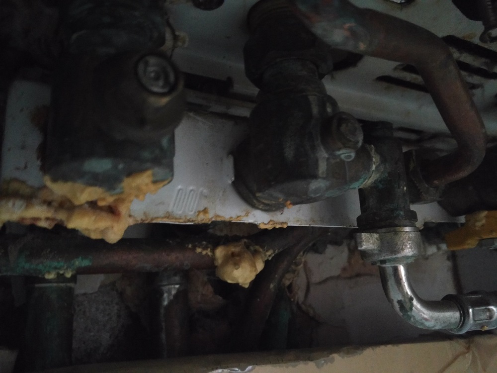

I've been looking online and I'd like to take a look at the pump to see if it is clogged with sludge. It recommends that I turned off the two valves on the left hand side, however as you can see from the images the valve on the left appears to need a special key I can't find online (A have a large flat head screwdriver but it doesn't appear to be wide enough). The other valve I've been told to close doesn't appear to have a valve at all!

It almost looks as though the valves aren't completely open, but what was the condition of the rads when you took them off. Was there a lot of black sludge pouring out of them when you lifted them off the valves. It's unlikely to be sludge in the pump, so I'd leave that one for now. Make sure the valves are fully on, and then close off each rad, and start by opening the rad nearest the boiler, and then work from there. But I think the boiler needs a service/overhaul. Did you add inhibitor to system when you refilled it?

do not turn those valves or you will have to replace them they will leak
As what he ^ said.
Them valves from your photo look suspect,you need to confirm they are 100% open and not leaking water,there are other reasons for poor ch circulation its a process of elimination.

Looks like the return valve's (right) head has been sheared off, it should have the same square head on it as the flow (the left one), an adjustable spanner or correctly sized open ended spanner will fit it. As the guys say though, 75% of the time they will leak if they haven't been used in a long time.
Time to get someone in and sort it out, is what I'd recommend.
