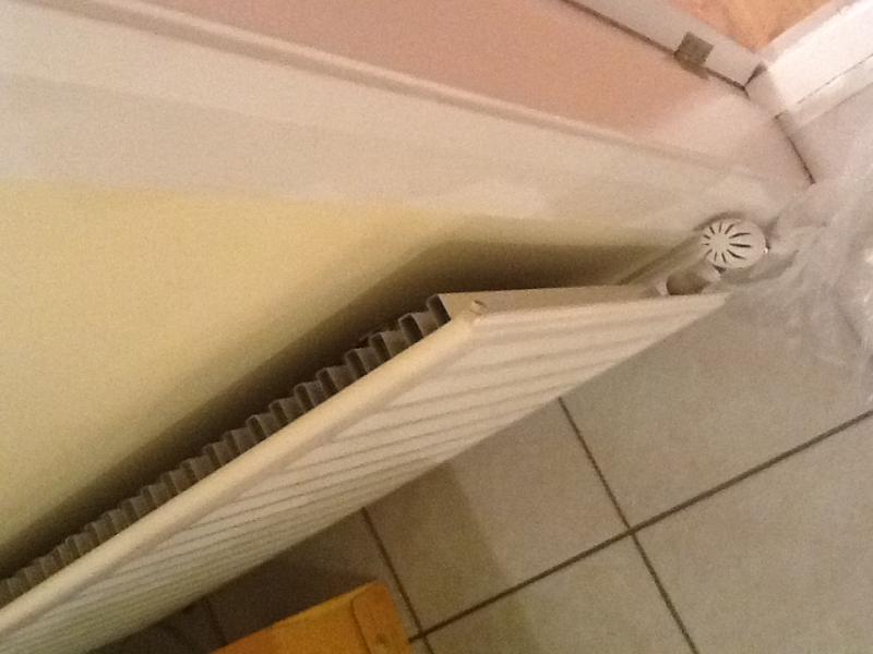

As the title, guess I tightened too hard.

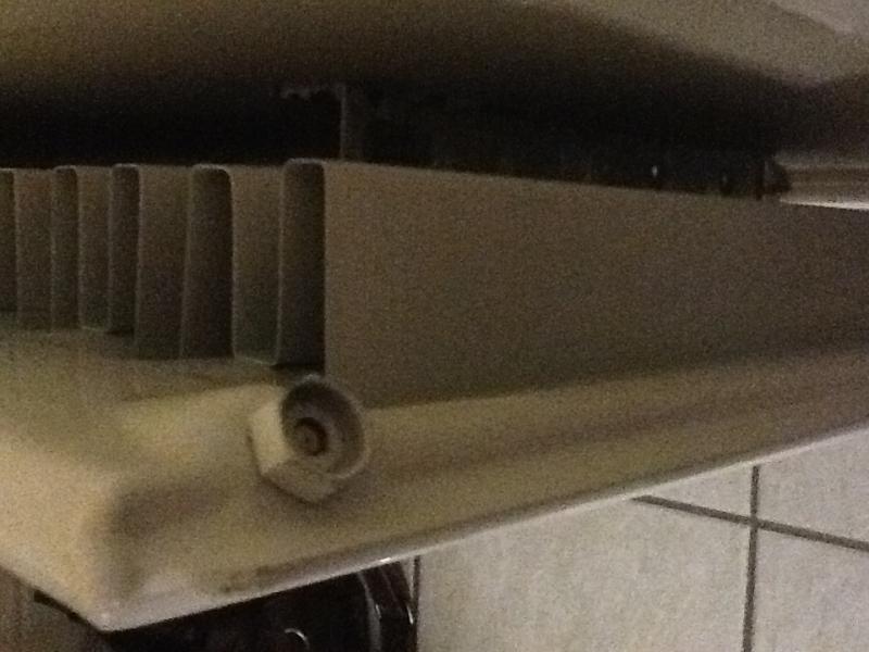

Thing is the one radiator that sheared is different to all the other radiators in the house. The others all have a large bolt at the very side of the radiator with the bleed nipple in the middle. These appear to be the standard 1/2 " BSP valve which I've found online.
This has a much smaller bolt than the other radiators holding the bleed screw (an 11mm spanner fits it). Anyone any ideas what I'm looking for/where I can get one.
Next bit, if a replacement can be found I assume I close both radiator valves down undo the screw, catch water until it stops and screw in replacement (should it be available) with PTFE on the threads?
I've tried to add a picture of the radiator in case that helps.
All help appreciated.

A close up. I'm reluctant to remove the valve until I have a new one to put in! As above 11mm spanner fits it (I realise this bears no relation to the thread size I need...)

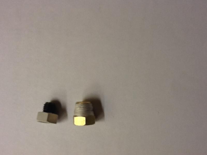

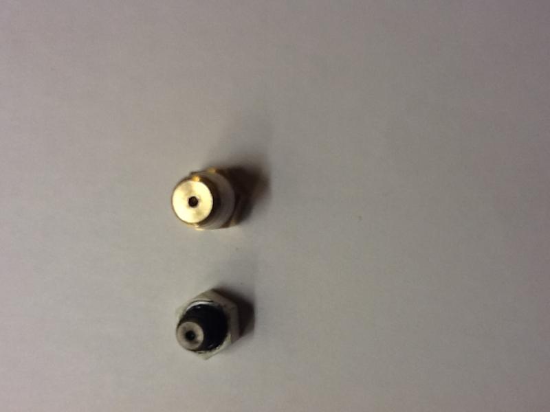

So, got my new bleed valve.....
Turned off radiator valves....
Unscrewed the old one, put PTFE on the new (1/8 BSP) valve only to find it is too big.
Any ideas - can't see a smaller one on the net? As it is I've put the old valve back in and wonder whether just to open the nut which contains the sheared bleed valve if I ever need to bleed the radiator.
I suppose new radiator, but this seems a big solution to a small problem!
Other pics (the shiny valve is the new one that's too big)

i wanted one of these a long time ago as my plumber could not locate one,i had a go (at locating new air valve).
your radiator looks like same as mine in a previous property i had,mine were center rads,sold by plumb center as their own brand part of the centerbrand range.
I do not know if these are still made/available as changes happen.
these are called micro valves and they are metric size and even 8 years ago they did not sell them seperate and no other air valve would fit.
the rad that had the broken air vent was a long double £££ so i had to buy the smallest centerad radiator and remove the air vent to fit to the defective radiator.
the professionals here will confirm if this is a plumb centre brand radiator.

Just to update,thanks for putting me on the right track. Turns out was a Myson rad and they very kindly sent me out a replacement which fits perfectly. Thought I'd update in case anyone has the problem I the future. It was indeed a "centre rad" made by Myson for plumb centre. They call it their "shoulder valve".
I looked at the automatic vent things but it looks like these replace the small bleed screw that fits in the valve, this would have been no good to me as it sheared off flush and I wouldn't be able to remove it.
