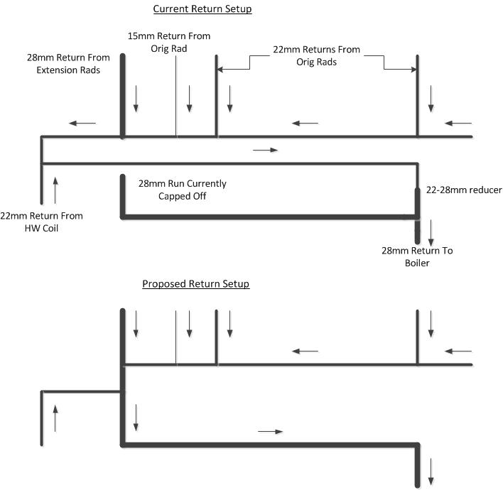

Merging the two CH returns before the HW returnis correct; but the HW return should T into the CH return, not CH T into the HW; i.e the CH should have the straight run through.

Ok - time for an update and a little bit more advice please.
I managed to speak to someone (excellent bloke - John) who was too busy to spend much time on my problem but as he was fairly local he agreed to take a look to try to get me in the right direction. He was pretty certain that there was a blockage in the boiler so I drained down and flushed through as best I could (I had previously done this but thought it worth another try). After that, I did get a flow through the boiler and managed to get hot water plus heat from some of the rads but the system is still not working properly. Anyhow, it does look like it was/is a blockage so at least I am happier that I know the cause of the problem. John recommended that if I could get the boiler working (Ravenheat) then fine keep it but that it was not really worth spending money on to repair. As it is border line anyway with regards to output to heat all original rads plus the extension ones, I have decided to change it out for a bigger model. John also inspected my pipework and pointed out a few issues with the original installation (not my work!!) where the pump return meets the rad return (T could be better aligned so that the two returns do not "meet head on"). He also advised that I could better utilise the 28mm return that the original engineer (1st post at the top of this chain) got me to modify.
So, I would be grateful for some advice on the following:
1.Boiler Manufacturer
I am looking at either Ideal, Worcester or Vaillant. John recommended Ideal but these got a poor reliability review on a couple of review
sites that I checked out. I appreciate that reliability may be affected by the actual model of boiler (heat only) that I choose but should I
stay away from any of these 3 manufacturers
2.Pipe Return Reconfiguration
I have attached a diagram showing the existing and proposed return pipe configs - anyone see any issues with what I am proposing
3.There is currently no by-pass valve on the system. I believe that as I have a mid-position valve one is not required - is that definitely
correct
