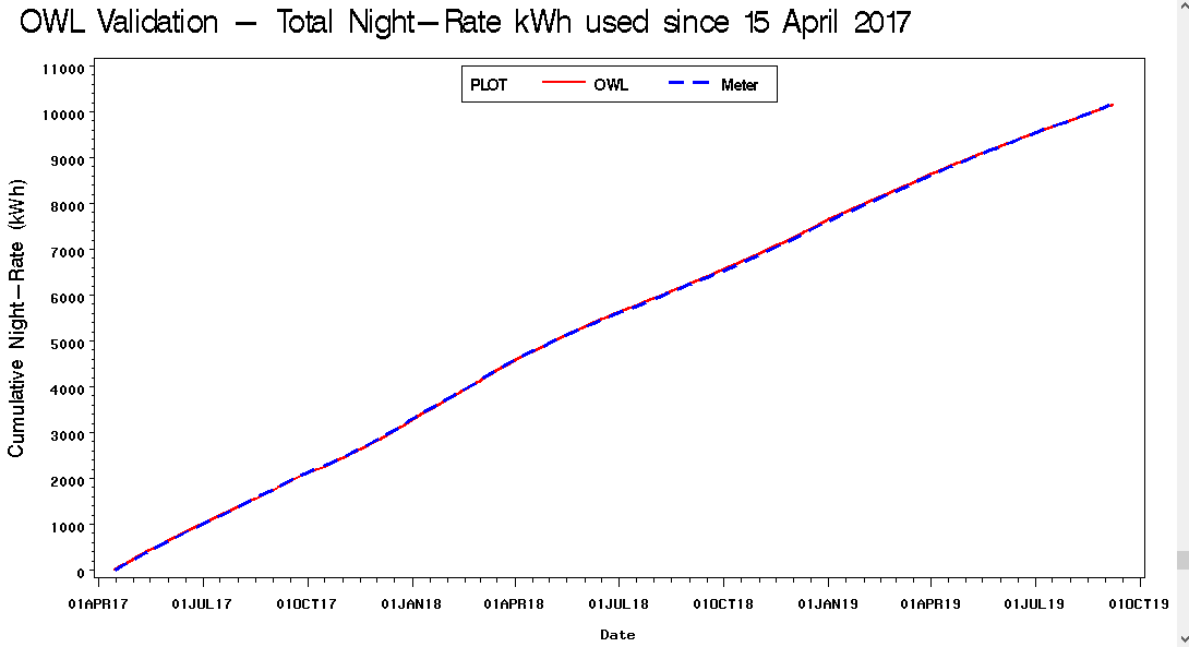

In terms of averages over time, variations in voltage and power factor 'average out' and really do not have any appreciable effect on accuracy. I use a monitoring system based on clamped-on current (only) measurement, but as the below shows for my night-time usage, conversion of that to kWh with assumptions of a constant voltage of 240V and a constant PF of 0.98 (initially determined empirically) results in figures which are incredibly close to the (true kWh) data based on my ('dumb') meter. Over the ~2.5 years illustrated below, I have used a total of about 10,000 night-time kWh, and the difference between the meter's cumulative figures and my current-derived ones is, today (after those ~2.5 years) a mere 19 kWh (i.e. an error of about 0.19%).
It's obviously different when one undertakes real-time or short-term measurements, since uncertainties about voltage and PF can sometimes result in current-derived kWh figures being quite inaccurate.
Kind Regards, John
