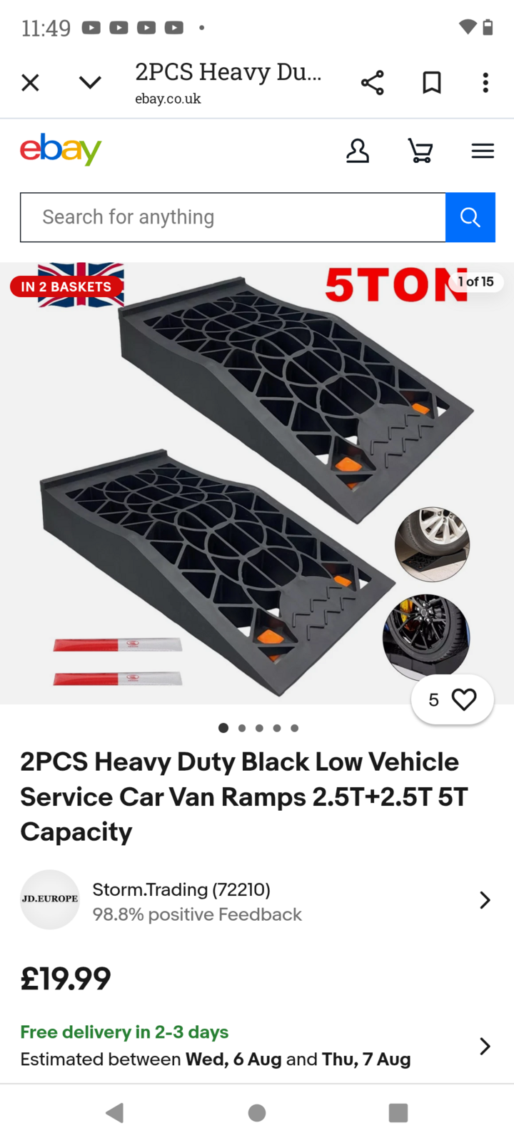

Get some cheap plastic ramps as used for motorhomes. They will raise it sufficient to get underneath. DO NOT RELY ON A JACK ALONE.
This the sort if thing?
