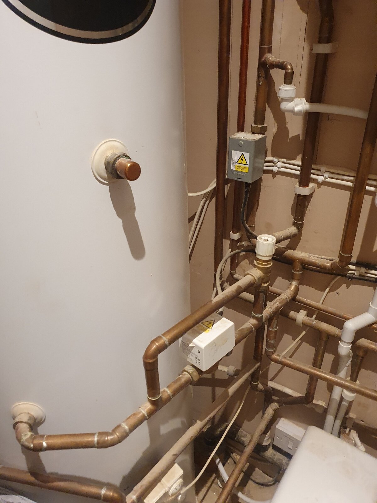

I had to drain and refill the system a few weeks ago. Since then we're getting a loud humming noise coming through the pipework, but only when the heating turns off and the boiler goes into overrun for a few minutes. Have bled all rads repeatedly, no trapped air. Tried x200, didn't help.
Any idea what the cause could be? I can feel the pipe at the boiler vibrating but the fact that it happens when heating stops makes my think it's more likely to be a diverter valve than the boiler. If so does it need replacing or is there a simpler fix?
Had to Google it, might be wrong but i think it's the white knob in the photo. Seems like it bypasses the hot water valve, not sure if that's normal. But no it hasn't been altered.
What's the link between the bypass and vibrating pipes?
I used to get a 'bang' when my heating went off and the ABV opened. I opened it up fully, ran it for a while then reset it and that cured it. Might be worth giving that a try? At least if the pitch of humming alters, you’ll have tracked the problem down and can look to replace it.
Thanks for the tip, problem solved. Only had to give it a tiny nudge and the humming stopped straight away
