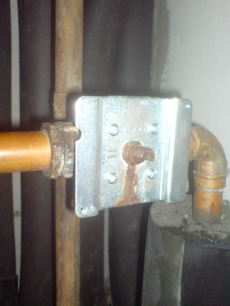

After checking the closet (i.e. where the noise originated from), I noticed that a bit a water was dripping down at the back of the Sunvic DM5601 Actuator. I removed the actuator to access the Sunvic MK1453 valve, I noticed that I can easily turn the valve 360 degrees, is this normal? Or is this valve spring loaded ? (which could explain the loud noise if the spring broke)
Sunvic MK1453 valve:
PS: I tried to remove the 4 screws at the front of the valve, I thought the piece of metal at the front was only used to support the Sunvic DM5601 Actuator, but then lots of water started dripping down so I put back everything in place. I guess I was not meant to do that.
What would likely be the cause of the issue? I am quite worried as I now have no CH nor HW (and this week is going to be quite cold), and the parts are not cheap apart from the programer. Just trying to find out the easiest way to troubleshoot the issue to determine which part needs replaced.

Hi Ant
It could be that water from that leak has got into the valve actuator and shorted it out. The valve will have to be replaced.

Not the best of pics and on first look I thought it was a 2 port but its a 3 port the vertical pipe behind is the feed pipe
OK , my mistake, should have noticed the D shaped spindle - thanks stardanny.
Same applies though, it's got to be replaced, and the wiring is not the same. It won't matter which make of valve you go for then, there're all much the same. I'm afraid you'll also find you need a few slight alterations to the 22mm, even if it's just replacing the nuts and olives.

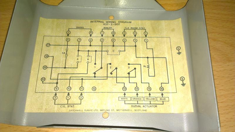

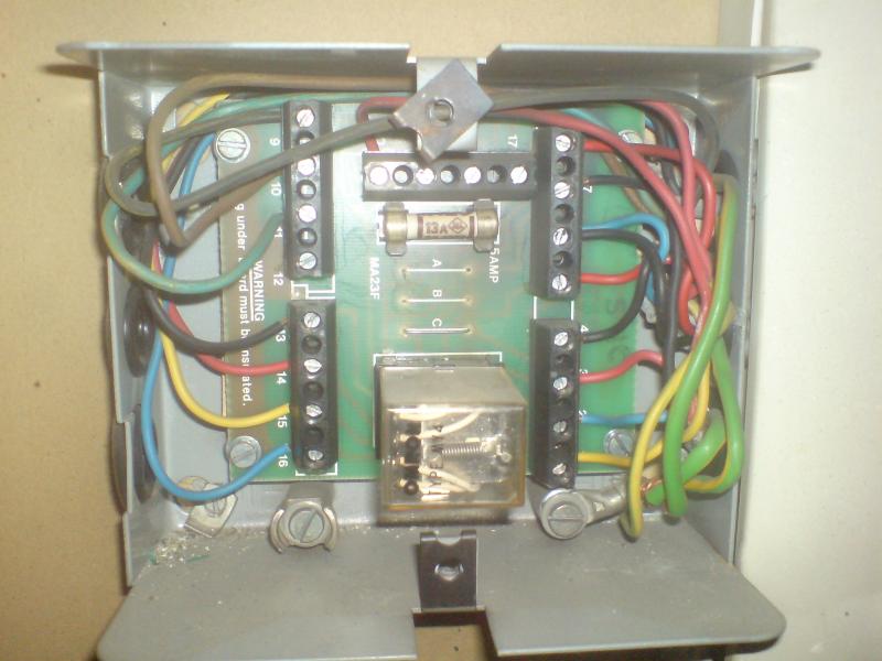

Below is a photo of the junction box, a bit too scary for me:
I just hope that replacing the MK1453 valve (I had no choice as it was leaking) and the DM5601 Actuator will do the trick. There might be a chance that the Salus EP200 programmer has been damaged since the fuse in the junction box was 13A instead of 5A! I should have checked this myself some time ago but I would not have expected someone to install the wrong fuse.
As a last resort I will replace the programmer (not a big issue as not that expensive). However if replacing all of the above do not help, then I am really stuck. I would not know how to replace the junction box since it is no longer be manufacturer and would need upgraded. If it comes to this, I just hope that my usual trusted plumber will be available.

In the mean time I switched the electricity off, replaced the DM5601 actuator and replaced the fuse with a 5A use. After turning the electricity back on, the Salus EP200 is still not functioning (after removing the jumper to disable the internal battery, the EP200 screen is blank). After checking the voltage between the Live and Neutral at the back of the programmer, I noticed this was at 0V. The voltage between the Live and Neutral at the thermostat is also 0V.

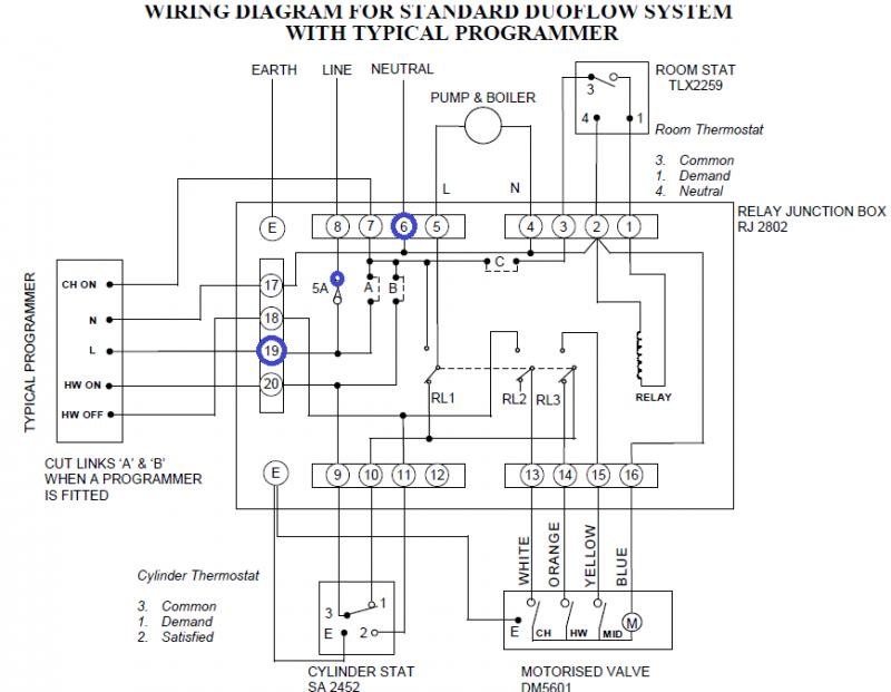

Voltage between pin 6 and 8 of the junction box returns 240V, the wiring diagram is available in photo below:
I am now quite concerned, I ordered a new programmer (which I can send back within 30 days) but I am pretty sure it is not going to make any difference for the above reasons.
It seems that for some reasons the mains arrive at the junction box, but then do not make its way to the other components. This junction box is no longer manufactured, also there is no guaranty this is the fault, so I cannot replace it.
Looking at the diagram of the junction box (above), could anyone help with the measurements I should take to pinpoint where the fault could lie?
I have found an even clearer wiring diagram online, still available on the Sunvic web site (http://www.sunvic.co.uk/rjtypicalprog.pdf).
My junction box seem to be actually called a Relay Junction Box RJ 2802. I get a voltage of 240V between pins 6 and 8, but no reading between 6 and 19. Therefore I took a measurement between pin 6 and the top of the fuse (highlighted in blue in the wiring) and still no reading! Does this mean my junction box is knackered?
Tomorrow I will stick the electricity off again to remove the junction box from its unit, but doubt I will find anything useful.
Would anyone know what I could replace this RJ 2802 relay junction box with?
Hi
From your diagram, I would have thought the fault is only the 5 amp fuse, I would be surprised if this had not blown.

OK I can only use your diagram, I really can't remember the fun and games I must have had with those boxes in the past.
If you have no reading between 6 & 19 there must be a problem on the board. One suggestion, If the supply to the system is fused at 5 amp or less, can you not bridge 8 to 19 and see what happens.
Would do that but then I bypass the fuse... instead I will first remove the circuit board from its unit, clean the track between pin 8 and the fuse (which I suspect has blown away) and bridge it with a wire. I just hope no other components got damaged... will update this thread shortly. Thanks for the help so far.
Yes, it sounds bad, but that was the intention to bypass the fuse, but only if there is another fuse in place.
BTW please be careful with that test meter, the low priced units tend to have some pretty poor insulation on the leads and probes.
