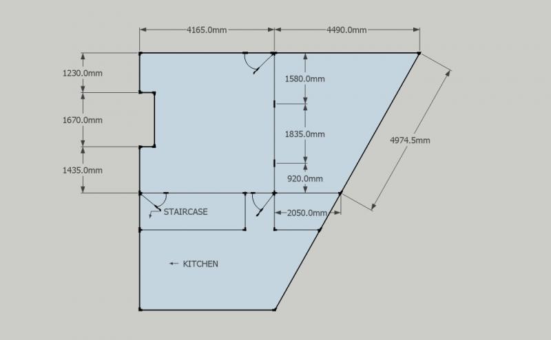

Tonight's job is to get a decent sketch done and posted on here. I'll do the whole Ground Floor.
Righto, for those interested, here's the sketchup of the Ground Floor with dimensions

After some discussions with the wife and having a play about with the furniture layout, it would seem that the preferred plan now is to construct the porch, but have it entering the lounge at an angle of 90 degrees to the front door (as opposed to the Dining Room as originally intended).
We would then get the arch-way blocked up and a single doorway put in the dividing wall at the kitchen end of the wall.
I'm pretty sure that I don't need planning permission for the works, but after quick read around on here, am I right in thinking my LABC need to be informed, as we will be erecting new internal walls and modifying a load-bearing wall? Is there a self-certification scheme for builders (as there is for Gas Engineers with Gas Safe)? If so does anyone know what it's called?
You can probably retrieve enough bricks from knocking out a new doorway at the side to at least build up the old doorway to cill level and fit another window above. That might solve the problem of lintels and reveal.
Rearranging the internal layout will be subject to Building Regs and the main consideration will be means of escape. You may need to retain the arch between lounge and dining room, or install interlinked smoke detectors.
