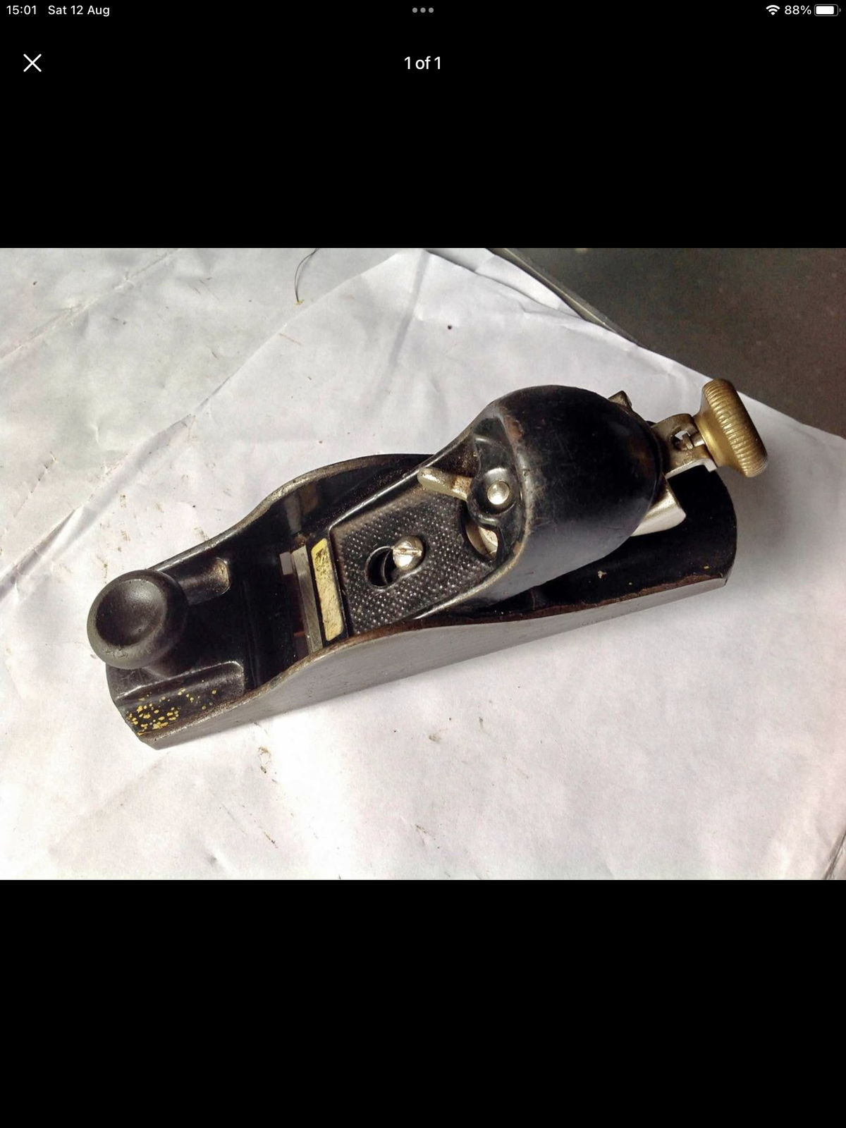

Is this Stanley a Low Angle plane? Anybody have one can tell by picture (on sale locally)
Looks like a #220. Standard angle (21°), no adjustable mouth.

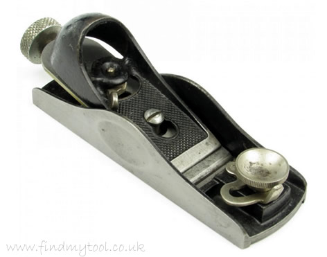

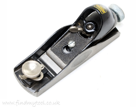

The #60-1/2 and #60-1/2A (13°, low angle) both have an adjustable mouth, so the metal front knob on them has an adjuster quadrant plate visible beneath it, and the front knob is metal, not plastic or wood. So if you want a low angle plane, you really need to be looking for a #60-1/2 (because after WWII it was the main low angle block plane Stanley sold in the UK). This is an earlier style #60-1/2:

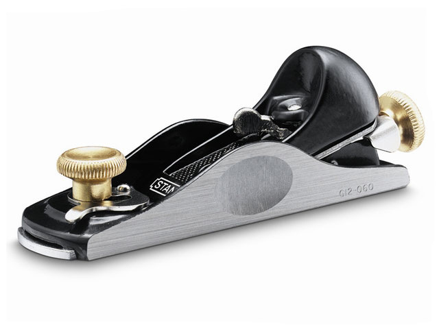

Note the little silver quadrant plate beneath the front knob. Even the latest models still have those. For completeness, this is a modern 60-1/2:
