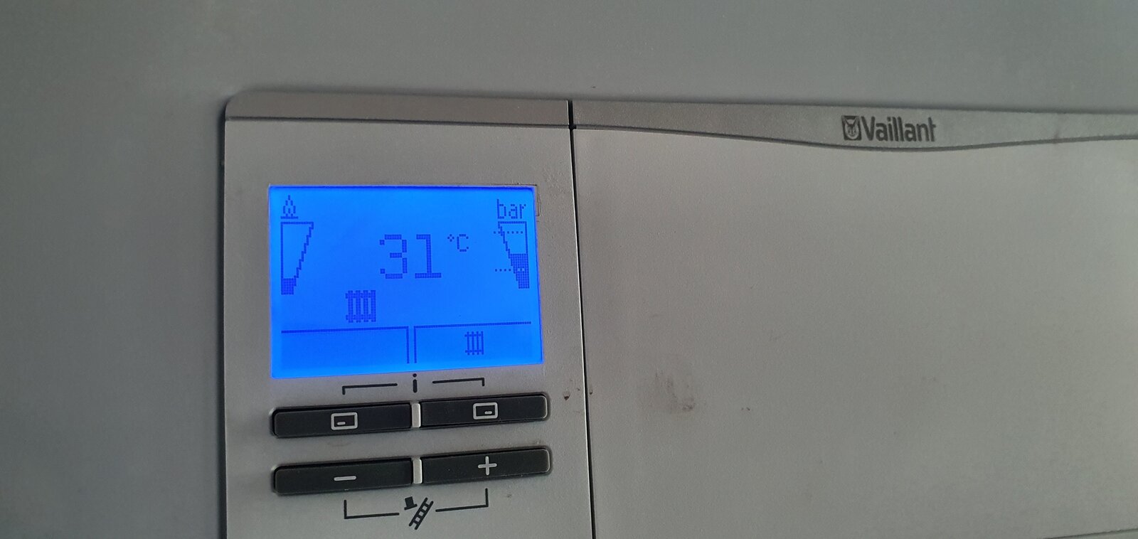

Hi all,
I have a fairly newly installed Valliant Ecotec Plus 637 (fitted in the Spring) feeding an Ideal cylinder, and recently started using the heating for the first time.
When I turn the CH on the flame indicator starts near the top of the range for a couple of seconds but then settles down to the very low level shown in the picture, and the radiators are taking ages to heat up (which is also not helping my attempts to balance the system).
Can I (and should I) turn the flame up?
Cheers for any help,
Bertles

It’s quite possibly just modulating down, especially if you have Vaillant ebus controls fitted.
Do you know if the installer setup hot-water priority? A call for HW should fire the burner at full kWH rating and the flow temp should be 70°C+ to reduce chance of bacteria growth in the cylinder.
HW being fed using a Y-plan or S-plan design with the boiler range-rated down for CH isn't good.
>and the radiators are taking ages to heat up<
Is that only when you want HW or generally? If the former, suggests that heating water in cylinder is drawing most of the heat from the circulating water.
I have a Salus wireless thermostat - don't think I have any Valliant controls elsewhere unless they're hidden away somewhere.
No idea on the hot water priority unfortunately. I did turn the HW on and drain some of the tank and the flame was at the same level as before, and the temp was reading 50c although there's not a huge amount of info on the display so I don't know what that was actually referring to. The rads take a long time to heat up regardless of the HW.
I'm far more used to having combis in previous houses so there's a LOT I don't understand about a setup with a cylinder (as is probably clear!)
Feels like might be time to get someone round to have a look
Depends how long your giving it. They fire around 60-70% then drop down to minimum, then depending on temperatures, can take anything up to 5 or 6 minutes before going to their running rate, this running rate will depend on how the installer set it up, if it was left on auto then it will think its a small system as its only had a hot water coil to deal with all summer. It could be that just needs changed off of auto and set to a higher output.
If you look in the manual under installer level/Diagnostic codes, this is code D.00 partial heating load (Range Rating) If your not comfortable with it then call installer back and get them to set it up.
