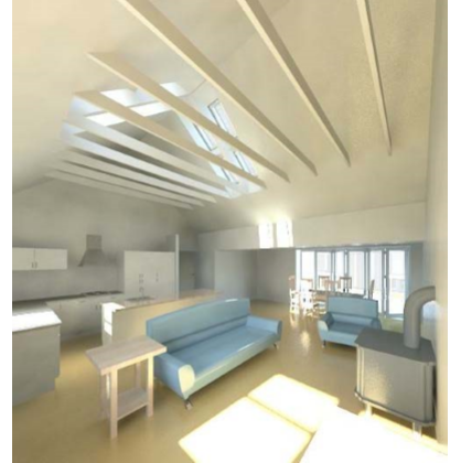

We are still at design stages, and all this needs to go down for the building warrant (im in Scotland). The service gap is at the front, so we have, slate roof, 20mm air gap, 80mm Kingspan PIR, VPM, 30mm service gap, 12.5mm plasterboard, skim. This is the buildup suggested by architect. So no penetration of insulation needed. The style of light is dictated by the wife.

Hi,
The depth of the beams are already 180mm, the insulation goes between. So not a warm roof as such here the insulation goes above the beams.
This is the design.
Have you considered putting LED strips on the top surface of the beams as up lighters to illuminate the ceiling which then reflects softer light down into the room.
