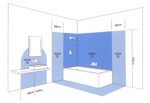

I went to B and Q to buy some bathroom lights to replace the old recessed lamps with their pitted gold surrounds, only to find that firstly, they don't make that fitting any more, and secondly that my choice is now dictated by Zones.
Given that one of my lights is in the ceiling directly above the bath and another about three feet away, horizontally, do I now have to replace both those lights with low voltage fittings?
What do you mean by low voltage.
Low voltage and extra low voltage are different values.
You would expect to find a low voltages system in a domestic dwelling.
As far as lights are concerned you need to know what the zones are in the room at what is permitted.
There are only 3 zones within the bathroom, I will find you a link.
Here is diagram and the third zones is "zone zero" not indicated but would be in the bath.
//www.diynot.com/wiki/electrics:speclcn:bathroom_zones

Thank you. Therefore at the moment I have 240v Band 2, and require a step down to Band 1. Although maybe I don't, because my ceiling is higher than 2.25m.
Key here is the height of your ceiling if over 2.25m all is good.
Cheers for that. I realise now that BAS included that ceiling height info in the diagram above.
The next key element is the width of the holes in your ceiling for the fittings, it would be less hassle to find a replacement that fits the existing hole size.
True enough. The low voltage halogen fittings are considerably smaller in diameter than the old ones.

Thanks, I won't. I've now decided not to bother with the low--err, extra low--voltage lighting because I've measured my ceiling and it's almost as high as the ceiling of the Sistine Chapel.
Will my 240 volt lighting still be required to conform to IP44, despite being above 2.25m?
OK. So I think I have it now. Above 2.25m there's no need for light fittings to have ingress protection. Although I don't suppose it does any harm if they do.
