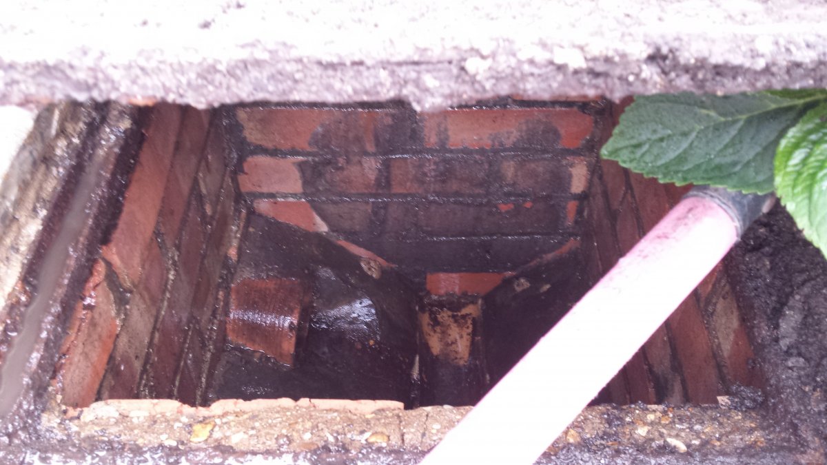

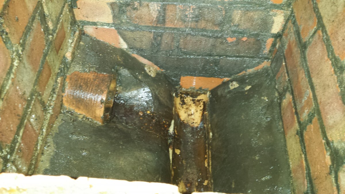

Right, opened the manhole, for the first time did this since moving in to the house about five years ago, found nothing.
Picture attached. Cleaned some soil deposit with a garden hose pipe and then put the metal lid back on.

pity you didn't get all toilets flushed by helpers whilst you looked in man hole to observe the flow.flushing with toilet paper as well so you could see if it came thru. never mind ,this just leaves the house and the section in between.here is some thing for you to try if you have a few big buckets full of water ,and 2 helpers. one of each stationed at downstairs loo and upstairs loo. at your command tell both to flush loos and tip their full buckets in at the same time. the overall water volume /weight may well shift thru to man hole ,where you will be watching.

Because we closed the drain cover, which has decorative pebbles and it was a hassle to remove to access the manhole, we'll try flushing both loo with full buckets, to see if it raises the water on bowl.
