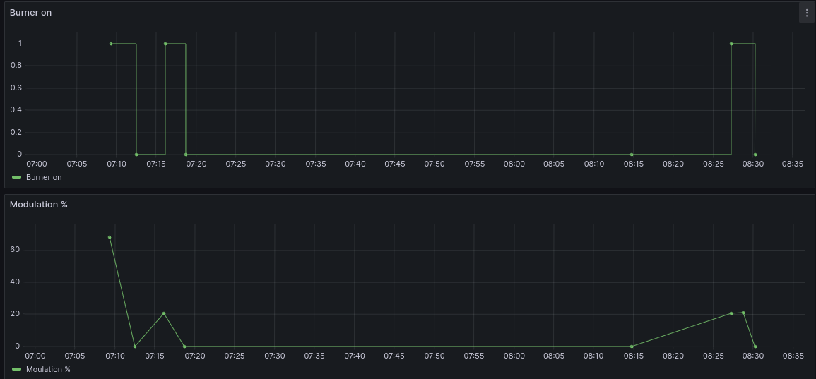

i had been looking why the boiler modulation was so high when having showers was between 60and 90% and well thats really quite alot it suddenly dawned on me its that high because its heating that amount of water! i decided to look at what my shower was using about 12-14lpm was just using a measuring jug and my phone couldnt find my wear cup
anyway i think haha lets reduce that so i put some neoperla flow regulators and pop them in and our modulation rates have dropped to 20-30% and comparing the recent showers we seem to be saving about 1kwh a day!

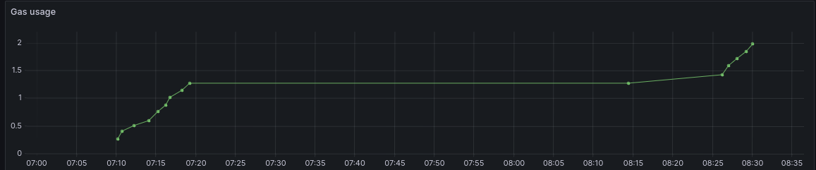

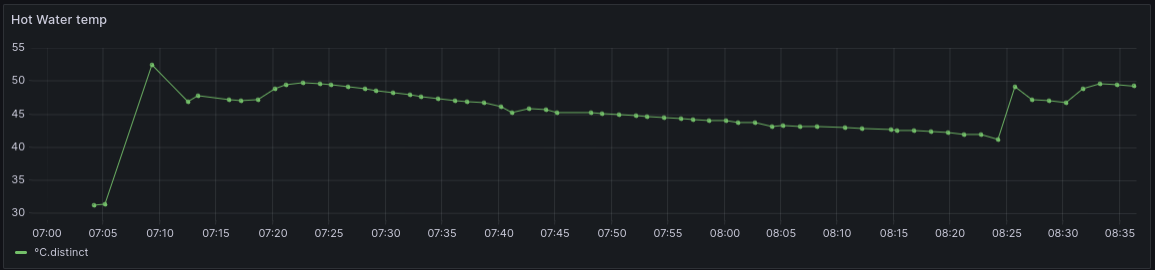

but seems like its been accepted and gas usage is down, 2 showers 10:30 time for them both and consumed 1.98kWh similar earlier in the week was 3kWh and 4.64kWh for a similar day in june
im encouraging the mrs to turn it of when she doesnt need it for a while like letting things marinade like hair stuff today there was a 4 minute gap between her turning it off and going back to finish off

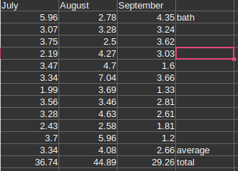

and so far after the first 7 days we have used 22kWh so say 88 for the month and even over last month when i was already making improvements thats down from 112kWh (last 2 months have been the same usage) thats 24kWh saving pr £1.68 a month thats down from an average of 148kWh the year before and 176 the year before that looking at my bills.

so few more days in and it looks like a 28% reduction even including extra showers due to the weather being so bloody hot, my monthly average for last 2 months was 3.6kWh
So confirmed
Replace shower head and save 34% on your DHW production (savings not guaranteed;) )
So after a month I have spent 73kWh on gas after replacing the shower head. Savings are likely greater as there were 3 or 4 baths taken this month usually only 1 and a few extra showers at the start of the month due to the heat
So yeah previous 2 months 111 and 113kWh
Is it worth the spend on the shower err no I'm saving £28.56 a year on gas on a £80 shower head so 33 months and gas prices are coming down slightly so maybe 3.5 years payback
