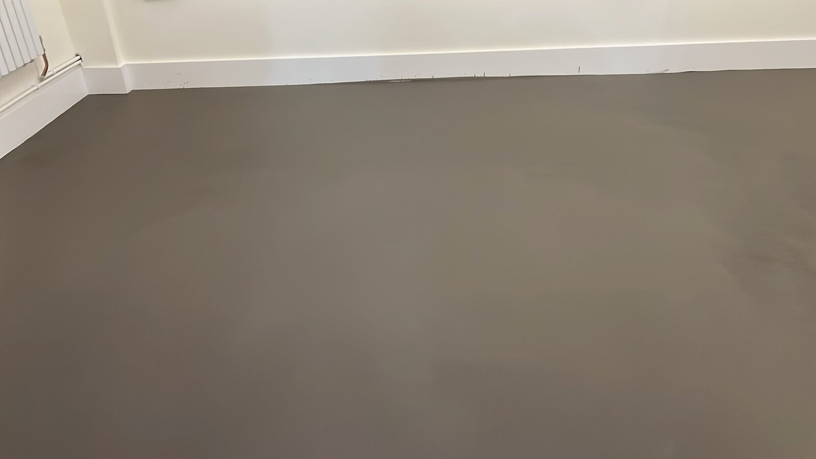

Hello all,
I have read all of the posts re LVT over a concrete floor.
I have tested the concrete in place, and the worst reading was 19% on the external wall side of the room, averaging out at about 8 % across the floor.
I assume that as its under 25% the need for a damp proof is not a huge concern.
I will be laying Karndean Stick Down on the following floor
From previous posts I envisage the following being used
- 400 Repair Mortar (would this be needed to fill in the cracks etc)
- p131 neopreme primer
- Actual levelling compound I would appreciate some suggestions - I am competent DIY'er, but not undertaken this challenge before. Room is 5mx3m onto concrete. I assume a water based would be most suitable, as this appears to be the most forgiving? Product suggestions very welcome.
- I am ok with how to mix, lay etc.
- Any recommendations for a glue for the Stick down planks for a first timer.
Appreciate your help.

You need a specific damp meter for measuring moisture in a concrete subfloor, not a general moisture meter, something like a protimeter or hydrometer box for a true reading.
As for adhesive, we use High Temp adhesives on all our installs nowadays, Karndeans guarantee will only be valid if you use their own adhesive options.
Thanks for all the help and pinned hints.

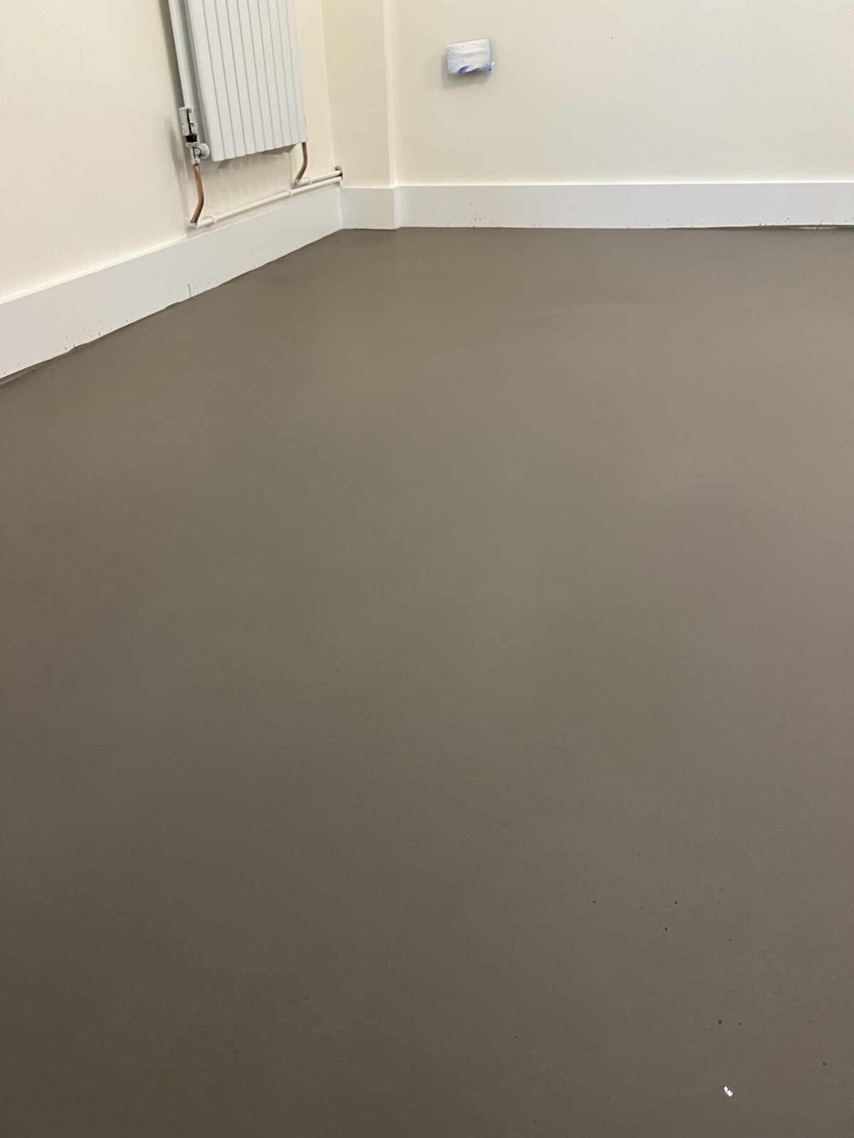

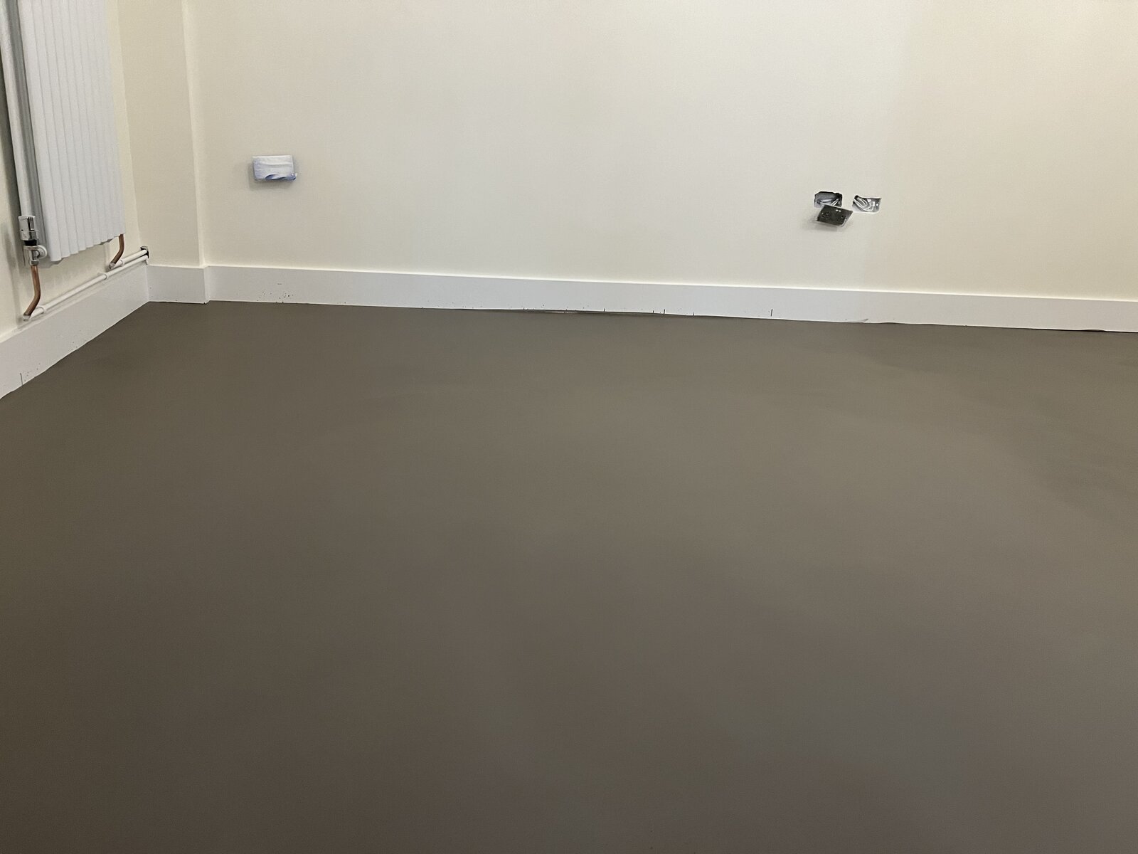

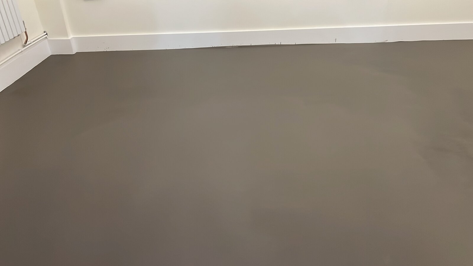

I ended up going for Ardex NA.
First time doing this so took my time.
Some cheap roller and spiked shoes from Amazon helped!
Pleased with the result.

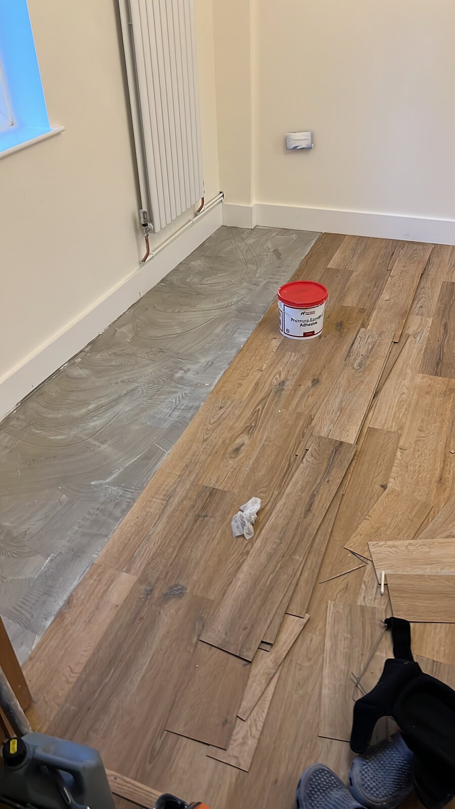

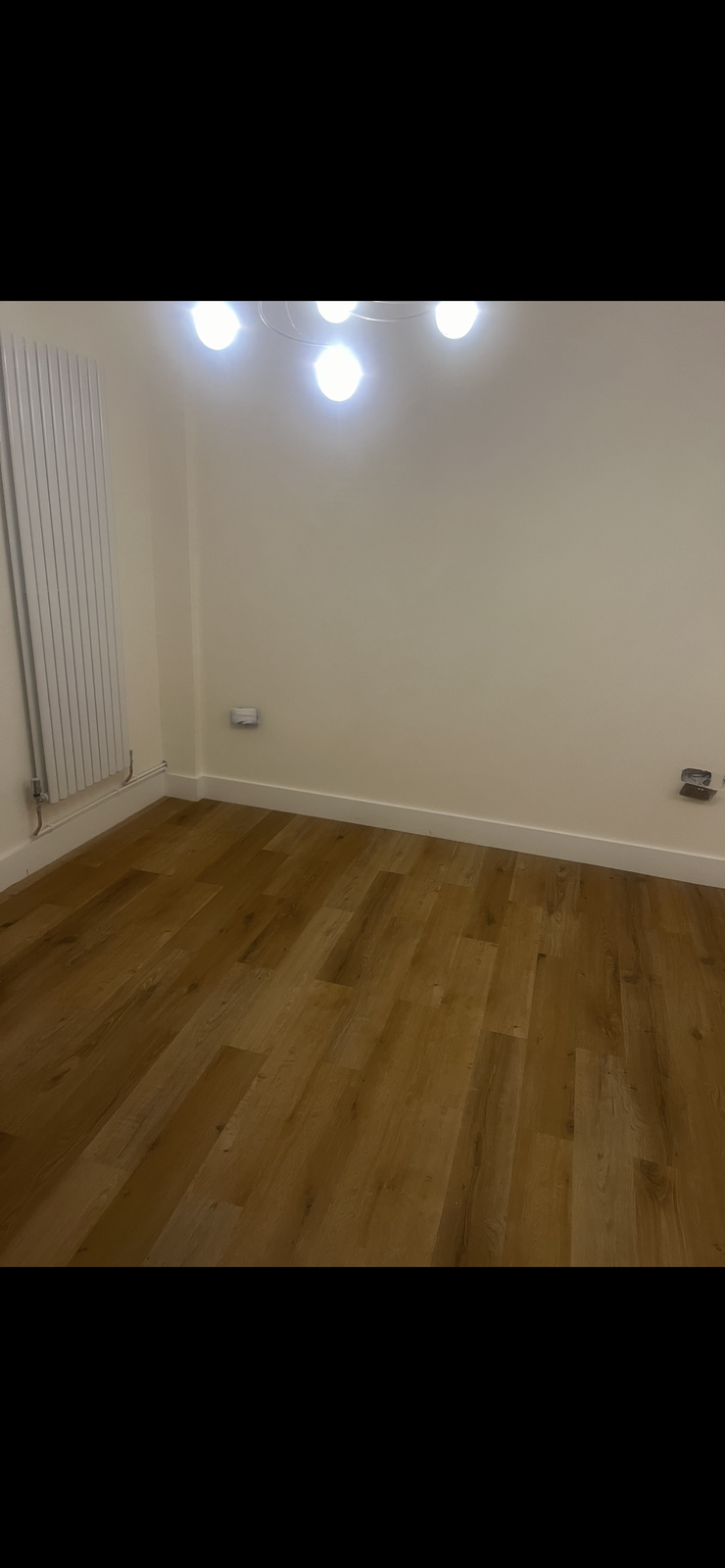

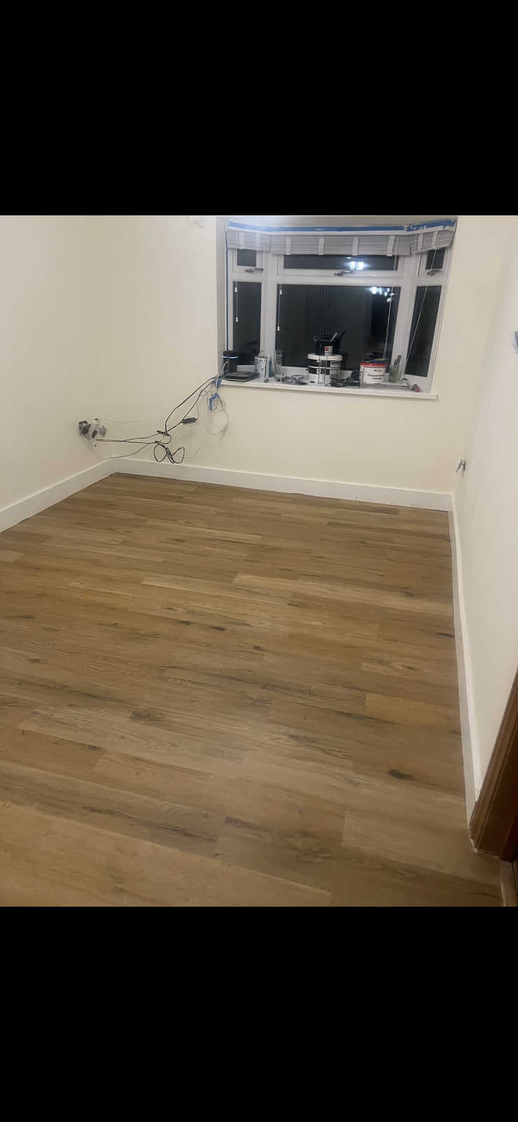

Managed to lay the flooring.
Karndean oak with Karndean pressure sensitive glue.
All knowledge obtained from this forum and YouTube.
Basic tools - Stanley knife, cheap notched spreader.
First time doing this, happy with the result and a lot of money saved.
Not perfect, but as a first time attempt, I wouldn’t expect it to be!
