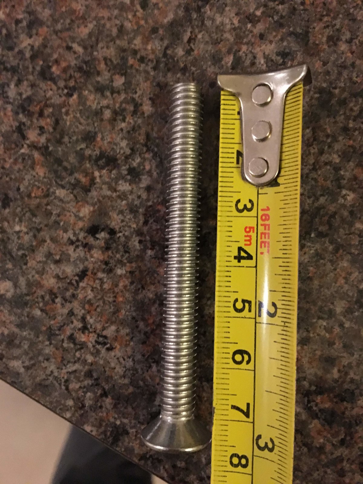

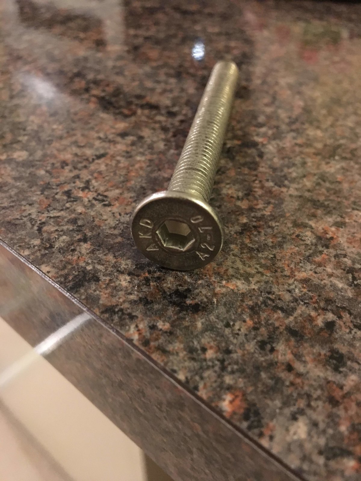

What is the bolt for exactly? Pic?
I got a door knob with a bolt but didn’t use it, I could post a pic of it next to a tape measure. Your welcome to that if it would help?
Mine fitted like this but I had to drill 8 holes in it.

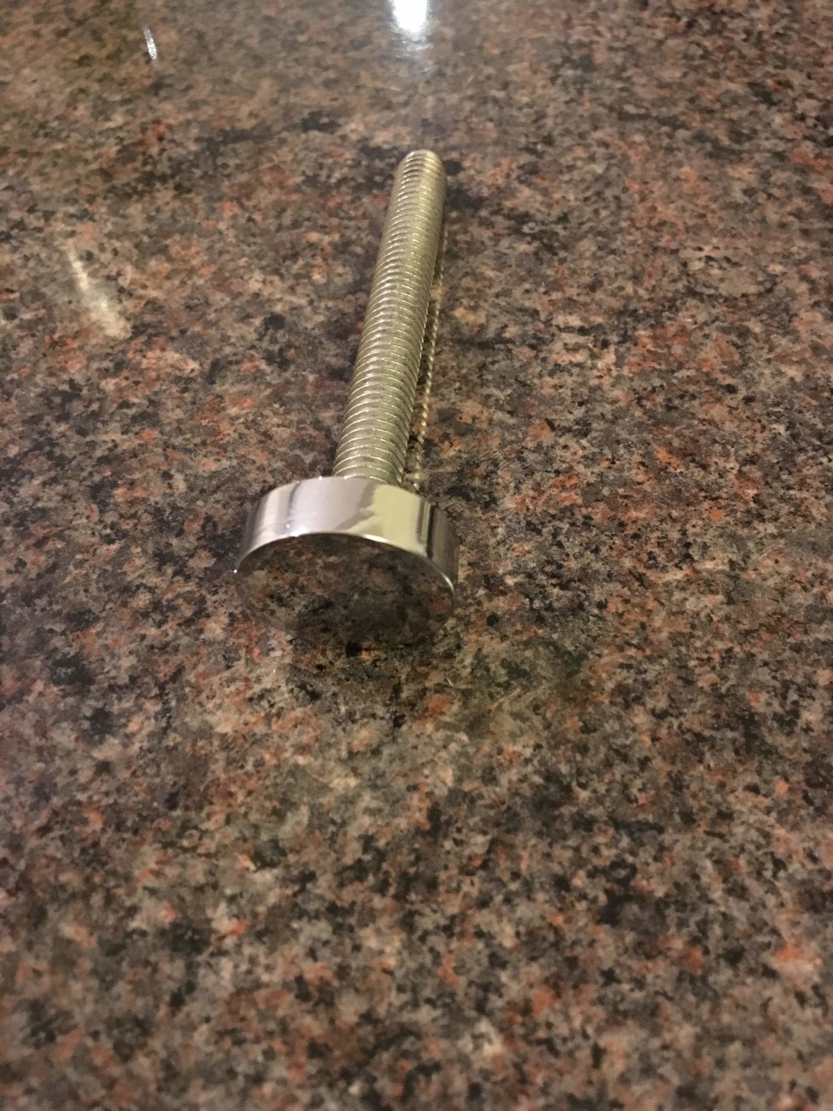

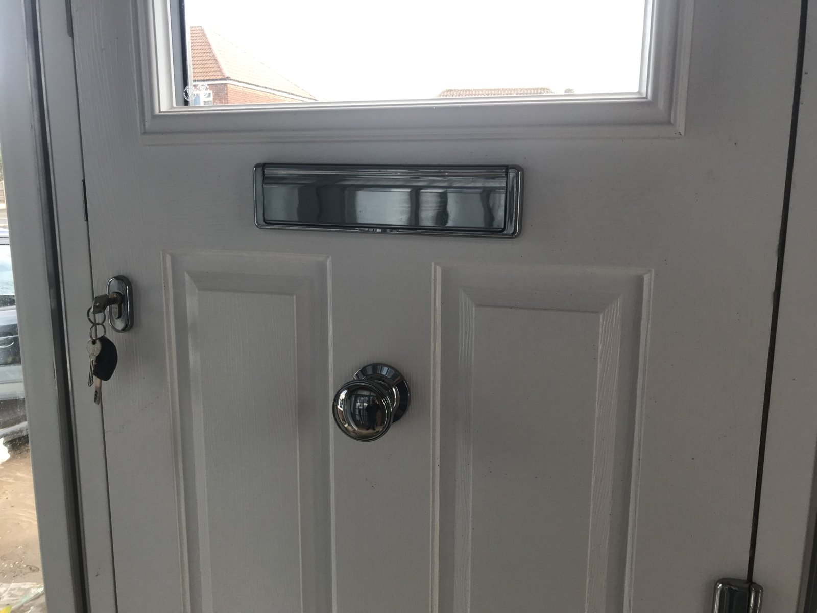

This is a pic of the bolt. The bolt goes through the front door from rear to secure a large door knob on the front. (Similar in look to Ian's, but with a different fixing). There is a decorative cap that covers the head.
Ach zo! Ze Whitworth thread has rounded crests whereas the Unified thread has flattened crests......anyone's guess!
John :)
Thanks. The manufacturer has confirmed it is a BSW 516.
So I now need to track down a 4" BSW 516 Countersunk bolt...
