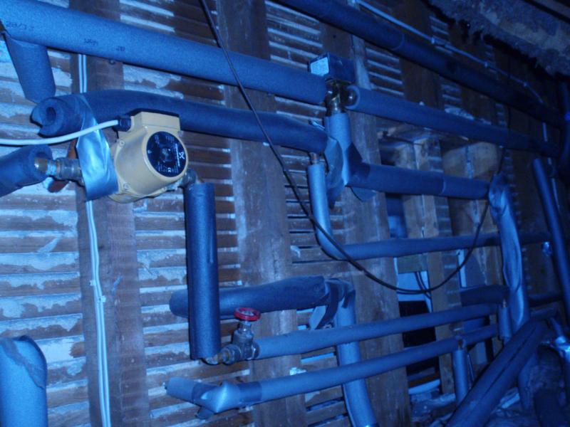

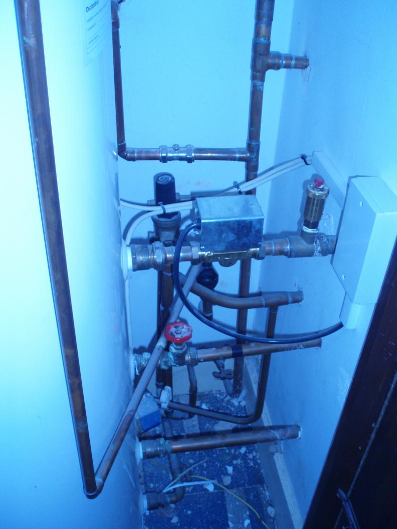

Lets have a few pics showing the valves etc around the cylinder.
other.
The two primary pipes go where. ??
Where does the how tee into them, there must be at least two motorized valves. :rolleyes:

I don't understand why there is a 3-port valve for a single zone CH and DHW when there is a 2-port valve on the DHW by the cylinder, unless it's left over from the previous installation (single 25kW non-condensing with vented indirect DHW).
