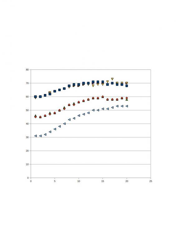

My theories about my broken heat exchangers:
1. it was broken by some warehouseman dropping a pallet.
2. the gate valve restriction in the header circuit allowed a lagging boiler pump to stall
I'm pretty sure I have the boilers working safely with the (now unrestricted) short 28mm primary circuit. Sure, it would be nice if they were efficient too, but I'd much rather they were reliable.
My OP was about trying to improve reliability with a filter. I don't seem to be getting a consensus on that. At the moment I like the look of the 28mm Fernox TF1, as it is both magnetic and cyclonic.

I measured several temperatures every minute after a room thermostat cycle for 20 minutes:
The bottom curve is the common return
The middle 2 curves are the boiler returns
The top 3 curves are the boiler and common flows
So at full power, the delta-T across both boilers is 15°C (higher than I thought). The transient delta-T from common return to common flow is about 30°C.
At the current heating load, the delta-T across the boilers is closer to 10°C while the delta-T between flow and return is about 17°C.
I can only see three curves. :?
The bottom curve is the common return from the radiators.
The middle curves are both boiler returns (they are similar and look like one)
The top curves are the boiler feeds and common feed (they are similar)

So you're loosing almost 50% of the flow through the gate valve.
Yes, at full power, there is twice as much flow through the boilers as through the radiators. So half the boiler flow goes through the gate valve and the other half goes through the radiators (a bit like a low loss header). If I close the gate valve, the delta-T across the boilers would try to rise to 30°C at full power, which is probably why they shut down.
