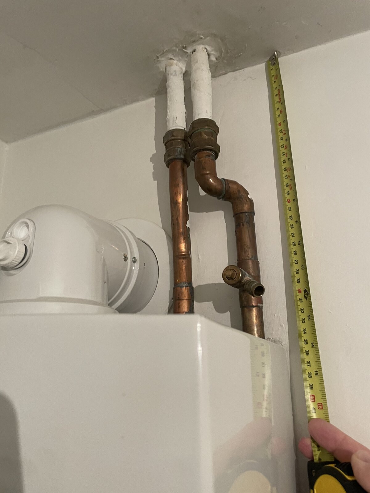

Hi all,
Looking to install a Magnaclean Pro 2 filter on my system, seems like a good idea with 10mm Microbore pipes!
Anyway before I pull the trigger I’m struggling to see where I could install it, I think I’ve ruled myself out DIY’ing this job now but would a plumber be able to fit it in the example below….

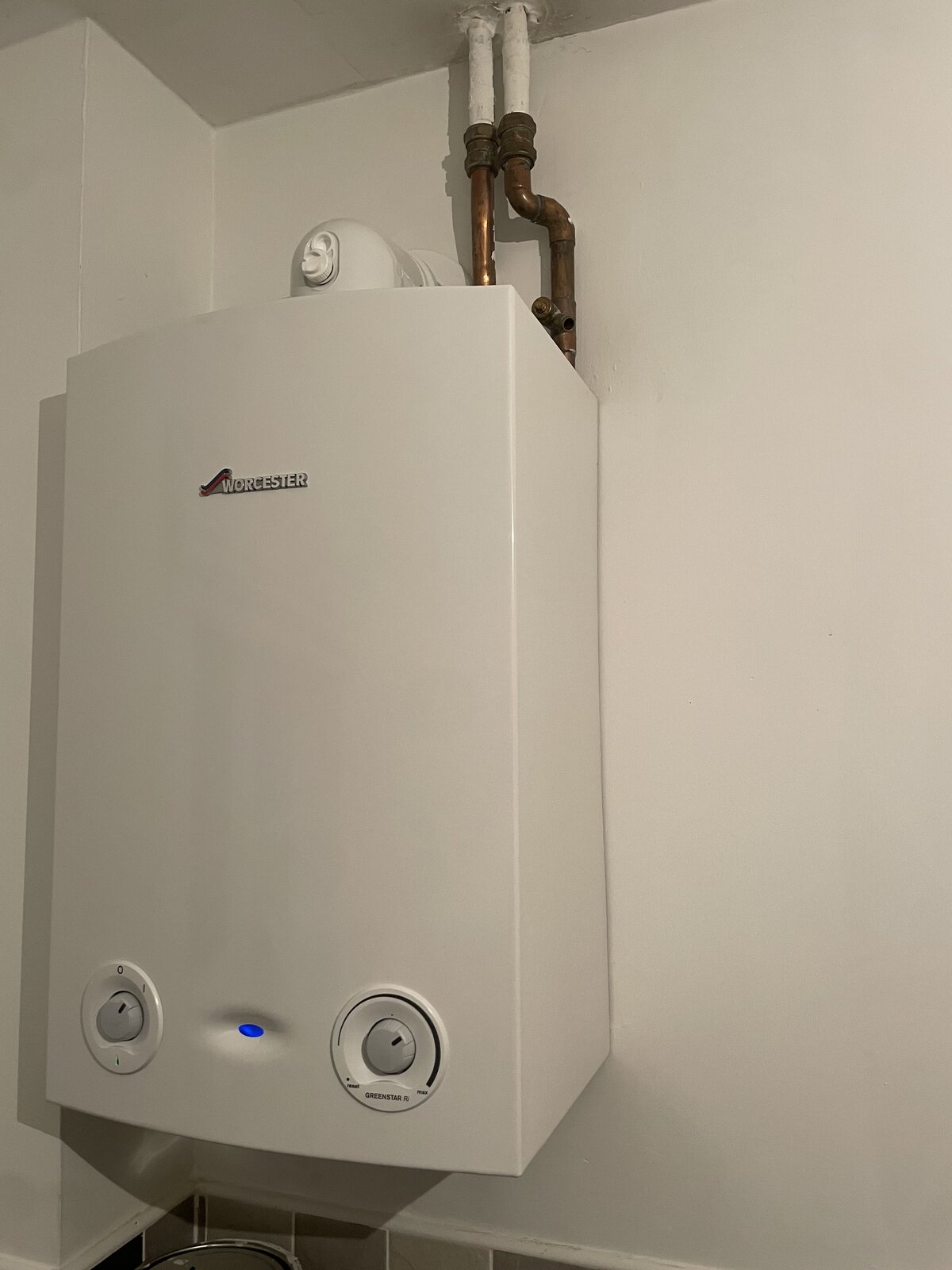

Above the boiler I’ve got not a lot of space on the return pipe to the roof (I believe the pipe on the right), it’s about 34cm but the pipe has a few bends as well rather than being straight.
Is there anyway to install it with some modifications or will there just not be room to service it easily?

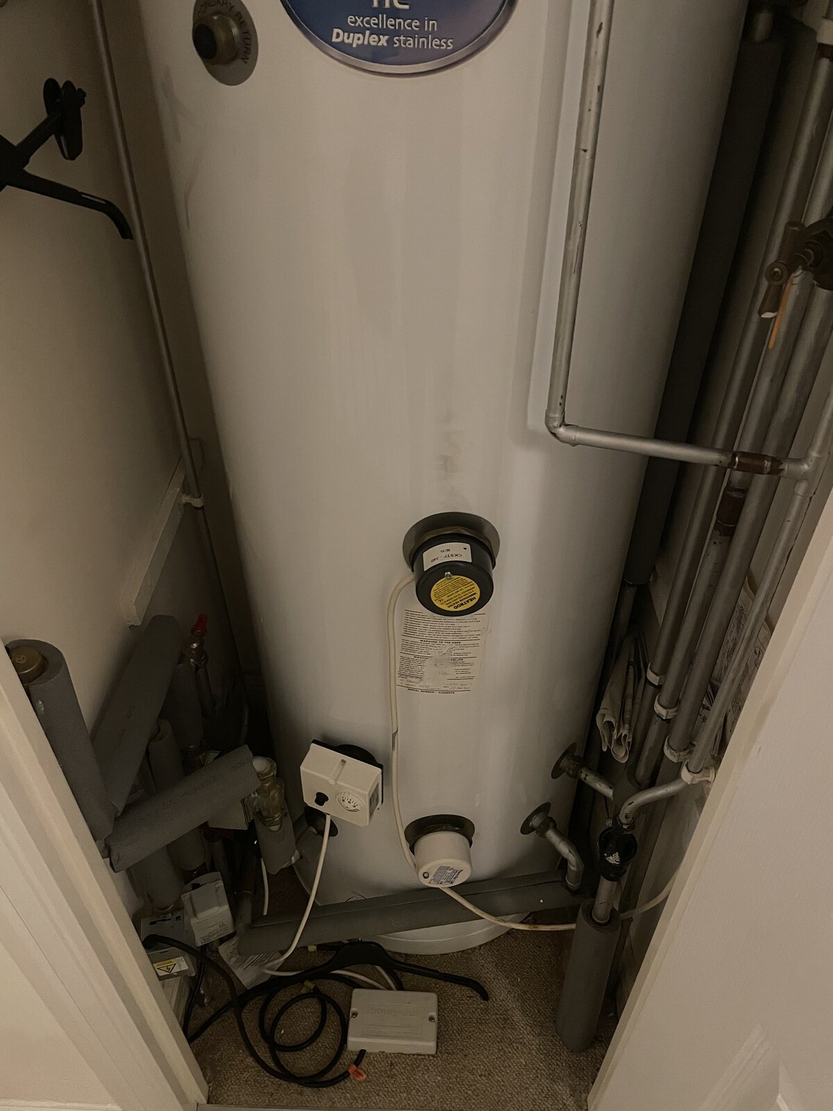

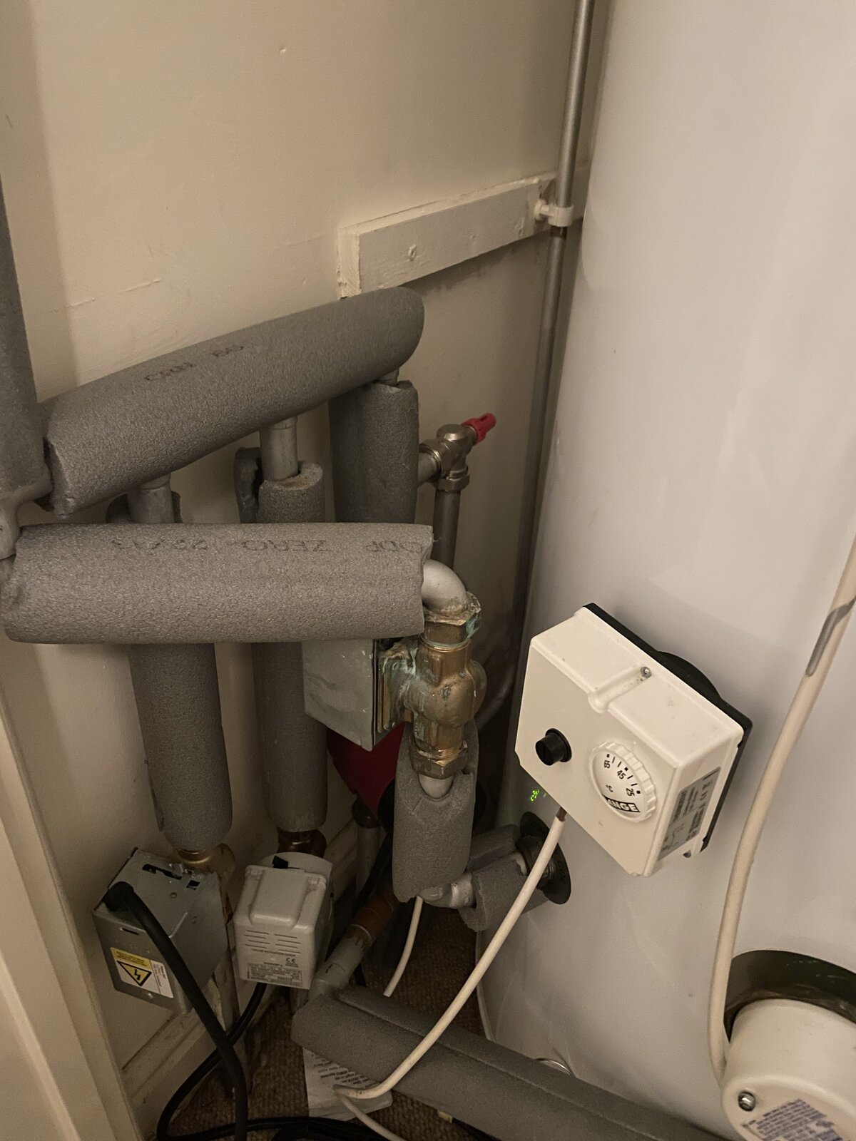

In the airing cupboard with the rest of the pipe work it doesn’t seem much better, not even sure the return pipe runs through here…
I could really do with a filter but is it going to be possible without putting it on a flow pipe which I don’t really want to do.

Yup .... around 50mm of a difference in the actual filter height but the pipe connections to the back are much tighter, so it's easier to install into tight pipework and still allow enough to play with.
Could you put a fresh piece of pipe in there - doing away with the compression fitting and maybe putting the bend either nearer to the ceiling or the boiler, leaving you with a longer section of straight pipe to work with?

Cheers all, yes I think all in all I'd rather stick with the Pro2 if I possibly can.
Yup I was thinking that might be the only way. Hopefully can find a plumber to do it, guess it's fairly straightforward for someone competant!

@AMW with a little fancy re-pipe there should be enough space to get a Pro to fit
