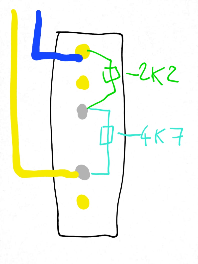

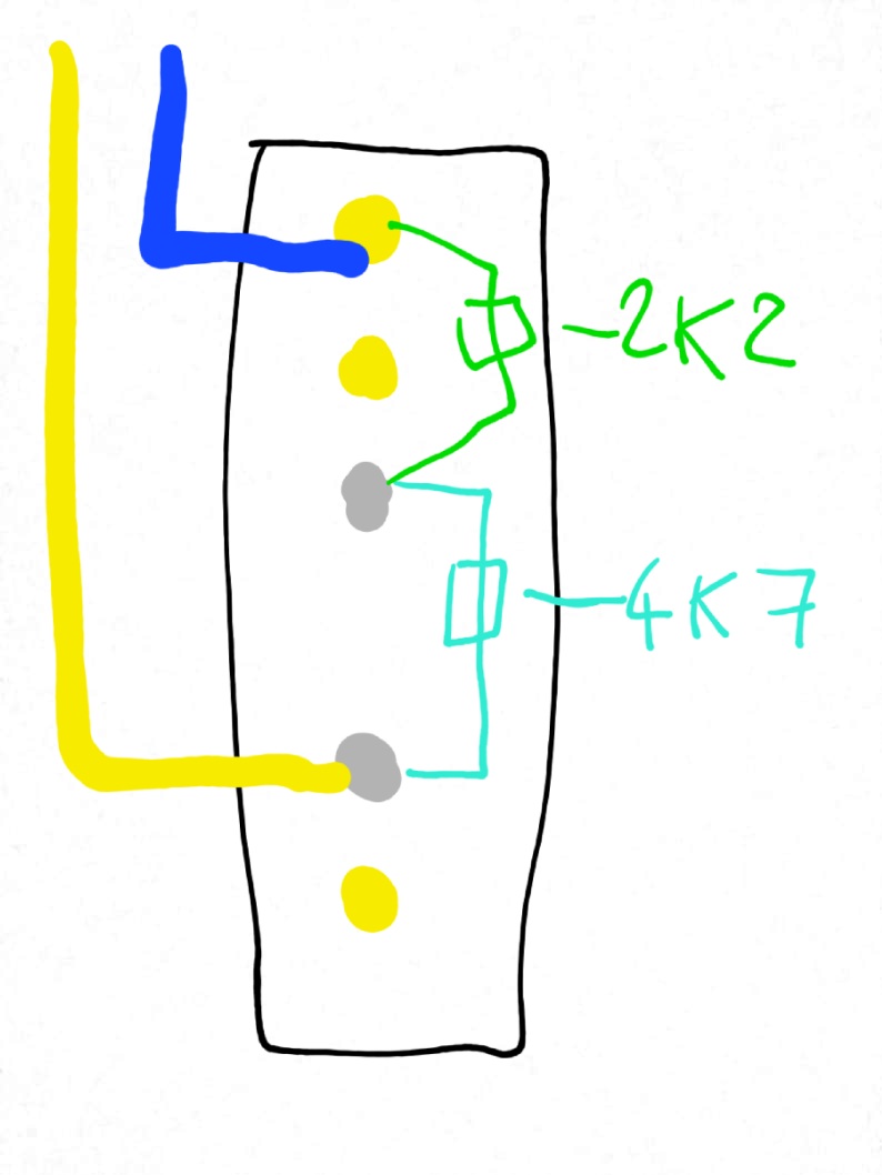

I am trying to wire a magnetic door contact with the pyronix euro V10 system.
I have these
Can someone advise on if they are okay, there seems to only be two connected terminals the rest spare, if it's okay can anyone advise on how to wire please?
Alarm pair go on the silver screws …tamper pair twisted together and under any of the brass screws
Although the drawing you did has confused me. The contact has gold, silver, gold, then silver, gold.
So not sure if I just follow the positions or the colours as the silvers seem to be connected together
Follownthe colours lol. My bad. The 2 silver terminals are the reed switch, the other 3 are just spare
Thanks will try in the morning. Ah okay the two silver terminals are connected to each other in the contact already, how does the 4k resistor work if they're already connected without the resistor inplace?
When the reed switch is open, the 4k7 resistor will be seen in the circuit. When the switch is closed it wont
