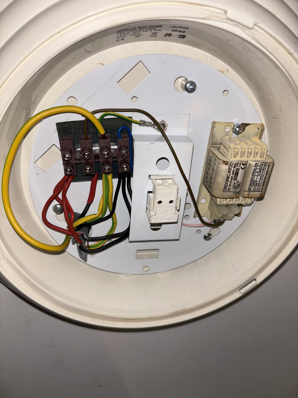

Hi, please can anyone tell me if I have a magnetic ballast or electric? Bulb I have bought only works with magnetic.
Many thanks

@Harry Bloomfield I’ve put an LED bulb in and now far too bright for a bathroom. It’s a rented property but thank you for the info.
As far as I remember you can different rated led replacement lamps ( 6, 12 and 18W ) for those fittings. If it is too bright you probably just need the lower rated one.

Not quite as simple. Note when buying replacement 2D lamps, some have 2 pins and some have 4 pin..
IIRC the The 4 pin LED 2D lamps use the electronic control gear whereas the 2 pin LED 2D lamps, like yours, use a magnetic control ballast.
The ballast is matched to the lamp wattage. The tridonic ballast in the photo states the lamp wattage.

It shouldn't cause a problem putting a lower wattage than she is using sucessfully, would it
