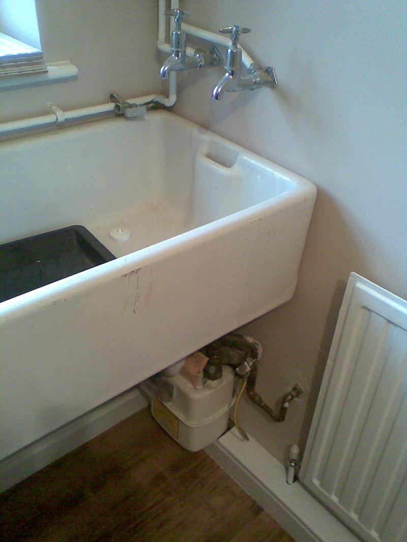

Came across this today at a friend's house.
It is the main bonding for the gas meter and all it is is a loop bonded to the water pipe at the sink.
There is no bonding at the water stop cock either.
This is as a result of a major extension done to the building and the electrical work was carried out by a registered NICEIC contractor who apparently did complete an EIC?
[/img]
NO not as far as I can see. There are two earth cables going into the CU but these look to be both supplementary cables.
The CU is situated in the garage and the gas meter backs onto the garage wall and there are certainly no earths coming through from there.
When I get a chance to speak to the owner (probably Saturday) I'll explain it to her then and she can decide what action she wants to take.
I'd be getting the contractor back in to rectify it properly. I take it that the contractor was meant to be a NICEIC domestic installer?
They don't appear to know the difference between main and supplementary bonding!
See if you can have a look at the certificate too.
Apparently the contractor is quite a big firm certainly not a domestic one.
I hope to be able to have a look at the certificate when I see her on Saturday. But my guess is she won't pursue them.
quote]
supps usually 4 or 6mm rarely 10mm mains bonds should be be min 10mm or ideally 16mm depends on the standard 16th or 17th and supply type
Agreed, the two cables going into the CU were 4mm, that's why I said they were for supplementary bonding.
Probably, from the old bathroom and new ensuite that was fitted.

They are too small for main bonding, that's why I'm assuming they are supplementaries going to the earth bar in the CU.
Also where the gas meter is fitted in the utility room against the garage wall the obvious route for the main bonding would be through the wall and along to the CU. Basically I would expect to see something similar from the water stop-cock, although it is in the kitchen but I would have expected to see it from the garage.
agreed but don't forget there was once a time when 4mm was the norm!
Yep, but if it is undersized for modern day requirements then before carrying out any electrical additions or alterations he should have upgraded it.
