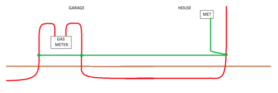

Anyway, if three are required then this would comply:
Possibly dependent on the locations of the parts - and discounting the SWA present in this thread.
True but my suggestion was assuming three main bonds were not necessary.
OK - but that is obviously the question under debate.
Anyway, if three are required then this would comply: <diagram> Possibly dependent on the locations of the parts - and discounting the SWA present in this thread.
Agreed. That's precisely what I was thinking of (IF one had 3 bonds).
Although the regs seem to require the 'silly' bond (the middle one in your diagram), I don't think there is anything in the regs which says that one "mustn't" have the sensible one (left one in your diagram) - so, as you say, presumably would comply.

Thanks Guys n Gals for your inputs on this.
This is what I am going (doing) to do:
10mm from MET to a earth block in the garage. then from the earth block: .1.to CU, .2nd to Gas riser, .3rd to Meter outlet to house, plus the gas pipe at the boiler all ready has 10mm to it .
