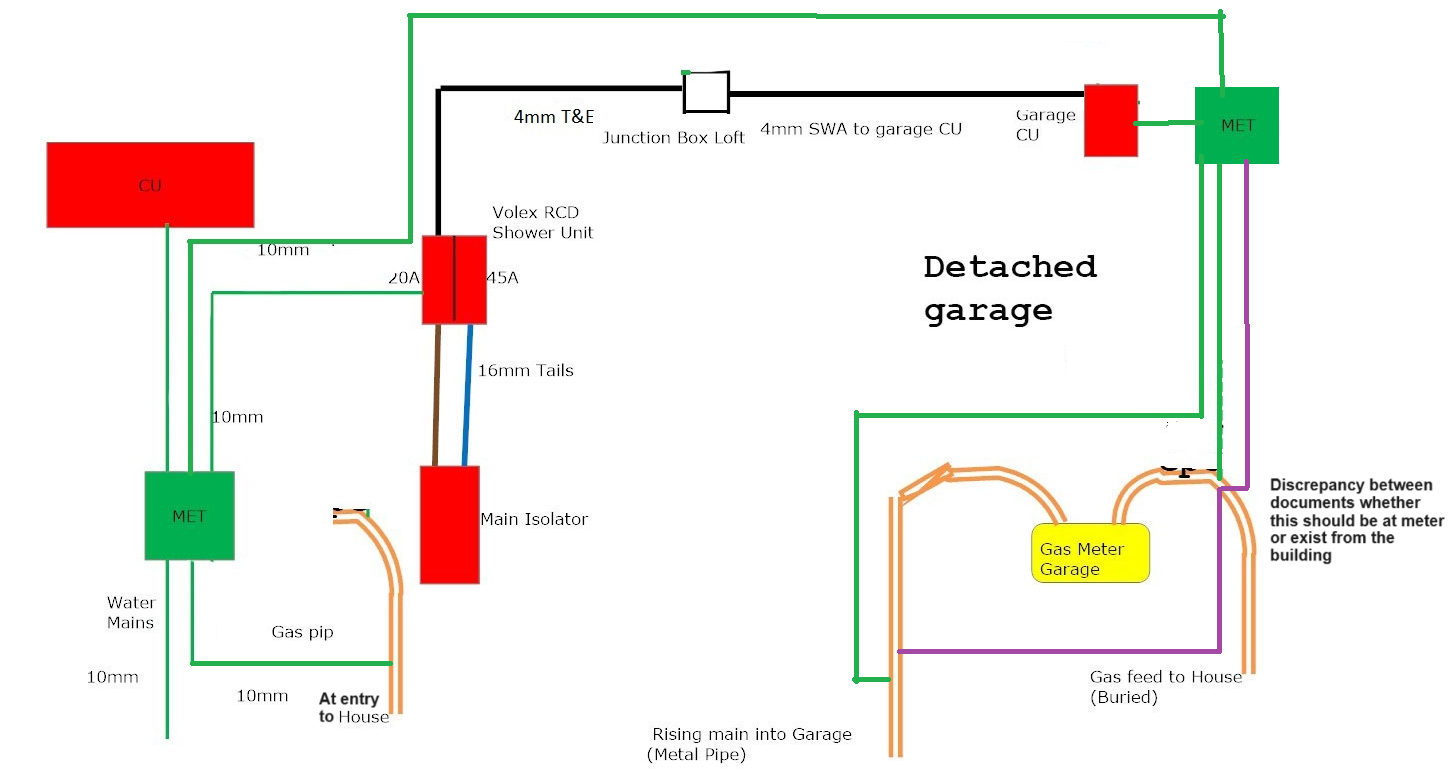

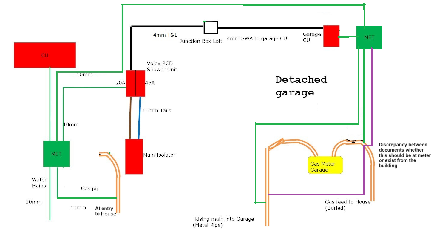

each building has to be treated as a zone in it's own right, therefore:
In the garage there is a MET bonded to the CU and extraneous metalwork
In the house there is a MET bonded to the CU and extraneous metalwork
The fact that the garage feeds gas to the house is irrelevant
The fact that the house feeds electricity to the garage is irrelevant
My interpretation of the various documents (and I don't claim to know every single detail) is:
In the garage I have shown 2 wires in green to the gas pipes and alternatively one wire in purple to both pipes as long as it is in one piece, this can be achieved by not cutting it or some other means of making the join between the 2 wires permanent ie by putting both wires into a single crimped connector or soldering/sweating.
Also it is permissable to use the CU earth bar as the MET if there are sufficient adequately sized terminations.
The earth from house to garage should be 10mm² due to the gas bonding. Ideally without a joint but not a necessity.

The only thing in question now, is where to fit the 10mm bonding to the gas pipe in the house, I can't fit a bond to the gas pipe has it enters the house, it comes in under the floor boards, so was asking now if bonding to the gas feed to the boiler will be ok !
There are differences between documents on this point,they all say as it enters the house but some duplicate the requirement at the meter, ie within 600mm and before the first tee, others say
as near as practicable to the point of entry of that part into the
premises.
So if the position at the boiler is the earliest practical position then so be it
But I thought that the 10mm bonding from the MET to the Meter had to be continuous, if I put in a earthing terminal before the meter it wil have broken the continuous run !
Yes it does have to be continuous, but it is to the MET in the same building, The link between the 2 METs is different rules
That is good then so will pull through a the 10mm from the MET to a earthing block in the garage, then 10mm to the CU, outlet pipe of gas meter, and the gas riser , job done !.
ps: The difficult part is attaching a bond to the riser, not sure how to go about doing that, would have to be some sort of heavy clamp that will dig into the steel pipework, just the normal SS steal straps wond do I suspect !
That is correct but if you are describing my sketches purple wire then yes a single wire as in the description or 2 seperate wires as in my sketches green wires.

Am doing the 2 green wires, and tks for making it clear, it was getting a bit messy :)
