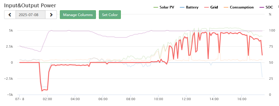

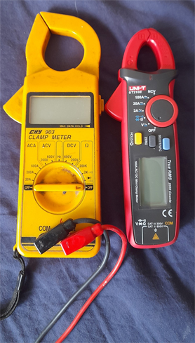

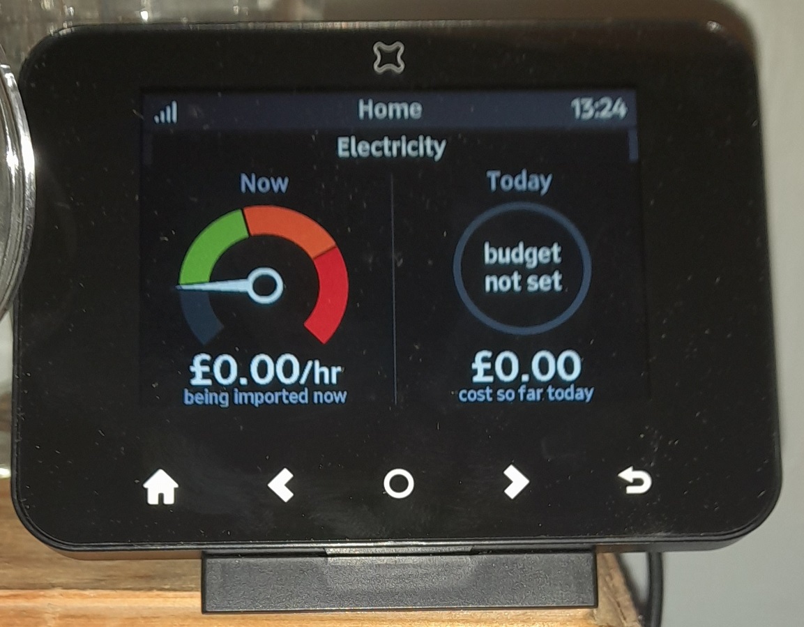

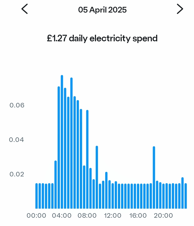

There is really nothing to add, except to test, an EICR has been done, but one does not know how well it was done. So what can one measure to give some pointers? Zero cost to user first, so IHD (in home display) part of the smart meter install, Importing 1.jpg it should give some clues as to what is using high power, the app on the phone, 1751993718935.png this may also give some pointers, one of my clamp-on meters does have a maximum setting, the old cheap yellow one, Clamp-meter-small.jpg and add items together, if I look at my house, with two instant showers, two cookers, surprised it has never ruptured the 60 amps fuse. I can see what I am using day to day, but only because I have solar panels, 1751994490980.png if something else used 1:30 am to 2 am it would be very easy to rupture the fuse, 60–16 = 44 amps, have a shower at same time, plus washing machine running, and there well over the 60 amps.
