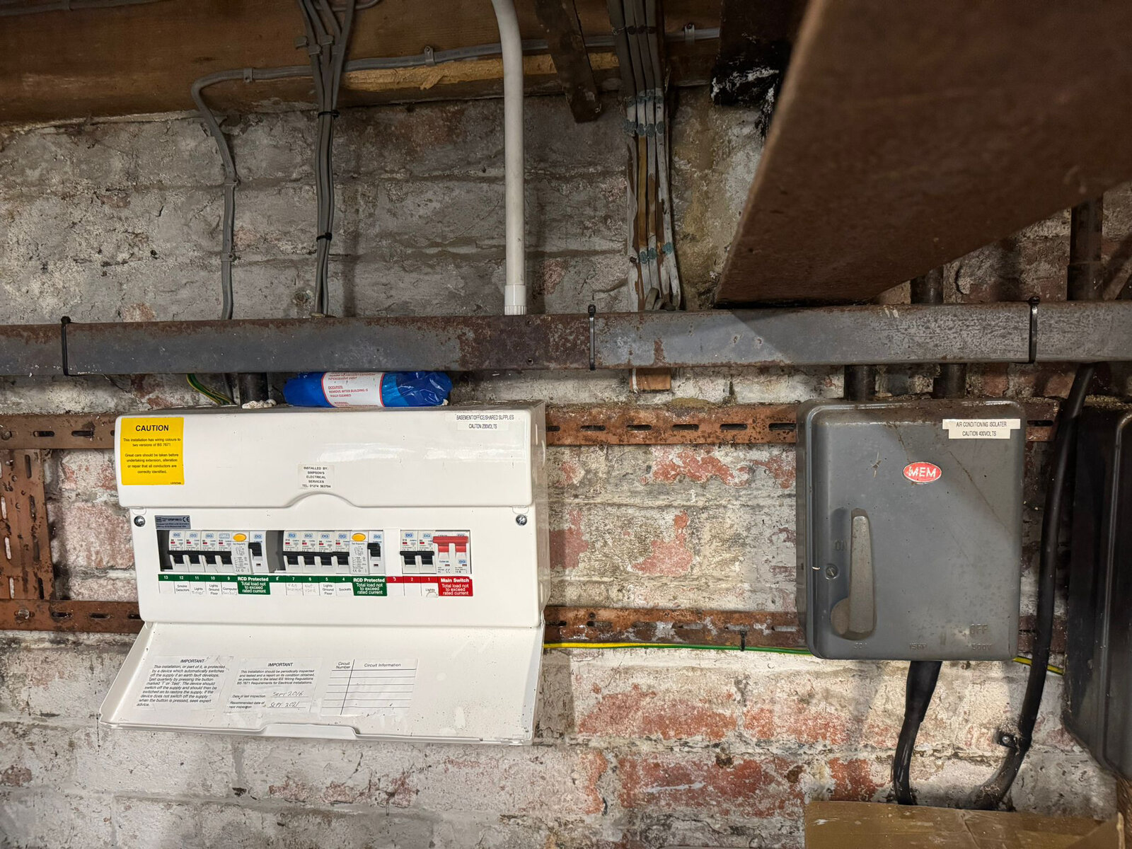

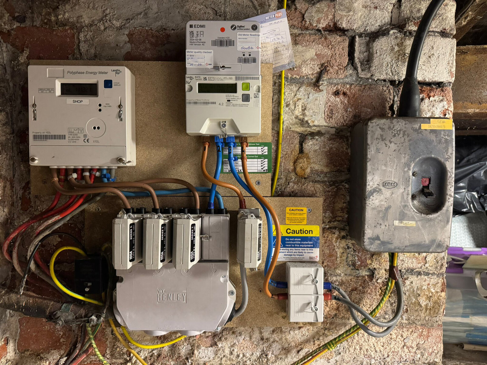

OK, photos! Some of the info I have given above may have been slightly incorrect, but I was only going by memory.
Location: Cellar

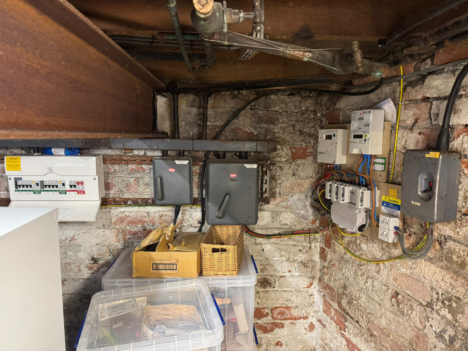

This is the overall set-up

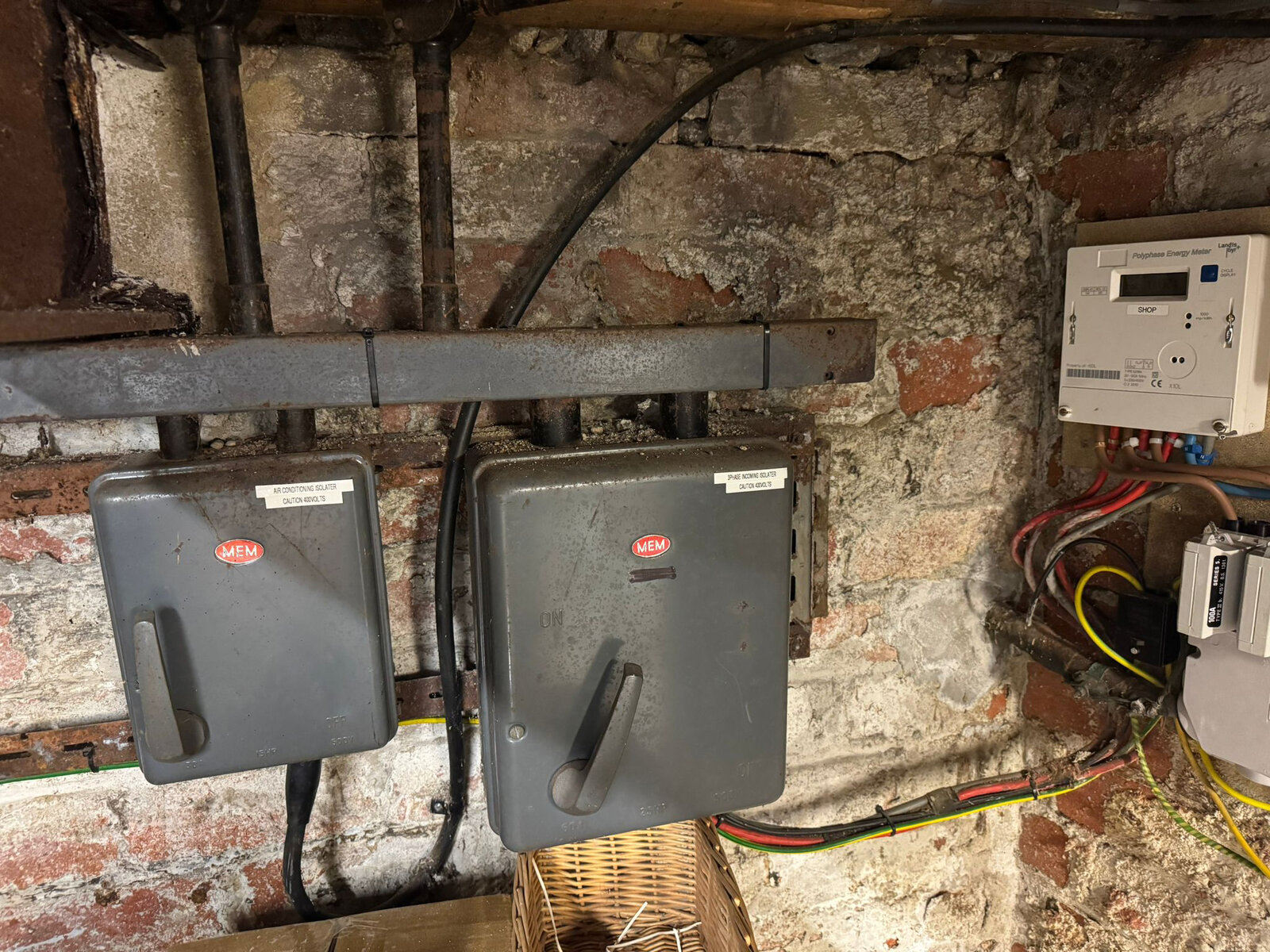

As you can see it has some historic commercial grade isolators from yesteryear. It used to be a 3 phase supply to the commercial property, but this was converted to become a single phase.
Some close-ups
So, the isolator to the right is for the flat, as is the right most fuse, with the meter just above. That is the fuse that blew. The large black cable from the isolating switch goes to the consumer unit in the flat.
The supply for the office is made up of those 3 fuses to the left and the meter to the left.

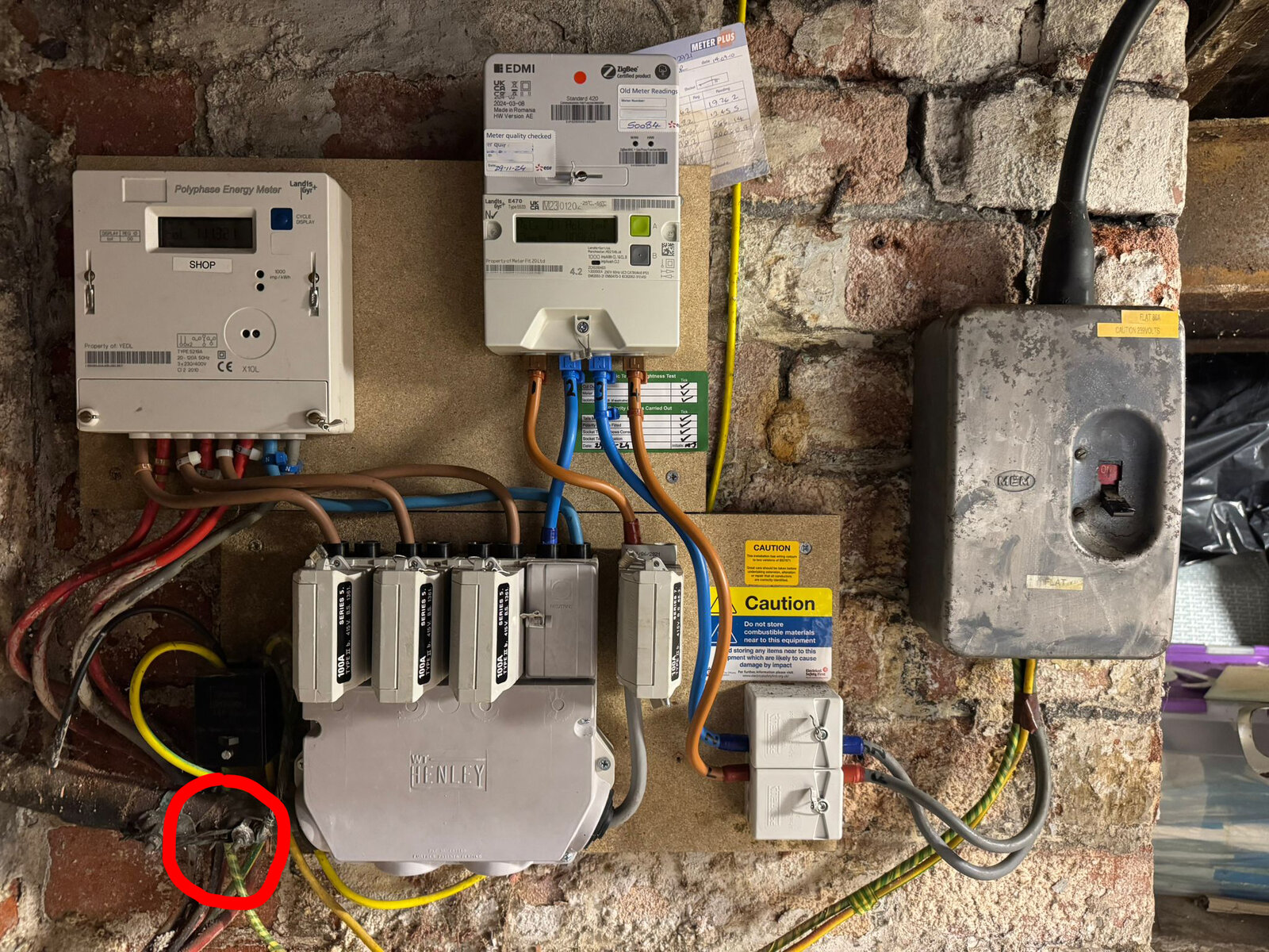

So, the network guy came and replaced the fuse in the right most enclosure, and when he flipped the isolator switch, there was a spark/arc and a wisp of smoke. Initially he thought the same fuse, or one of the other fuses had immediately blown. But it turned out they were all fine.
He then determined the spark had come from an earth connection here. Or somewhere in that area at least.
Now, some important context. The previous times these fuses have popped it has been on the commercial side. Two different fuses from the bank of three have popped in the past, at different times. This is over the period of maybe 3 to 4 years.
To the right of of all this stuff are the main isolator switches for the supply as a whole (I think).
and to the right of these the consumer unit for the commercial office.
The whole set-up was upgraded a lot in the recent past around when it was converted from triple to single phase. As you can see the back board is all in good condition.
The only other information I can think pertinent is that while the cellar is dry, it can have a fairly humid feel to it. How bad the humidity gets I can't say for sure, but that chipboard backboard has not degraded, so not damp i guess.
Thoughts on all that?
I appreciate any help or thoughts on areas to investigate.
There still appear to be three phase conductors leaving the "shop" meter and going to the big isolator, whether they go anywhere beyond that one can't tell from the pics.
I can't answer that I'm afraid.
All I know is that it used to be a three phase supply due to the previous commercial occupancy. But when the network realised it no longer needed that kind of supply, they converted it to a single phase supply. How that has been carried out I'm not sure but I always wondered why it still had all the visual appearance of a three phase.
As you say it looks like a normal 3ph supply to the large isolator, as plugwash says what happens after that is all guesswork but if the only service is that consumer unit then most likely only a single phase picked from that isolator.
There is no actual need to inform energy provider they are only using a single phase and my limited experience in the matter is there is no difference in cost for a 1 or 3ph supply or using 1 of the 3 phases.
However all of that aside, I doubt very much that any of that will affect the flat supply unless there is some link/fault between the services after they leave that area.
I can't see detail of that earthing arrangement but it does appear to look a bit green and due for an upgrade from it's appearence, especially if there was a crackle or spark there. That could point toward an earth fault in the flat side of things.
When was it last inspected?
ECIR was 5 months ago, and a lot of the components there got revamped and upgraded when it was switched from three phase to single. That was in the last 10 years or so. But it gets regularly inspected. Consumer unit for the office and the flat was all upgraded in the last 5 years I think.
Going back to what @flameport briefly mused.
With it being in a cellar, that can get a bit on the humid side, especially with the heat as of late. What are the chances of moisture shorting out the mains fuses?
This might explain why the supplies two separate supplies have had mains fuses going (see above in bold). Is the the only thing that could affect them both other than the supply side, an environmental factor? Or is there a common factor linking the office and flat in another way?
Unless there is anything else that looks out of ordinary and suspect from the images.
