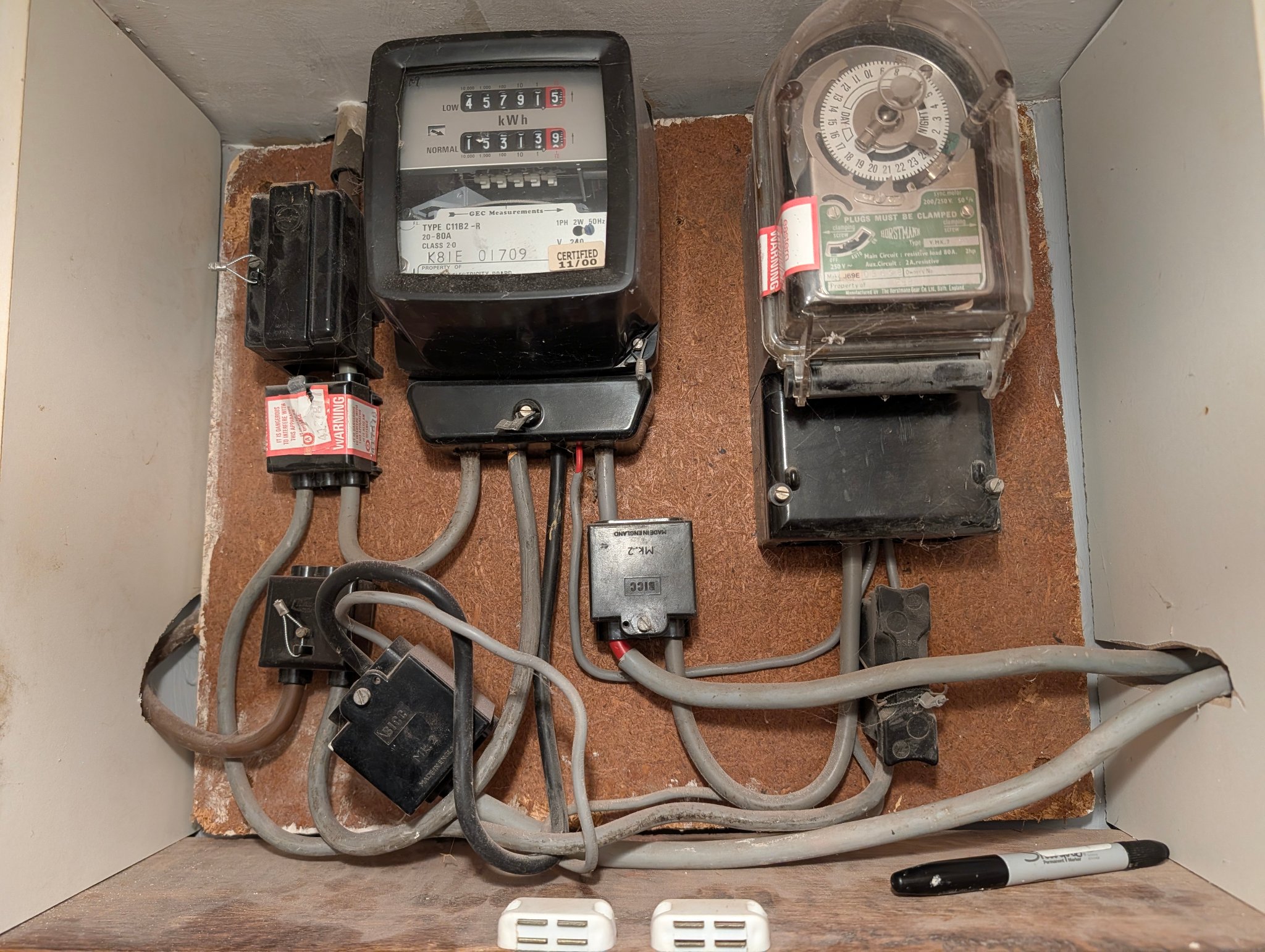

Hello, can anyone advise of the meter tails are they 16/25mm? A Sharpie pen for reference is included. also what is the fuse likely to be... It's a meter from 1969, but all electrics upgraded 1998. Thanks for any help
(I'm aiming to get 2kw solar and battery installed) but the DNO needs to know about the tails are done, there is no marking on the fuse box. but I need to get the meter changed too ...Perhaps someone helpful could advise which to do first... Dno/tails/meter/solar panel. Or Maybe just leave it as is for an easy life haha. Thanks

My gut feeling which has to be double checked on site is the 2 tails going out to the right are 25mm² and the rest are 16mm².
I have to emphasize that is in no way guaranteed on a remote diagnosis
