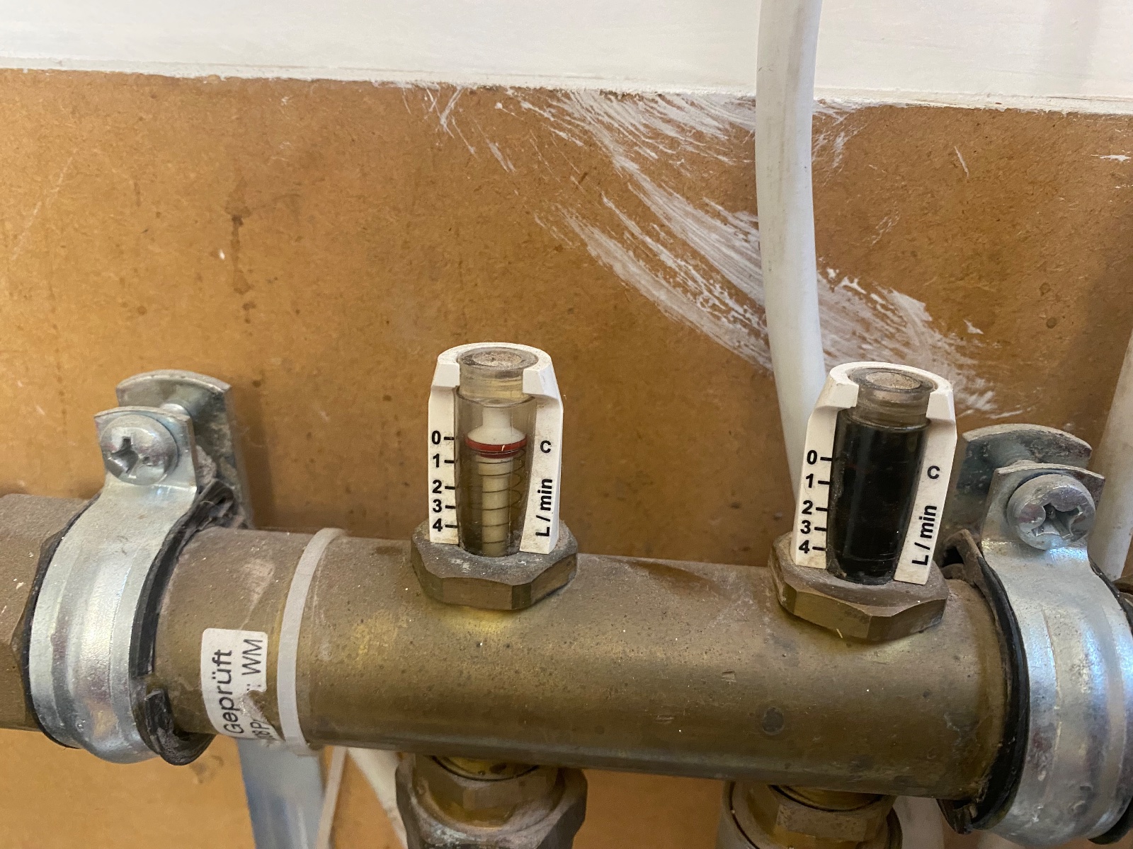

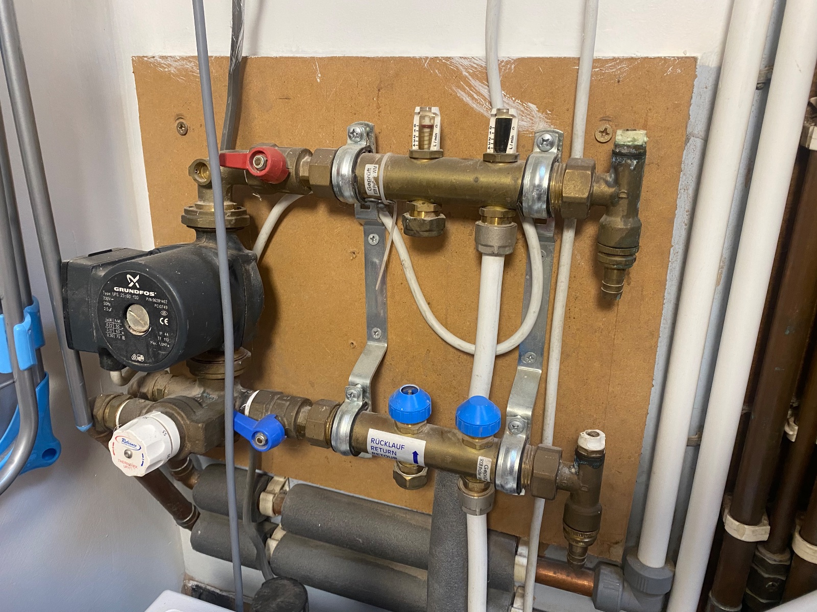

Well it has been ongoing for ages and in the summer when the heating is not on the pressure doesn't drop. We have no visible area of damp in the ceilings. The area we cannot tell is the UFH circuit in the kitchen. This is plastic pipe in concrete. Can this pipe leak ? It is about 18 yrs old as well.
I'm no ufh expert, but I'd say yes. Over the period you say it drops I can't see it being the main heat exchanger.
I suppose I do need to find out whether the UFH is leaking before I switch to a new boiler.

Personally, I would Isolate the boiler from cold first thing into the morning, leave it all day and open the valves back up. If the pressure has dropped before you open the valves the issue is at the boiler, if it drops after opening the valves then it's on the system
This is my UFH manifold. One of the flow indicators is very black.
