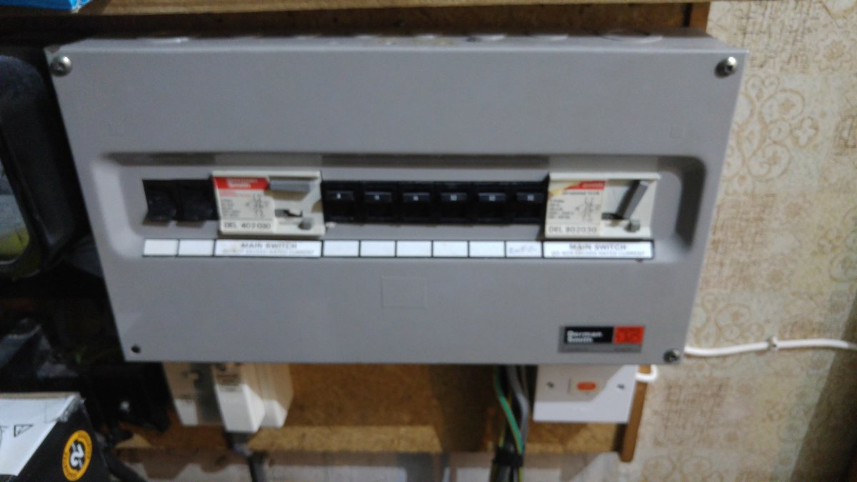

Hi all,
Wondering if anyone has any idea whats going on in my new (old) home. Basically I was using an angle grinder tonight and the main power for all the sockets, cooker etc went off and I thought that maybe just tripped or a fault with the grinder. Anyway went to check the CU and nothing had tripped but the main power with the test button had switched to the off position. Tried to turn it back on but i switched it on and it immediately switched back off.
I've double checked all the sockets I've changed and they seem fine. The socket the angle grinder was in was an original socket. I also had the fridge in this for a few days and it did the same thing but I could switch the main power back on no problem.
Am I going to have to get a electrician with an insulation tester or something? Or is there anything else I can try?
Pic attached of CU
Cheers!
John

Did you actually unplug the grinder or just switch it off? Given the fridge was also causing the RCD (I assume) to trip when using the same socket, aside from that (unplugging the grinder), all I'd suggest short of calling an electrician is, if you are competent, to (safely-with the power off) open up the suspect socket and see if there's an obvious problem (wire trapped by fixing screw, heat damage etc). RCD's are sensitive so it doesn't take a major fault to trip one. It would be better if you had more than one RCD for protection of all your socket circuits.

That CU is built too last, not like the crap built now. What is the single switch fuse under the CU serving ? If it's not connected directly to the meter it may be connected into the RCD,have you switched it off ?
I personally would not replace that CU,spend the money getting an electrican to find the fault.

I have no idea what it is feeding, you've put me off replace the CU now! I thought the newer ones would be up to today's standards? And this not?
You have two rcd's if they are 30ma trip and are operational why replace ? The enclosure us metal, that's 'the new standard' (y)
As has been advised get an electrician out to locate the fault and test the rcd's they will also advise you if the earthing of the property is satisfactory. You may require to increase the csa of the earth from 6mm to 10mm to comply with 'new standards'.

Per above, if replacing the CU, there's not much point getting another dual-rcd one, you'd be wanting individual RCBO's. Getting that in decent quality gear and proper testing is nigh on impossible for £250 for the 8 circuits it looks like you have (and that doesn't cover the fault repair)?. It could be a faulty RCD though and the old part might not be easy to obtain.
