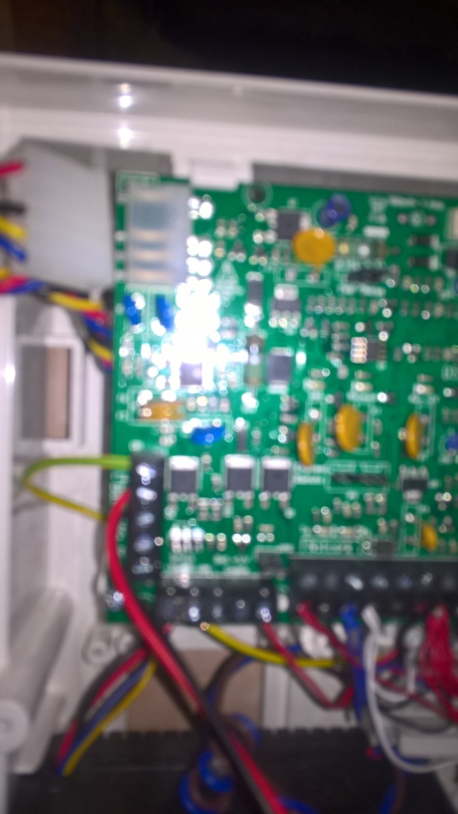

Hi,
Where and how do I connect the mains to this panel please?
I have got a FCU situated next to it and need to take a cable from here to the panel (was thinking 0.75mm round?) but at a loss as to where I connect this.
Excuse the image quality but this seems the obvious place but I don't have any cover for the right side of this connector which will mean that the cables are completely exposed. Am I missing some component?
Need to get this sorted as my battery has depleted during install...
To the Terminals coming out of the Black switch mode psu in the bottom left of the panel
There is a terminal block with a fuse holder next to the black power supply unit.

that's great. Got it. Thanks guys.
