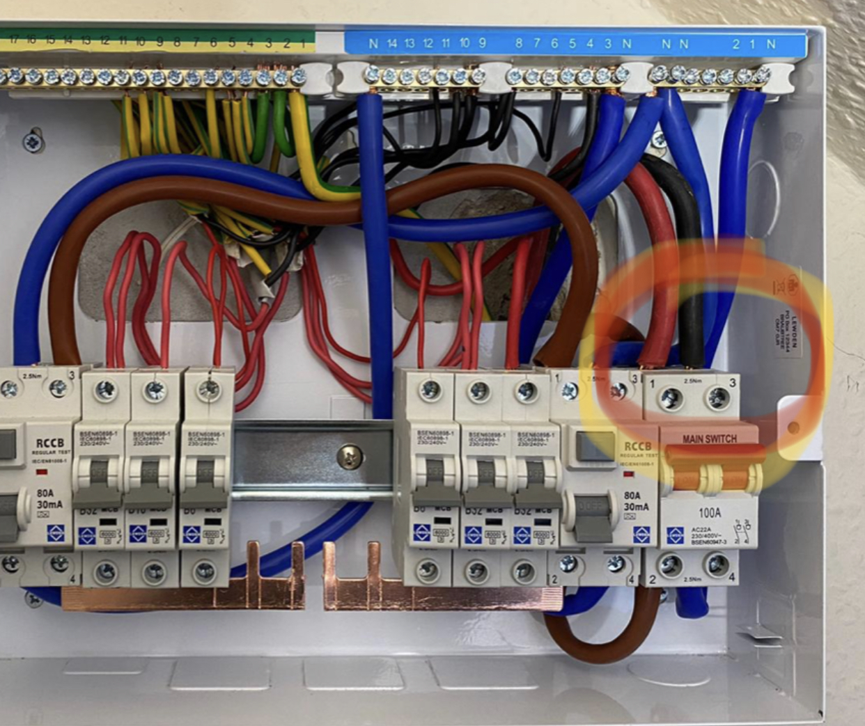

The white box housing the meter currently has a fuse which I understand - needs to be pulled by an authorised person - before electricity can be reenergised into house.
I would like an isolation switch in the white box which then means that there is no electricity (when set to off) coming into my Consumer Unit and I can safely work inside it for any maintenance that I want to do.
Do I request this from EDF (my supplier) or someone else and is there a plausible explanation which can get me this for free??
Thanks in advance.

UPDATE: EDF will replace this FoC and it will be done within the next 3 weeks. That’s what I have been informed.
Over the years and with immense support from many of you on this forum, I’ve done lots of electrical projects. I have grown in confidence and also enjoy this. Thanks again.
I’ve always stopped short of doing anything inside the Consumer Unit. Once this switch is in place, I am hoping to familiarise myself with this too.
Think I have this right…
Without this main isolation switch, once the main isolator on the CU is switched off (and safe isolation has been carried out), everywhere inside the Consumer Unit is dead apart from the incoming meter tails as show in this image I.e. it is safe to poke around everywhere else?
Once the additional isolator is installed and once safe isolation has been carried out, this will also be dead?
On safe isolation, can I replace the prove dead unit test with testing my 2 pole tester on a known circuit?
Thanks again
Can I please get your thoughts on my last post please?
I think I have this straight in my head but would appreciate your validation.
Thanks in advance.
Yes your post is correct. Only comment is that you will be unable to carry out the final stage of the safe isolation process (ie checking your voltage indicator still works) once you have isolated the incoming supply. As there will be no supply to test against. that is the purpose of a proving unit.
