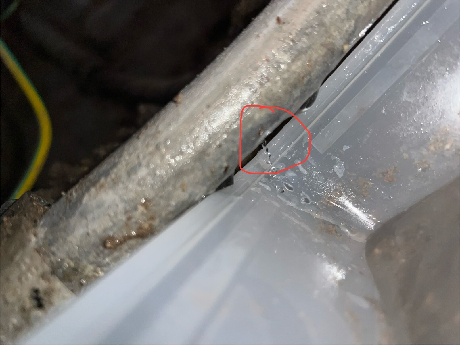

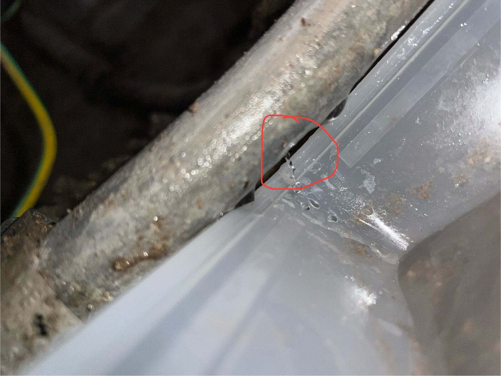

Mains water pipe leaking and I can't turn off stock cock--help!
Plumber has left saying he can't do a temporary fix because the water can't be fully stopped and that lead pipes aren't regulation so a temp fix isn't appropriate. Said we need to speak to Thames Water who can replace the stopcock and replace the lead pipe with a modern one.
Is that my only option or will some plumbers do a temp fix on lead pipes that are dripping a bit? Right now got no water

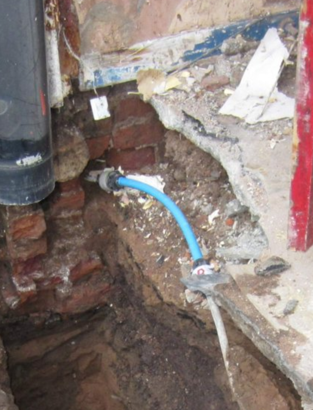

You need 2 x philmac UTC couplings and a bit of pipe (anything 15mm upwards - depends what you have). This will allow a permanent DIY repair while you address (save up for) replacement of the lead pipe.

thanks all for the advice. seems like the plumber couldn't be arsed! the leak seems to have fully stopped dripping now, so maybe it was just residual water. might complain to Aspect because i paid £150 for the privilege of being left in exactly the same situation
i've got another plumber coming tomorrow and now that the leak has fully stopped hopefully they can sort it
guy from Thames Water (who confirmed that the stopcock is working) reckons i should get as much of the lead pipe replaced as possible with polypipe, then get Thames to do the rest from their side to the stopcock
if the plumber tomorrow can't do it i'll have to take the diy approach!

If you have access (it need not follow the same route as the old one) you can probably go all the way to your internal stopcock, and then, in future, replace your internal pipework as convenient..
25mm poly would be good
A 25mm stopcock is more expensive, but IMO worth having. If your plumber will not have one with him, you can probably pick one up on a Sunday from Screwfix or somewhere.
When I replaced an old lead pipe with poly in my old mum's house, the water flow improved dramatically (it was half inch i.d. but I think probably squashed out of round over the years). About ten metres to the stopcock by the front gate. It makes a combi, or an unvented cylinder, better, and gives you chances of a decent shower.
Try to find out if your water co has a lead replacement scheme. They might give you free or subsidised connection. 25mm all the way to the meter would be best.

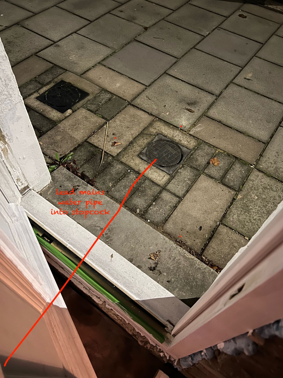

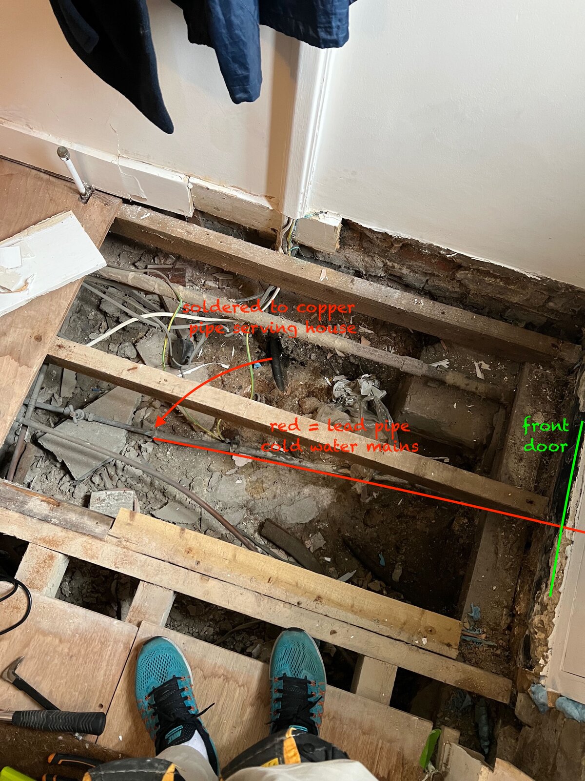

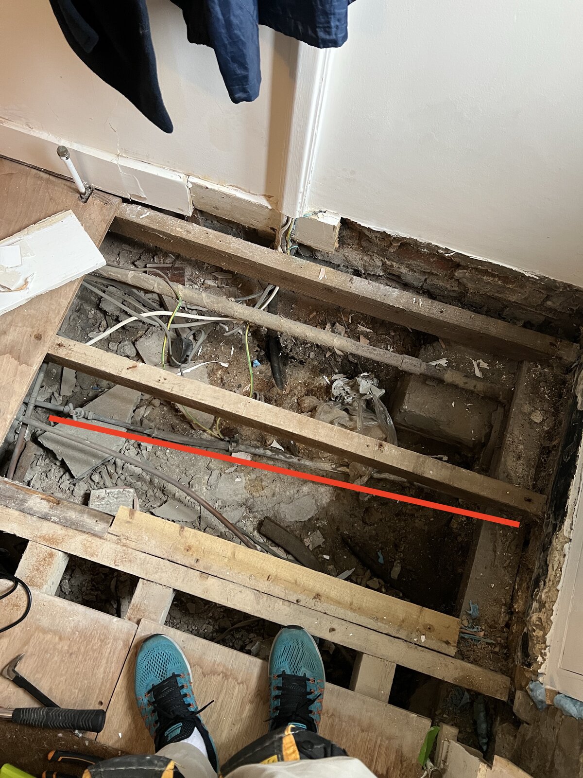

so we don't actually have an internal stop cock... only the one just outside the front door. i'm considering getting a stopcock installed just inside the front door, with a mat over a removable section of the subfloor to provide access to it
i'm with Thames Water and they do have a scheme but they require you to book an approved plumber to replace the lead piping inside the house, then they will break up the pavement etc to upgrade the pipe outside (it's literally less than a metre from my front door)
i've got some quotes of around 1k to replace the lead pipe and install the stopcock

so that's what i was doing when i must have inadvertenly knocked the old lead pipe to cause the leak! it was my original plan to clear it all out but i'm not sure what the point is? i've removed it around the perimeter and dwarf walls to promote airflow but didn't think removing all of it in the middle areas would make much difference?

the stopcock is literally outside our front door and the pipe going to it from my house is under pavement so i can't dig anything...
Thames Water have a lead pipe replacement scheme which means they'll do the bit outside the house but i have to get a Thames approved plumber to upgrade the pipe inside my house in order for them to do it. the 1k+ quotes are just to upgrade the lead pipe inside my house and install a stop cock (as well as a "check valve and drain off" but i don't know what that is)
