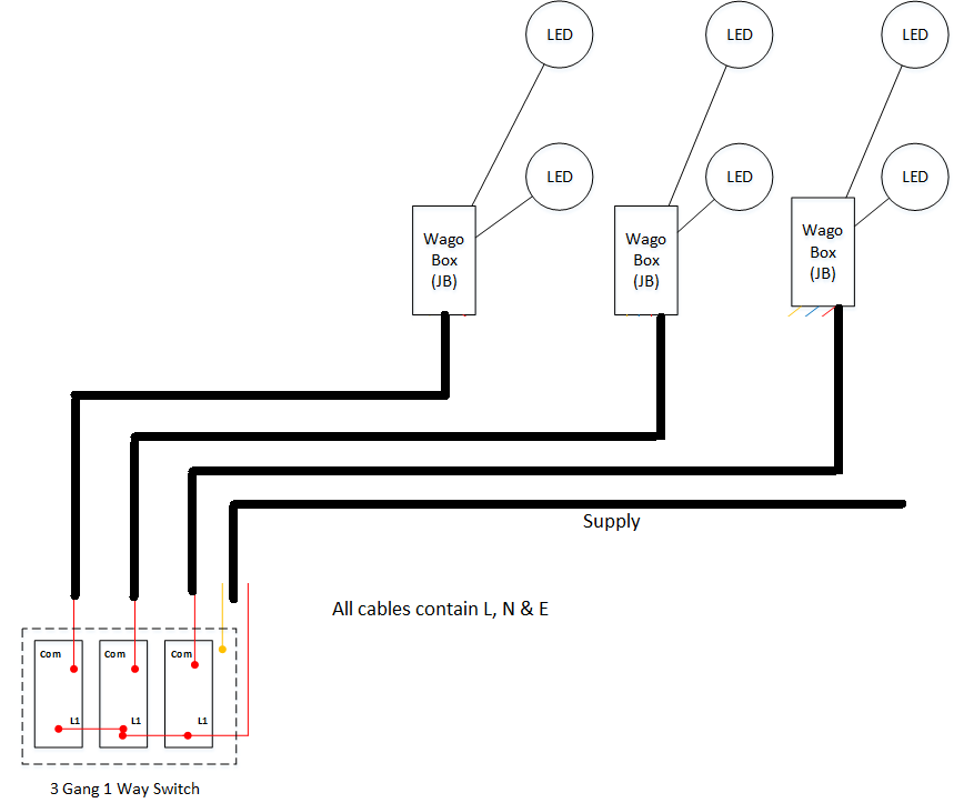

Not sure if I should start another thread, however I have added my wiring diagram and would appreciate if you/anybody could see any potential problems or concerns.
I have decided to use Wago JB using the specific connectors which are maintenance free. The 3 gang switch will have the live feed which will be looped between each gang (inner switch).
Ta.
That's fine, other than you will struggle to get that many cables in the first wago box. Not saying it's impossible, but there's a finite amount of room in a wagobox and that's a lot of cores to try and dress.
I count 15. I think the most I have ever used a wagobox for is 9 (3x3) I would recommend you think about using an adaptable box for the first box, and then wagoboxes for the joins on the LEDs.
Also, your switch may be wired wrong, but common is generally used for Permanent live and L1 for switched live.
I never really thought of that, the Wago comes in one size. Would there be anything you would recommend? Not really a fan of traditional JB as there are not maintenance free as I'm planning on laying floorboards.
I'll switch the wires around :)

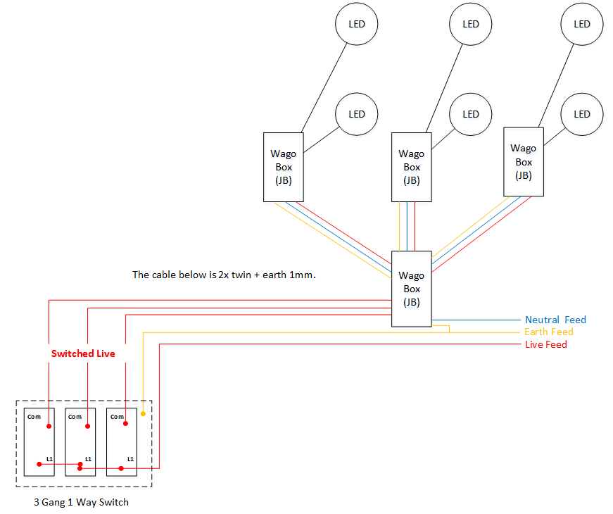

Your design works well. I should have mentioned, I have a limitation on the number of cables the trunking can handle. Four is the maximum with some slight movement. I've had to break away a freshly skimmed wall to remove the old trunking to install a thinner replacement. I have to pre-feed the cables in the trunking before it gets plastered over. Once installed, you won't be able to add any more cables through the trunking. The cable management itself needs to take four cables, two for each of the small living rooms, each with the circuit above.

I came home yesterday, only to find the cables already run and the wall plastered. Seems like I have only one option. I'm going to use your design for the bedrooms, much appreciated.
Do you see a problem from a electrician perspective on the design I put together? From the diagram the central Wago box would need 6x (twin + earth 1mm) cable. I cut up 6 pieces of cable and seems to fit OK in the Wago with some room for expansion.
