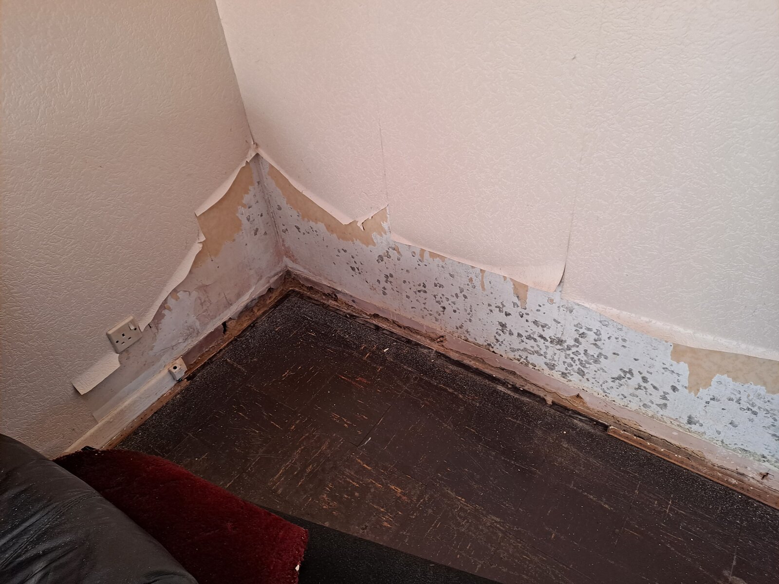

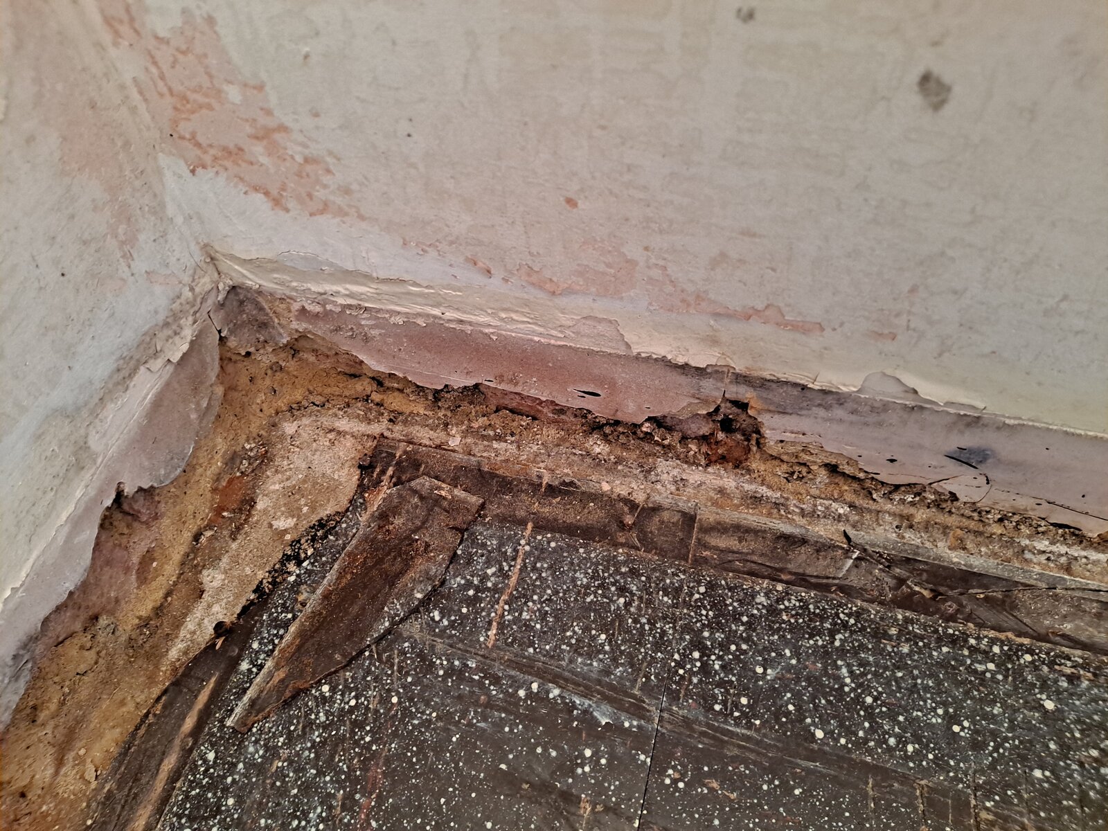

So I removed some of the skirting along this wall today, it was rotten in areas.
It appears to be a concrete floor with the tiles glued to it, so I'm confused by the air bricks outside now.
I'm a bit concerned with the fact the plaster goes all the way down to the concrete floor, I was always told this is a bad idea, is that correct?
It doesn't show very well in the pictures.
Also the damp inspection came out yesterday, he found damp in 3 areas of the house,
1. In the skirting in this corner (weirdly his damp meter didn't detect and damp on the actual wall, although we have had a dehumidifier on in the room).
2. By our back door in the kitchen.
3. On a small area of one of our internal walls (the area in question has our refrigerator the other side of it, so not sure if that could be the issue).
His said we have rising damp and recommends we have that silicone injection around the whole house, costing £3200.
