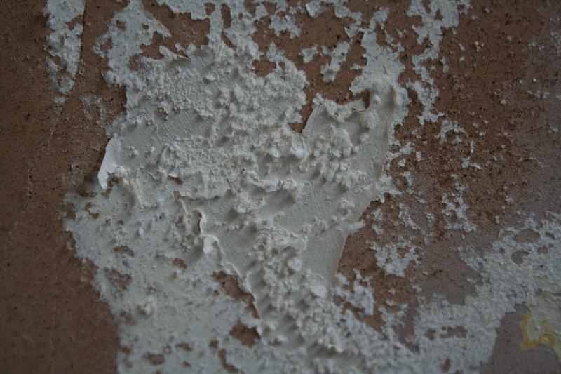

I hope someone can advise me. We've had a little damp problem in our living room for a few years now. It started with the paint blistering. I sanded it down, slapped on a bit of damp seal and painted over it. It seemed to do the trick for a while. It is an internal party wall and the patch is about 3.5' above the skirting.
It came back again so I repeated the same thing.
Well it's happened yet again. Only this time round, while sanding back I noticed that the problem was a little more extreme. I ended up pulling off loads of peeling paint to reveal a lovely big bald spot about 2' x 3' with patches of white causing the blistering. Salts I believe?
I brushed on the damp seal as usual but the blistering appeared again within a day and the coat of damp seal didn't bond properly and just peeled off in one big sheet and felt like a deflated baloon :?
Here is the patch:
You can see were I painted on the damp seal (The yellow is the previous wall colour).
And here is a close up of the salts bubbling up to the surface:
Is this going to be a major re-plastering job, or is there something I can use to stabilise the salts so we can just sand it and paint it?
Obviously we'd like to sort out the damp properly, but funds are a little scarce at the moment :roll:
One of the worst things for pulling salts/efflorescence out of old brickwork/walls is gypsum plaster, which is what i would say is on your wall. Most people on here would advise removing the old plaster back to the brickwork, clean/brush it down to remove dust etc, then scratch coat the wall with a 3 or 4 to 1, sand and cement scratch coat with a waterproofer in the mix. This scratch coat will stop the salts etc from coming through. Let the scratch coat set and cure for a couple of days, then you can either render top coat the wall and then finish it with a finishing plaster,(multi finish), or,,, you can plaster the wall on top of the scratch coat, with bonding coat or hardwall undercoat plaster, and again finish it with multi finish. Another important thing to make sure of, is that any ongoing damp problem is rectified before you re-plaster. You said it was an internal party wall that is the problem,, was there ever an old fireplace located in that position in the past??? Painting on a sealer will not cure the problem at all Amanda,, but see what the other guys on here have to say about it too.

That's a serious amount of damp and you need to find the source. Leaky pipe under the floor? Guttering overflowing outside? Take a look at it from your neighbours house - do they have a problem too?

You never know, if it's a plumbing problem on their side, they may have to get a spread in and for the additional extra, may get your patch sorted too for you. The repair you'd need isn't massive. The section could be cut back and repaired and depending on size of the wall, reskim the wall or blend in.
do you have a down pipe round that area (outside) it could be leaking and constantly soaking the brickwork which is drawing it in or it could be split under the ground and soaking the ground and again the house is drawing it up.
proberly best to have it off find the source of the damp and waterproof render it and re skim. or you could use thistle lime lite or dricoat.
