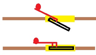

I bought a custom made loft hatch. It's made of metal and insulation. A great fit, well insulated too. But, much heavier than I thought it would be. A bit treacherous when opening it, and also a bit iffy when closing too. And it will only get harder as I get older....
Any suggestions on how to make it open slow? I did see these, that might work if I can safely attach into the metal door, but these are a bit expensive. I have contacted the company I bought from to see if they have anything, but can't seen anything on their site.
A counter balance might solve the problem.
Add the red bits to form a counter ballance.
Maybe, but it might stick up in the way when open? I guess not a problem with the size of the hatch... Actually, it will have to be right on the side or it will get in way of ladder.
